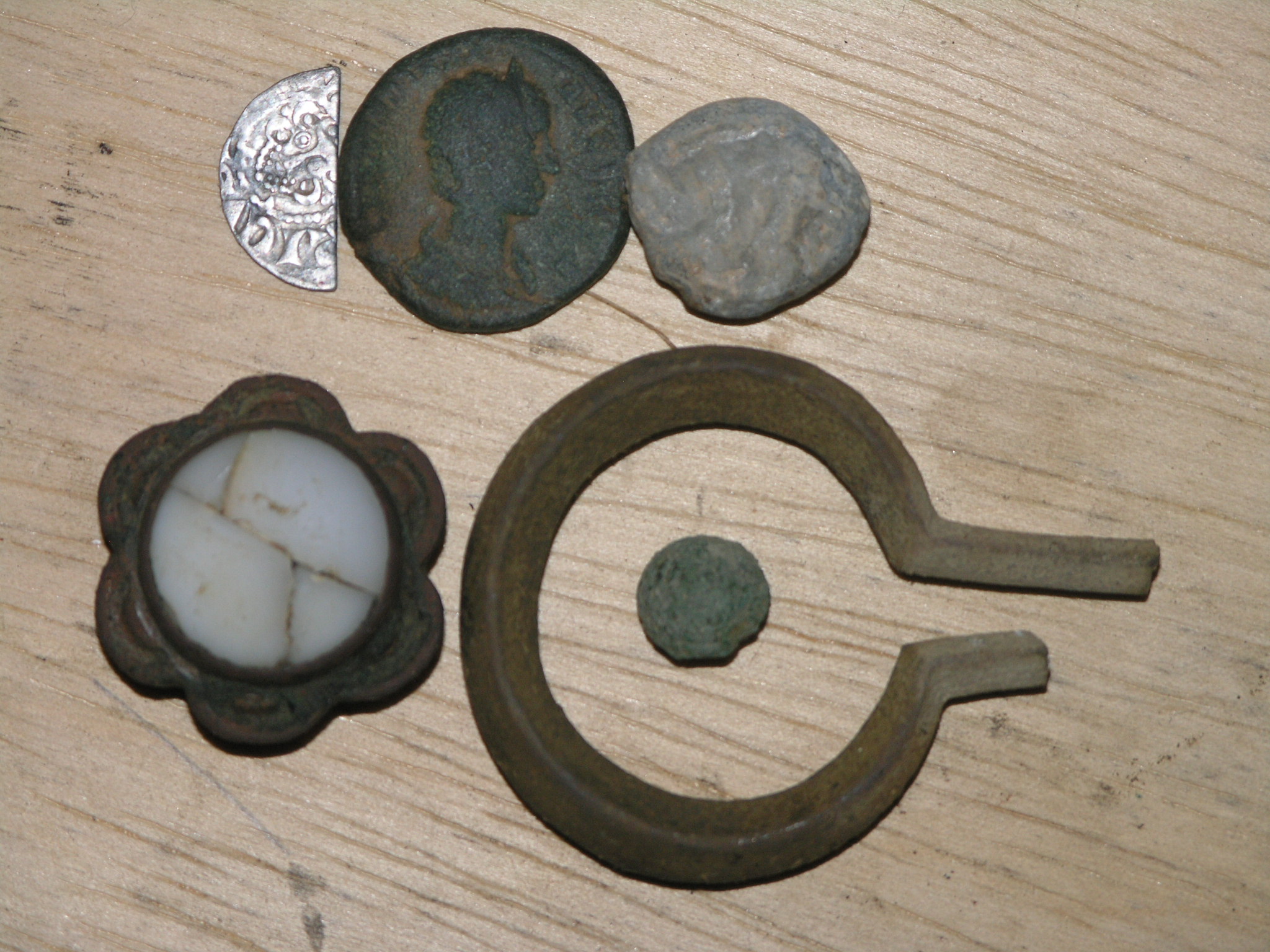

              Yes detector works very well. Just been out with it last weekend. Iron and coke infested site. Minelab Sovereigns did not work well on it. I managed a nice cut half Henry II, Roman, Jew's harp and a Celtic potin.
              Discrimination is just about perfect. Large iron fools it a bit but there are a few tricks to sort that out.The right headphones help. The grunt from some large iron is more defined in some than others. If it a loud signal lift the coil off the ground if the signal suddenly disappears its iron a good target will gradually fade. Deep large iron will only give a signal one way. Ether left to right or up and down but not both. The only iron I tend to dig is anything with a hole in the center.

              • sounds like your having some real success there. Its rewading to find something nice with your own kit isnt it.
                Any pics of these bits? Whats a potin?
                  Potin was a kinda money before money. Everyone in the same area use to exchange goods for token. You could say change your fish for a token then use you token to exchange for cloth. Unlike lead tokens when money was around where each token was a very small fraction of a penny.
                  • here you go

                    Bit of inspiration for people building this.
                    Using a 8" coil is roughly on a par with a Deuc with a 9" coil except no target ID. If I find a iffy signal in the ground and ask someone with a Deuc and 9" to check it they also get an iffy signal.
                    10" homemade DD is roughly twice the depth in air over the 8" on a 1918 sixpence.
                    only problem I have with the 10" is my shielding. Tried many way but all give false signals not bad but enough to be annoying factory coil rock steady.
