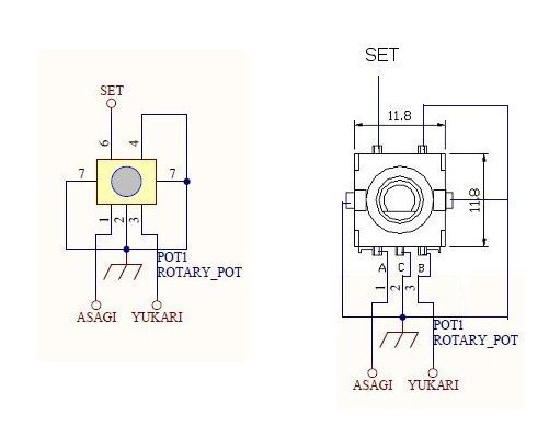

      • elbombaci
        is this the correct way to wire the encoder
        just comparing the drawing with the physical encoder picture
        tag #7 looks like the tags on the body
        • Hi 6666,
          It is true.
