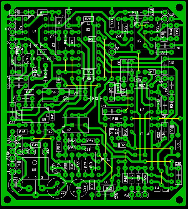

      • Stuck! Heeeelp!
        Stuck. Soldered all the parts. Each IC is in place. The head is in place. Power on. High frequency noise coming from the speaker. The Darlington transistor is heating up. The electronics are not detected.
        I think it should stay szakmámnál (anesthesiologists). :-)
        Unfortunately, the meter did not bring with me, so I can not weigh out what is wrong. :-(

                        Thank You!
                        The PCB is faulty. The original transistor BCE, but the MPSA EBC. Also changed a bit, beenelem the image here. I know this is not the original PCB, but unfortunately I could in this residue. The dealer got me BC879. This is absolutely not good. I need MPSA13, 14 or BC517!
                        Christ is risen!

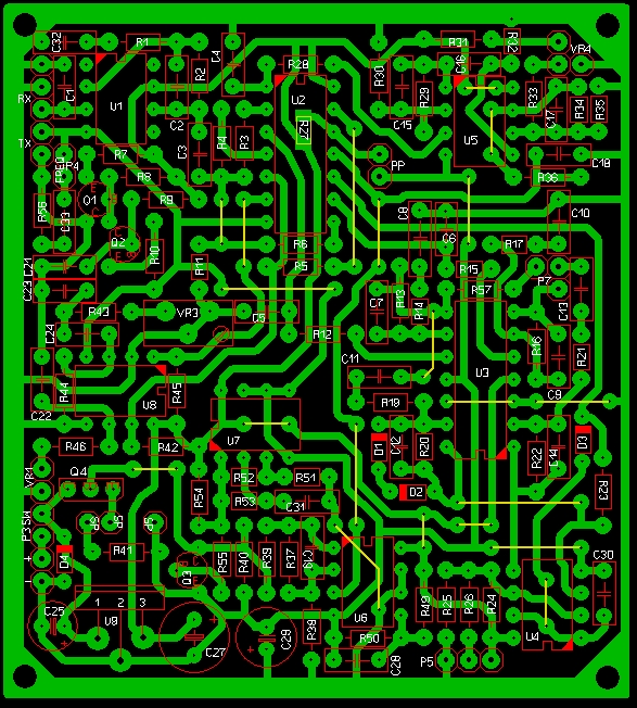

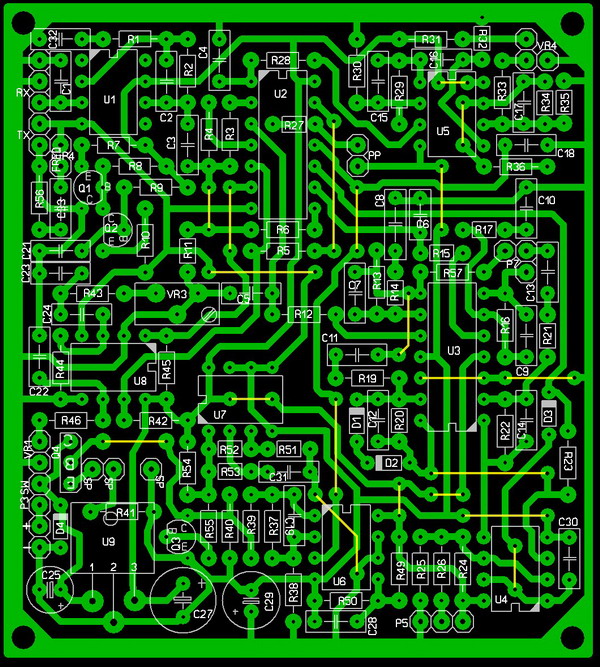

                        • These PCB's. The transistor is vice versa. The legs good order. I'm sorry!
                          • Originally posted by szucs_g View Post
                            Voilá the modified PCB:
