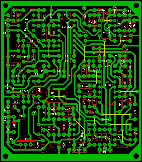

IDX-PRO+VDI
  • This is the version I supply pcb's from
    • silverdog. Do you have that as a .lay or eagle file? P.S. I did buy a pcb from you. I wanted to see if I can route one with my cnc too. Thanks
      • Originally posted by juice2839 View Post
        Previous posts in pcb is attached.
        • IDX-PRO+VDI. COMPLETE
          FOR ALL.

                            I noticed the layout of the PCB IDX PRO that the general area of GND tracks are small (and of VCC too) the ground plane have the same width (or near) as those lines that carry signals.
                            I changed the dimensions of these tracks on my board because I consider a interestingly change the GND lines (which are a very important reference zone relating to all the other circuit) so need to be in a larger area and with that prevent some losses due to this electrial weak zone a flow through part of signals ...
