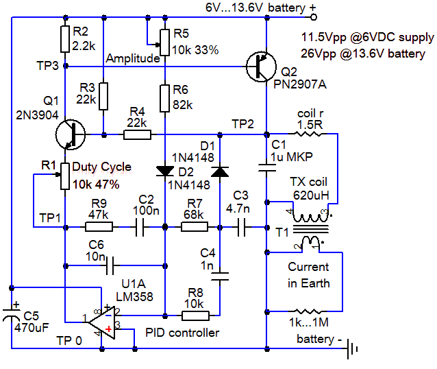

                      • REDESIGNED TX
                        This posting is continuation of posting # 612 where are described disadvantages of the original TX used in Classic family.
                        Here is attached the circuit diagram of redesigned TX. The SPICE analysis shown below was made with CircuitMaker. This design has the following advantages:
                        1. High power and efficiency. It delivers to TX coil almost rail to rail amplitude of voltage. For example, in Classic family, we will obtain 15.6Vpp across TX coil because there is 8V between supply rails. The current in tank circuit will be 300 mA amplitude at 1.5ohm TX coil. This is almost twice the value of original Classic circuit.
                        2. Ampereturns and efficiency can be increased even more if the redesigned TX is powered direct from battery rails. This method is used by Minelab in several models. Note that the redesigned circuit seems like TX circuits used in Musketeer and Relic Hawk, but small important differences make it to operate much more efficient.
                        3. Precise and quick dismodulation of TX. This is achieved with PID controller. Transistor Q2 pumps tank circuit with pulses having less than 50% duty cycle even when TX coil is almost on the salt water surface. You can measure with SPICE and test in practice how TX circuit increases battery drain when TX coil moves closer to stron absorbing ground.
                        4. Wide range of supply voltage. The efficiency remains maximal when battery voltage changes in range 6V ... 13.6V. This is achieved with diode D2, used as nonlinear resistor in voltage divider R5, R6, R7.
                        This TX circuit is preferable for every VLF metal detector, not only for Classic family.
