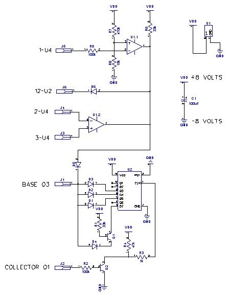

          You have a very nice layout - whites IDX. Congratulations .
          I have reverse engineer your board ( audio 2 tones ) to get a schematic diagram.
          Could you or some other helpful person please check my attachment and see if it is correct.
          I see that pin 14 of cd4024 was not connected to supply.
          Is this correct??
          My attachment shows it connected.
          This is first time i have done reverse engineering so any help would be appreciated.
          Best Regards
          Maurice.
          • The PCB is this correct. I have looked at previous posts and seen that the pin14 of 4024 was not connected to +8 V. In another post later on pin14 appears connected, but you have to read all the posts for any of us can make mistakes. In the last post I had published the PCB is correct. Now I will post back and correct the PCB and the other so you can enjoy 2 tones in the IDX-PRO. To operate the circuit in 2 shades, no need to remove the U7. You have to remove only the Q3 transistor. The schematic that you just published does not look good. I want to post it on a SCH file and so you can correct any errors. Regards.
            • HI Eduardo
              Many thanks for your speedy reply.
              I will be grateful for your schematic file possibly in Express.sch.
              I will be patient for this as I would like to develop a IDX which includes the 2 tone option later on.This I will do in Diptrace and will share.
              But note it probably wont be up to you excellent standard.
              I prefer to use 2mm pads and larger parts, better for beginners
              And the layouts come out a little larger.
              Best Regards
              Maurice.
