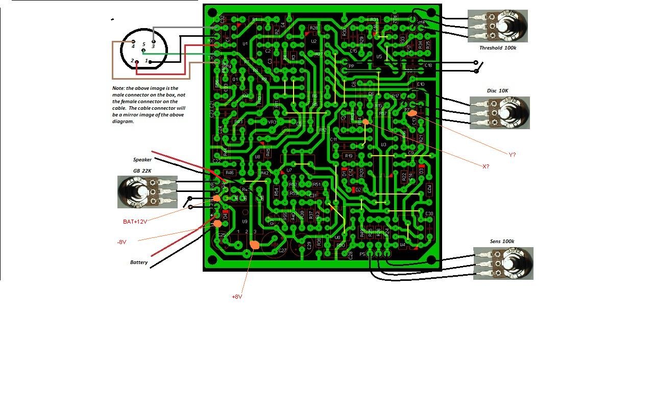

    Is the replacement of the diode (D3) with a 2.7v zener the only "valid" mod on this board?
    I didn't get results using Eduardo's pcb version without the trimmer. I'm going back to silverdog's version.
    IT IS WORK
    REMOVE VR3 ,1N4148 THAT SERIES BY 1M AND 22N AND PIN1 LF347
    CHANGE 3.9N ( SERIES TO TX COIL AND UNDER 2.2N )TO 3.3N
    FOR SPEAKER YOU CAN USE 470OHM OR 47 OHM OR ANY RES THAT HAVE A GOOD VOICE ,IN U4 MY MEANS

      Can you post an image of the pcb with the changes regarding the 1n4148? The 1M and 22N are in parallel between pin 1 and pin 2 LF347 - are you saying add a 1n4148 in series with these? you would have to cut a trace to do that or what?
      Otherwise, I understand change the 3.9N to 3.3N / and 470R to 47R. I removed vr3 and put a 2.2k in place of the 1.8k - is that right? Did you change the 1M to 2.2M off of U4?

        YES YOU DO EVERY THING , MY MEANS THAT 4148 parallel , and remove it
        please take photo your rx and tx coil and ne5534-6
        just sure all thing is ok
        i can detect 2000rial (iranian money) in 30-35 cm and good but disk mode not work for me
        • Hi mohandes if you Disc dont work you did one of two things .. You did not populate the 100k pull up on pin 12 of U2 and so cant select Disc mode. Confirm with a measurement of volts on pin 12 of U2. Use a volt meter and out the black lead on the metal around the edge of the pcb and the red lead on pin12 of U2 FOR Disc mode the volts should be +4v OR Disc pot wired wrong - wire that should go to wiper, going to Geb ch end of pot - so stuck in all metal. - or all of the above. S

                            i do this :
                            VR3 - out, only R43 1k8 -> 2k2
                            you say me i should have U2-12 +4volt but i have 7.93volts ???? ,this is ok??
                            i put my pots like this
                            my friend koala please tell me more simple that mr golnut said .
                            and about the VR3 if i should i put it on the pcb if it is necessary .the VR3 just for adjust to reject iron , i say ok ??
                            • "Hi Golfnut.. is your system set up exactly like the schematic in "most of it.zip"?" Good question.. The only differences on that hardware build was the Disc gating resistor in series withwhere VR3... the fixed resistor was swapped out for a 560ohm - to give more range on the pot. The other difference was the double diode in the last Geb filter/amp, was a single 1N4148, as per the pcb. Also the Diode which feeds back with a 47k to the input of the GEB Comparator - - There is NO diode on the pcb I used. It still works real well. If it helps, the pcb was one of the ones which had a short, once cut , these work real well. So as mentioned, single diode on geb filteramp, NO diode wrap on Comparator, as pbc - not schematic. Thx for asking. S
