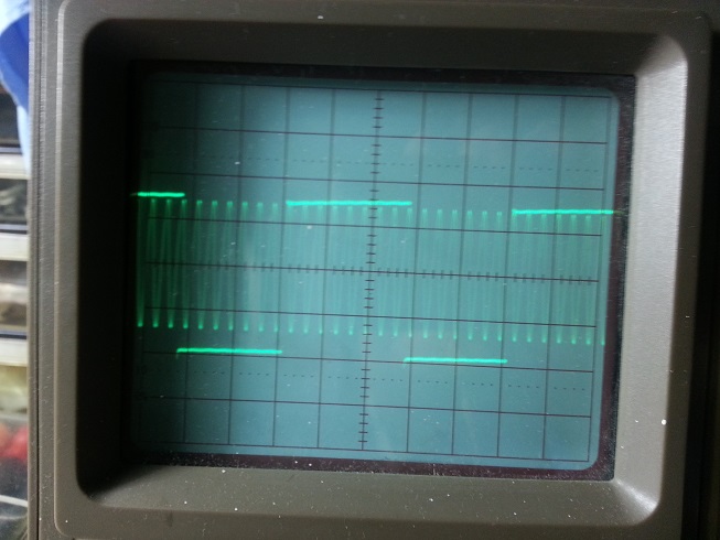

  • Post scope image of initial phase ,, Geb gate wrt Tx signal, Disc gate wrt to Tx signal = you need all 3 right before you make progress. S
    • I'm getting -4v and +3.96v with respect to ground.. should it be -4 and +4?

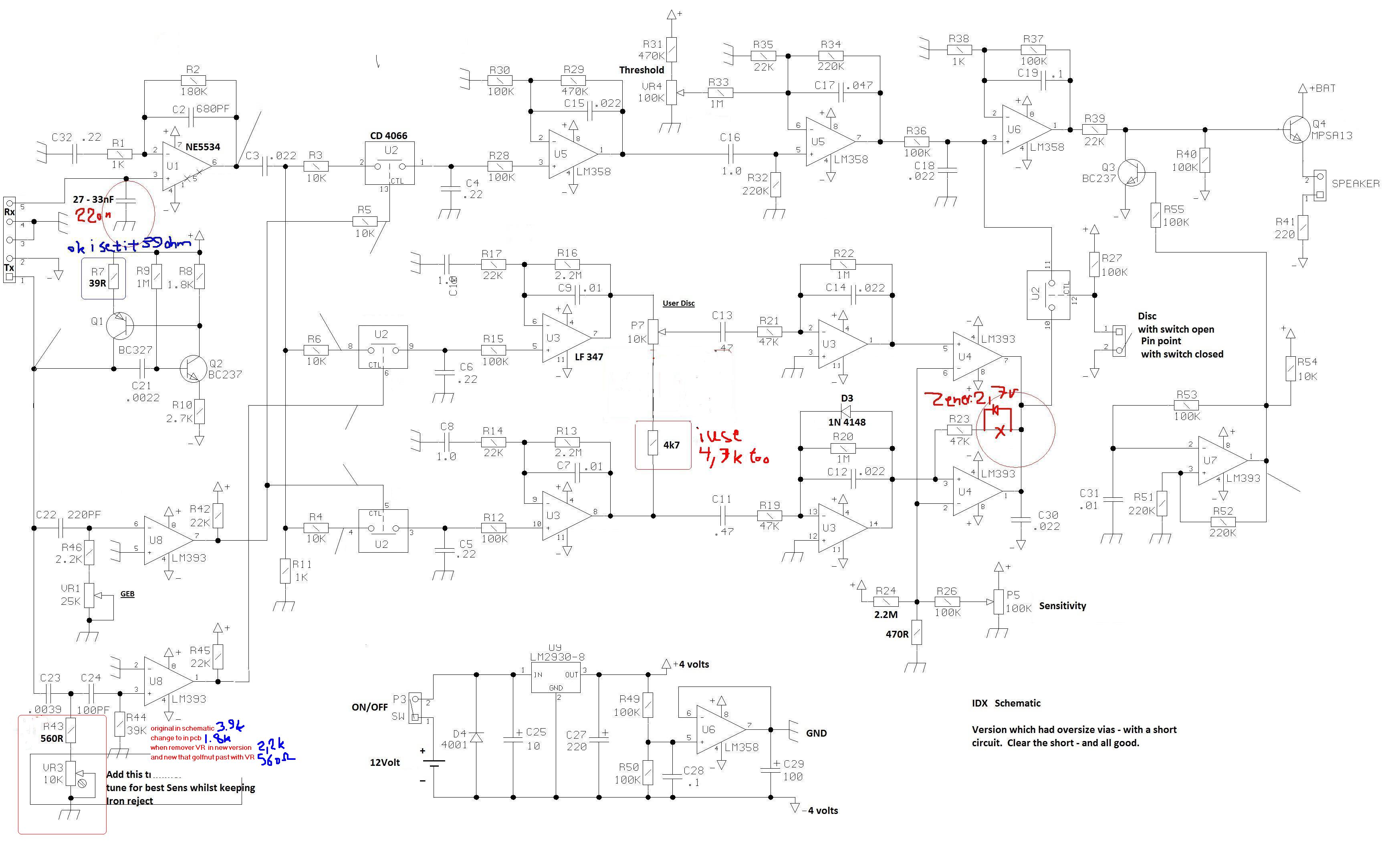

        "Hi Golfnut.. is your system set up exactly like the schematic in "most of it.zip"?" Good question.. The only differences on that hardware build was the Disc gating resistor in series withwhere VR3... the fixed resistor was swapped out for a 560ohm - to give more range on the pot. The other difference was the double diode in the last Geb filter/amp, was a single 1N4148, as per the pcb. Also the Diode which feeds back with a 47k to the input of the GEB Comparator - - There is NO diode on the pcb I used. It still works real well. If it helps, the pcb was one of the ones which had a short, once cut , these work real well. So as mentioned, single diode on geb filteramp, NO diode wrap on Comparator, as pbc - not schematic. Thx for asking. S

            U2-12 is 7.93volts ( you say should be 4volts )" You got 8 as you put the black meter lead on the -4v rail, not the pcb edge like I mentioned. It doesn't matter, the fact is you have the 100k pull up in - so at least your selecting Disc mode in hardware. Are you cerain you re checked the Disc pot wiring - We all think we built it right and never recheck.
            • revised Schematic for IDX PCB which had the short
              I took it upon myself to match at least 1 schematic with a pcb variant. Ive cleared out lots of junk from schematic. I added hoverable waveforms. As uploads are 1M max I had to split the application into 3 parts. Unzip all three, put the additional images into the Images folder in the main folder. Click the html . S

                  i post the diff values that you change it and certain in pic look
                  and why you change 220n to 33n-27n??/
                  and you say me dont remove D3 , and in original schematic it is 2.7zener but you say 1n4148 is D3 (many time ago ) ,, ok now i remove it or not ????????? . better i say i should have a one of them D1 or D2 (not D3 ) ???
                  and i just see these changes if more tell me
                  so finally :
                  1- about the 220n to 33n or 27n??
                  2- about D1,D2,D3??
                  3-adding VR3 and change R43 to 560ohm ???

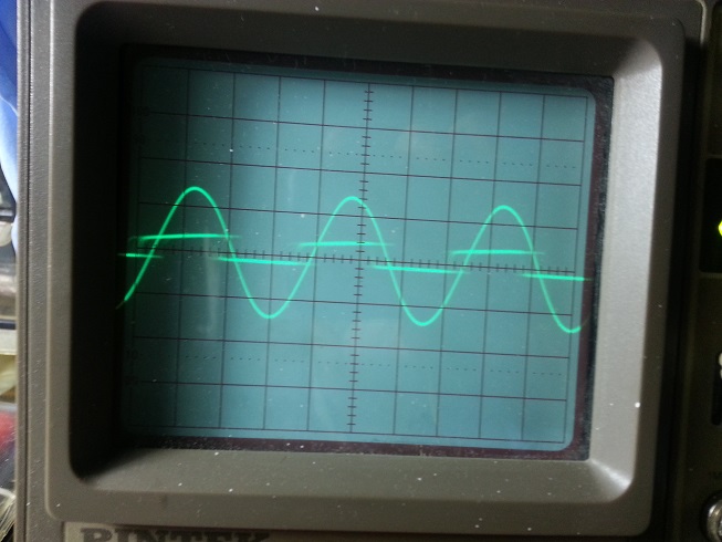

                    am only able to upload 2 scope images.

                      • What you seem to be struggling with is, There are about 4 schematics for the IDX and there are approx. 3 pcbs. None of which correlate/match up perfectly. The only Schematic and PCB which DO match up is the one I posted yesterday, The pcb had a short circuit due to a small error. The Rx cap you use needs to match up with the L you made - Measured Rx tank at 27nF Rx coil L=37.5mH
                        Therefore F res = 5kHz The Tx was 6500Hz or 6.5kHz The pcb I had only had one diode - D3 other pcbs and schematics exist too - perhaps you made one of those.. "but you say 1n4148 is D3 (many time ago )" Yes that's right, and it still is on the PCB and schematic I published yesterday. I suggest you strip off any mods/trials and build yours to what I published yesterday. This way you will have a good working detector, and I wont have to wear the letters off my keyboard typing this crap. Would you ease off pm ing me please S

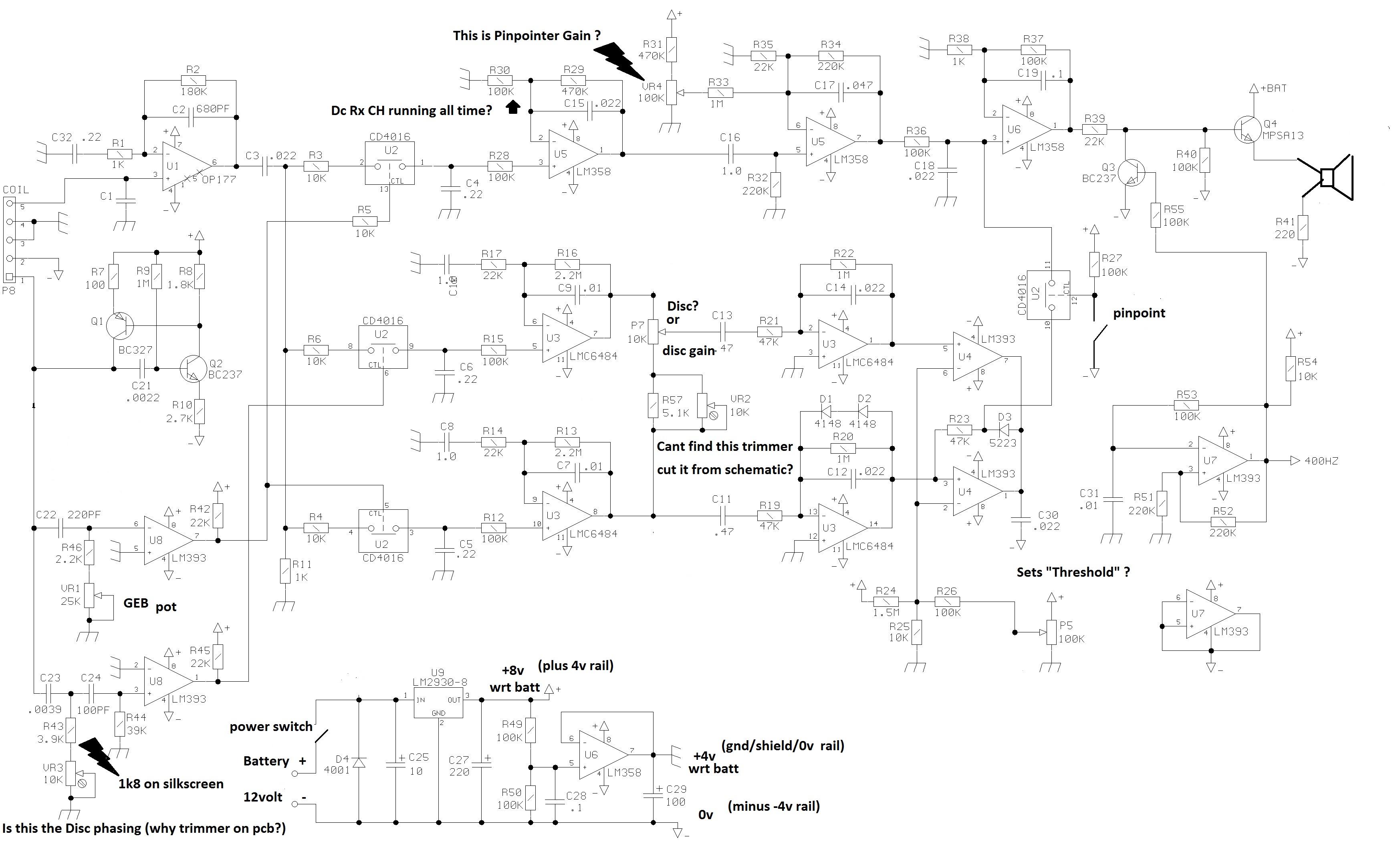

                          • Hey has anyone redawn the IDX in ExpressSCH format? I've staid away from this project
                            because the schematic is too hard for me to read...
                            • Originally posted by Silver Dollar View Post

                              my friend just download this pcb ( be careful have 2 or 3 mode ) and next do any thing that mr golfnut do .(download that too )
                              if you can make dd coil next continue .

                                Things are looking up, its working again though a bit off - its popping right after the tone on each pass like I'm over driving it somehow.
