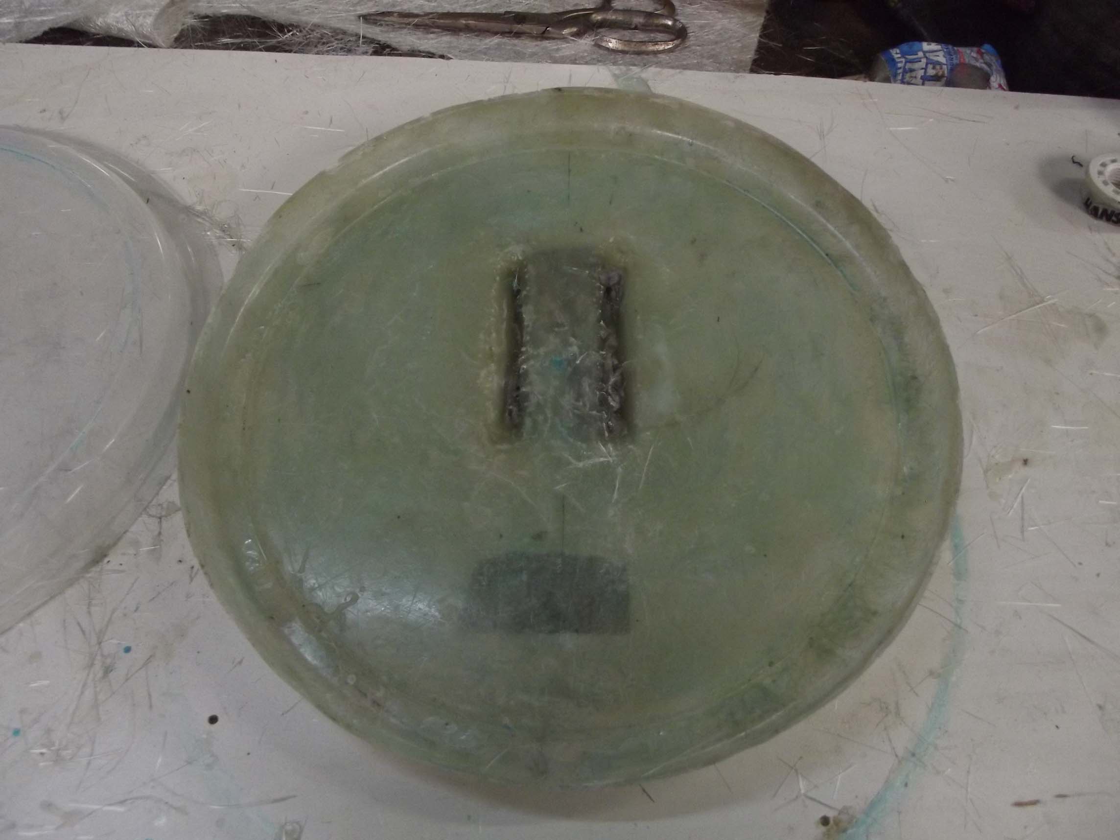

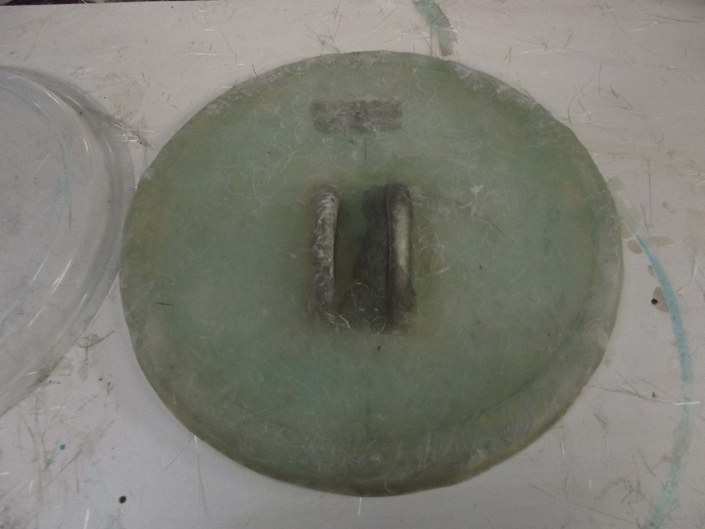

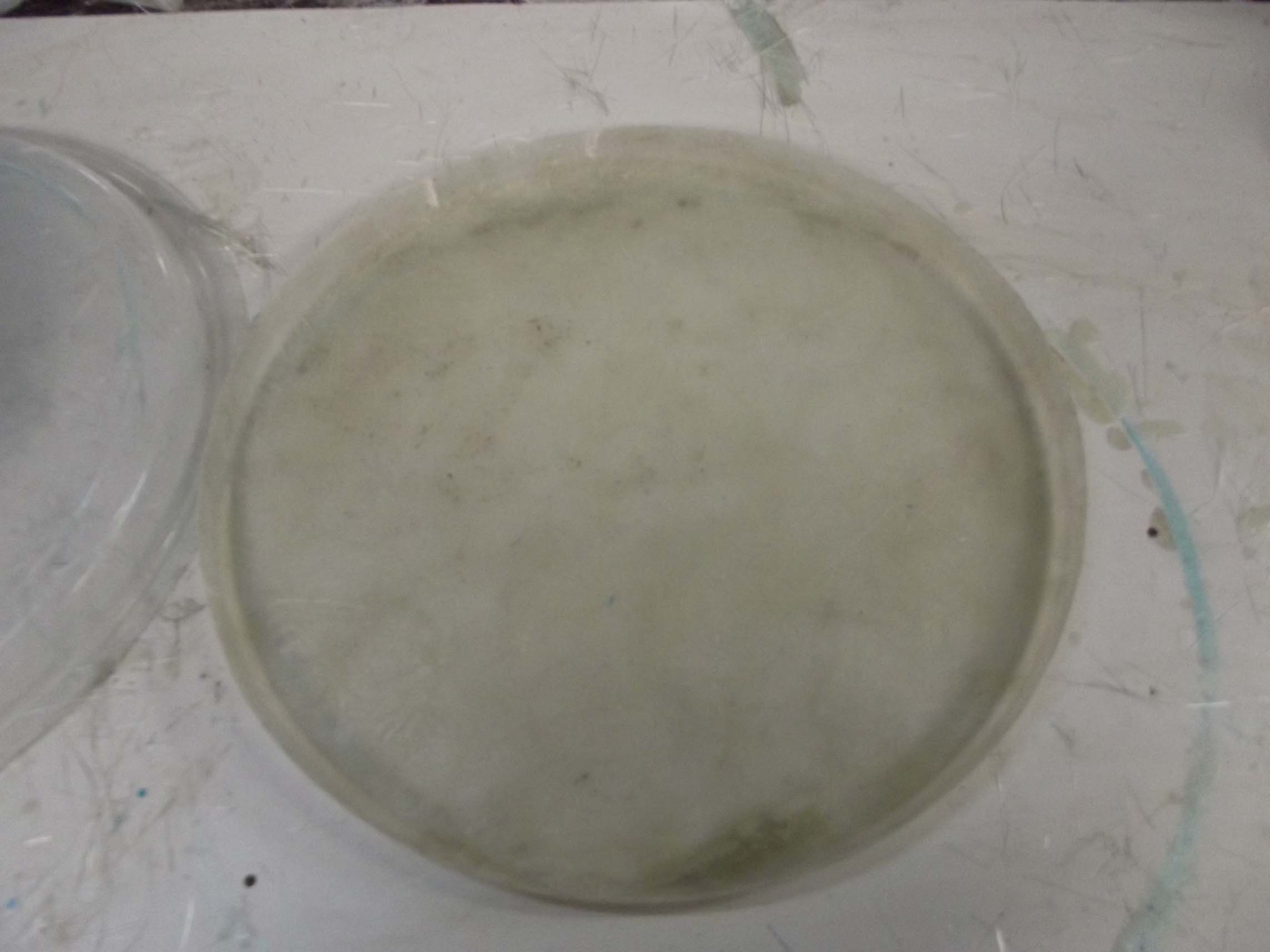

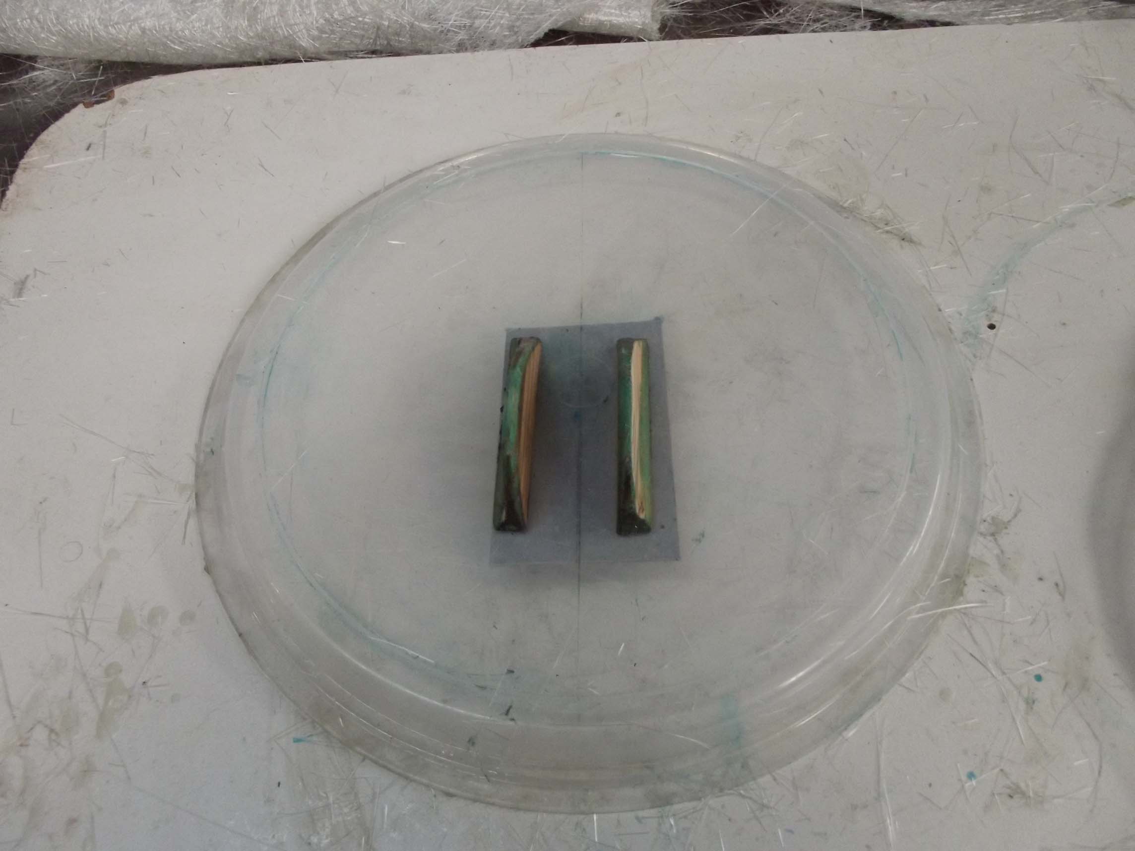

      HI ,ALL,,, MY attempt at a 27,,DD coil-Shell from fibre-glass Click image for larger version

      I could not buy shells in Australia ,So as I had resin & glass sheet ,so I give it a go ..
      I tried to keep it Light in weight [using 2x plys of glass ] the Resin I have is a Marine -resin ..
      I made a couple wooden ears & screwed them onto a Plastic Lid to use as a mold outside for the top & inide for a bottom-cover ..

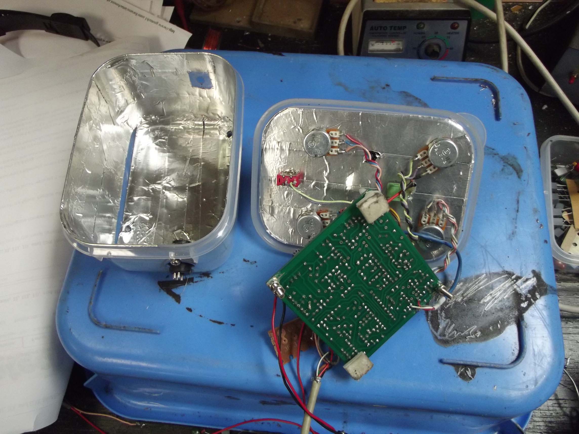

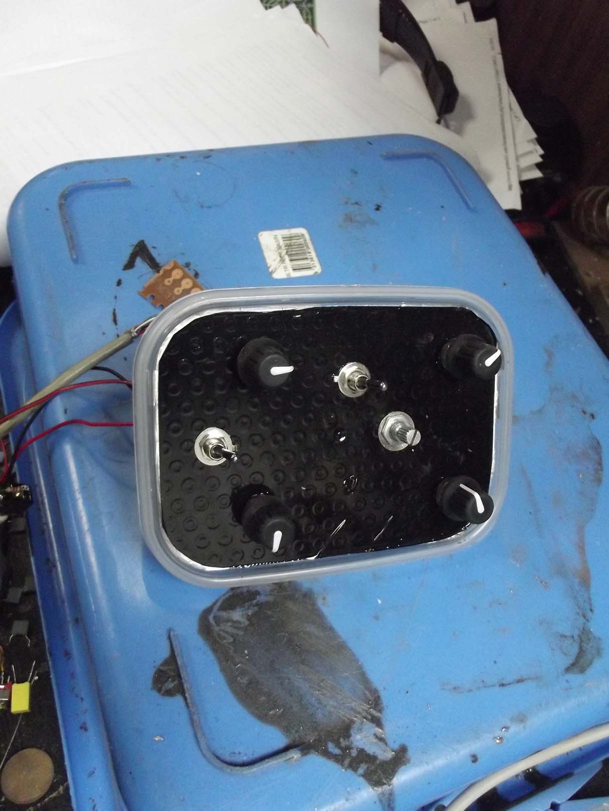

      The other pics are my Plastic housing for the board & controlls..

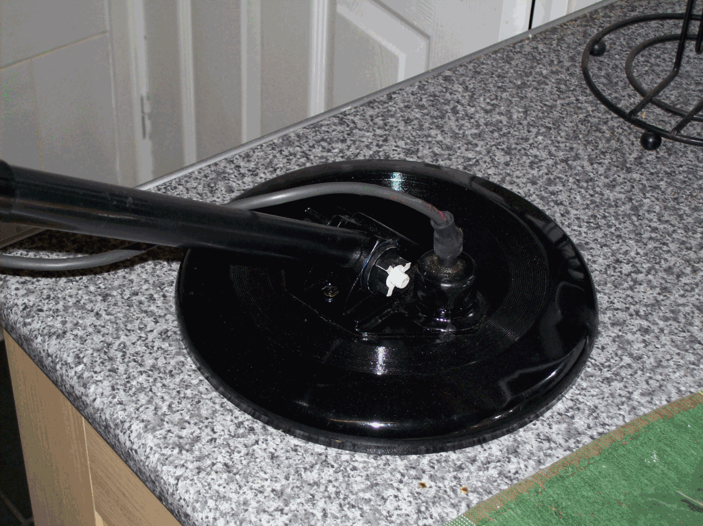

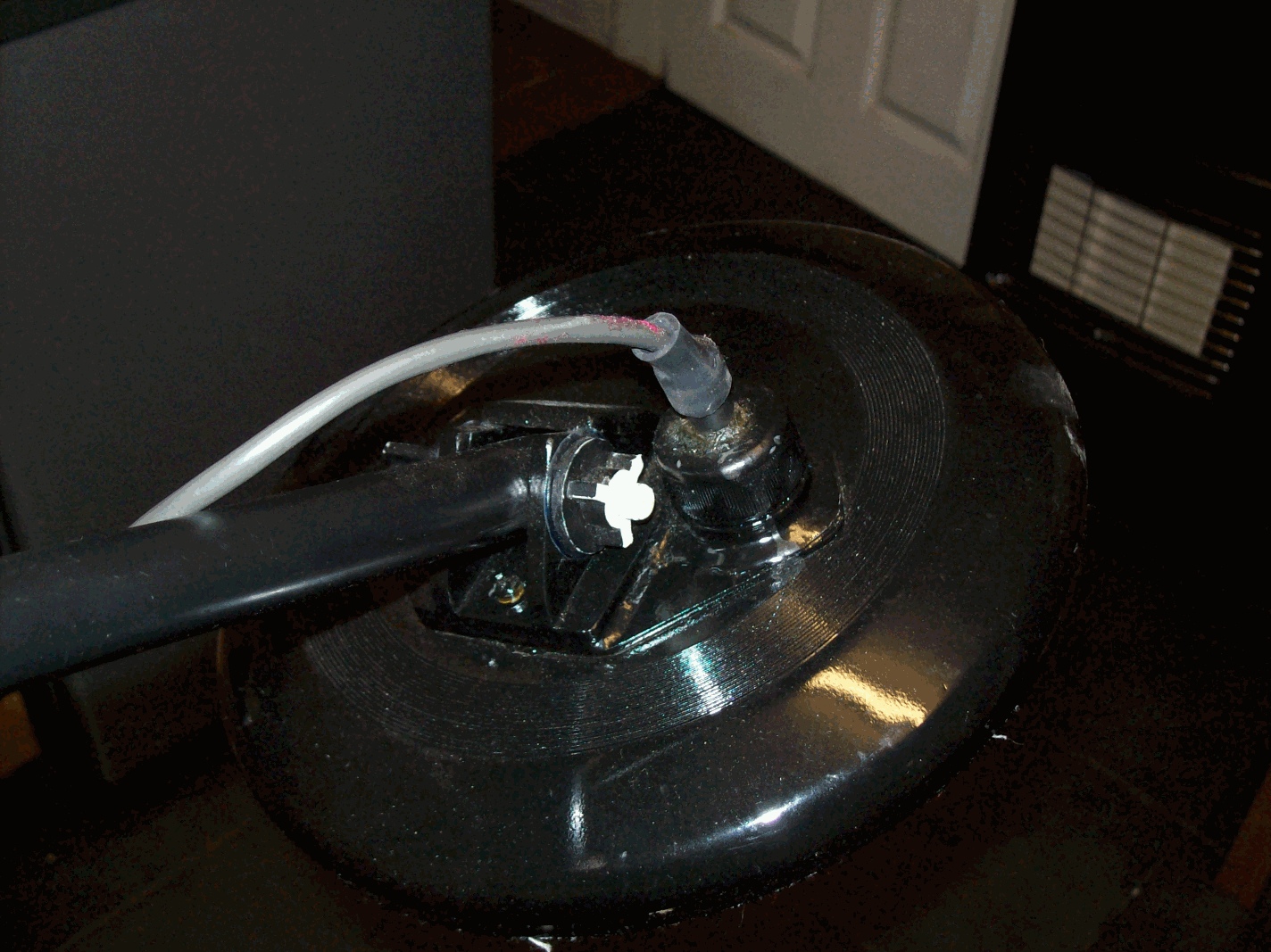

          • barry take a look at frizbees aswell, add ears and they work, they are cheap light strong and injection molded.

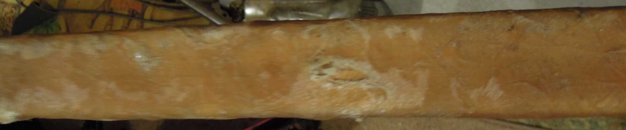

            • 2 questions;
              SinclairUser what do you use to glue to the Frisbee's?

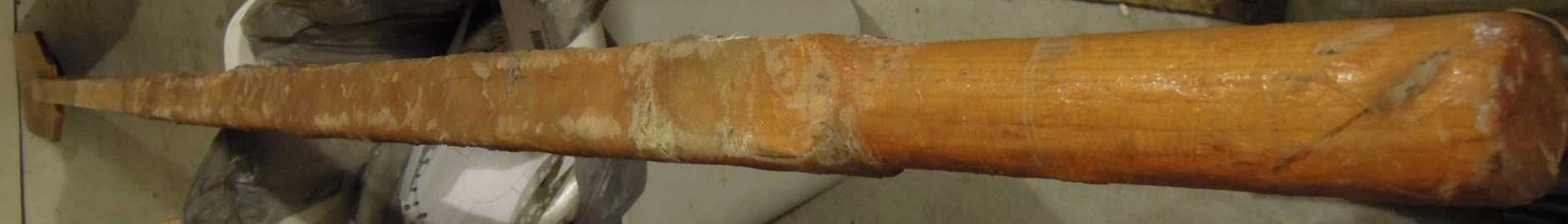

              And Barry how do you get such good results with the fiberglass? I've always had problems with
              air pockets. Here's a couple of pictures of a boat oar I was trying to make;

              • i have used pipe joint adhesive(the ears have to be made from the same type of plastic), the one in the pic the ears are made from perspex(lexan), this is glued to the frizbee with flexable epoxy, there are two nylon number plate bolts to squeeze this together.
                but i have done the same design using superglue(the expensive gel superglue), designed for sticking plastics, the cheap pound shop super glue does not work its just not the same, if you clamp this till the superglue dries it works.
                the coil in the pic was used all summer, and held together great though none of my coils fell apart.

                            S/D ...yes the air bubbles need to be rolled out before the resin sets ,As this shell is small area its not too bad to get most air out ,, I use a paint-brush ,but a small roller would be good ..
                            That oar would be not easy to DO as it has much area to do in one go You could do it in sections as long as not leaving it too long between coats [layers etc] 24 hours max !!

                            • @ barry home made graphite paint applied to the inside of the shell, originally applied to paper tape stuck on the inside, now i use acrilic paint designed for plastics as my paint base.
                              i have tried expanding foam but it has problems, firstly there are different grades( lower density is a must), secondly it can force your coil apart,you need to either seal it really well and not put to much in , or not seal it but bolt it together with nylon bolts then trim of the access after it sets then seal it, thirdly some of this foam gets hot as it cures.
                              but finally some also has iron oxide powder mixed in it and is detectable (by vlf).
                              personally its not worth the hassle, better to cut sheets of the dried stuff and add it during construction, some of this has iron oxide in it too (the colour gives it away) so test it for detectability.
                              p.s. beach shops and pet shops sometimes sell frizbees.
