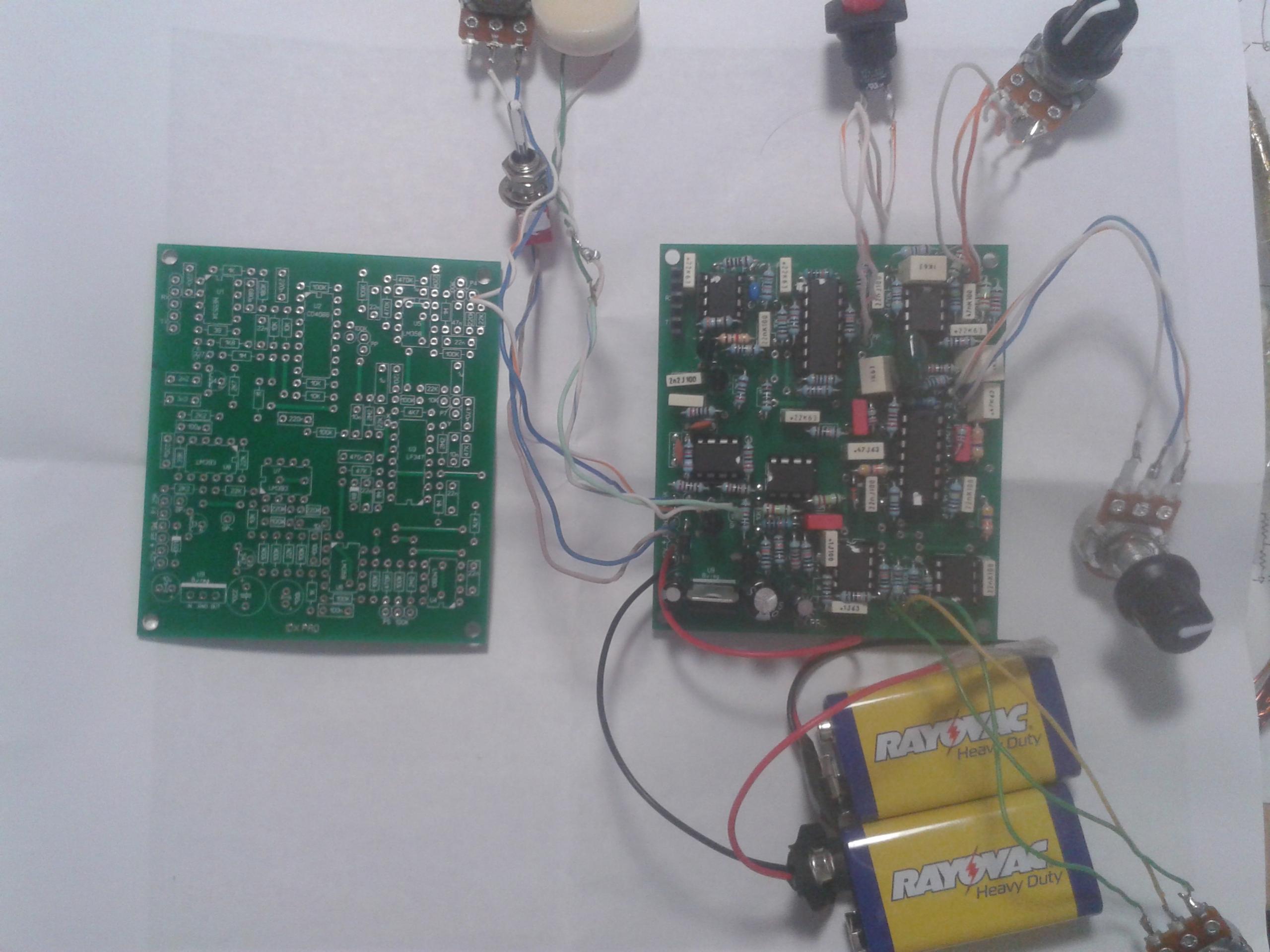

                    • I think my 2 Boards act like dead bricks.
                      I will post Photos of the 2 Silverdog IDX PRO Boards at lunch.
                      Maybe somebody can spot the problem.
                      • jlsilicon you think maybe you have the ones with the short that you need to cut look there first then battery
                        • * I have already scanned over for shorts between components.
                          * I will check for Board Short at lunch.
                          * Battery is (2) 9V Bats in series which should be fine with the 7808 VReg - which is not hot.

                            I believe he means the PCB that was made wrongly, with a short on the PCB that needs cutting. I remember reading about it some time ago....
                            It is documented here somewhere....maybe someone better informed than I can help better....
                            Andy

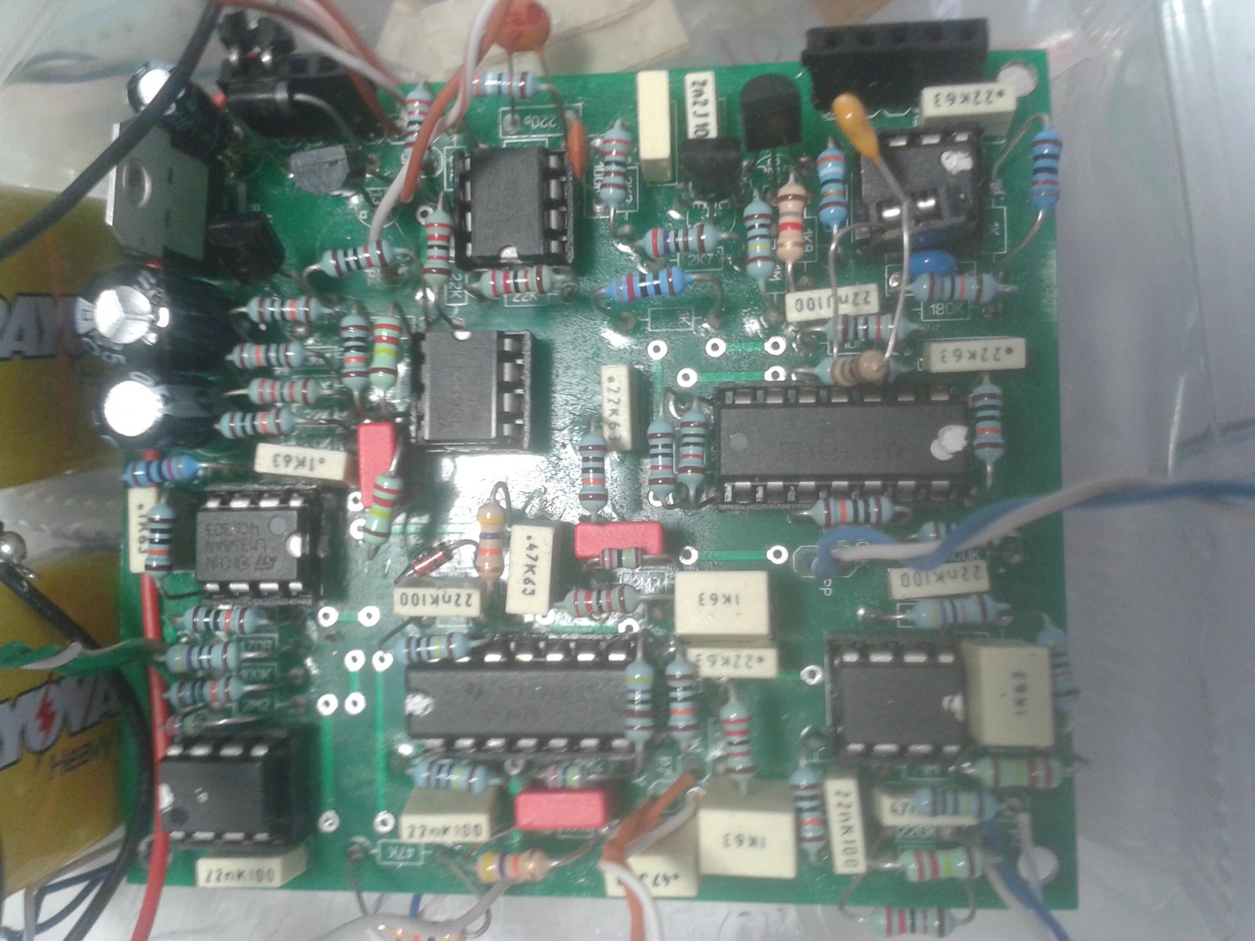

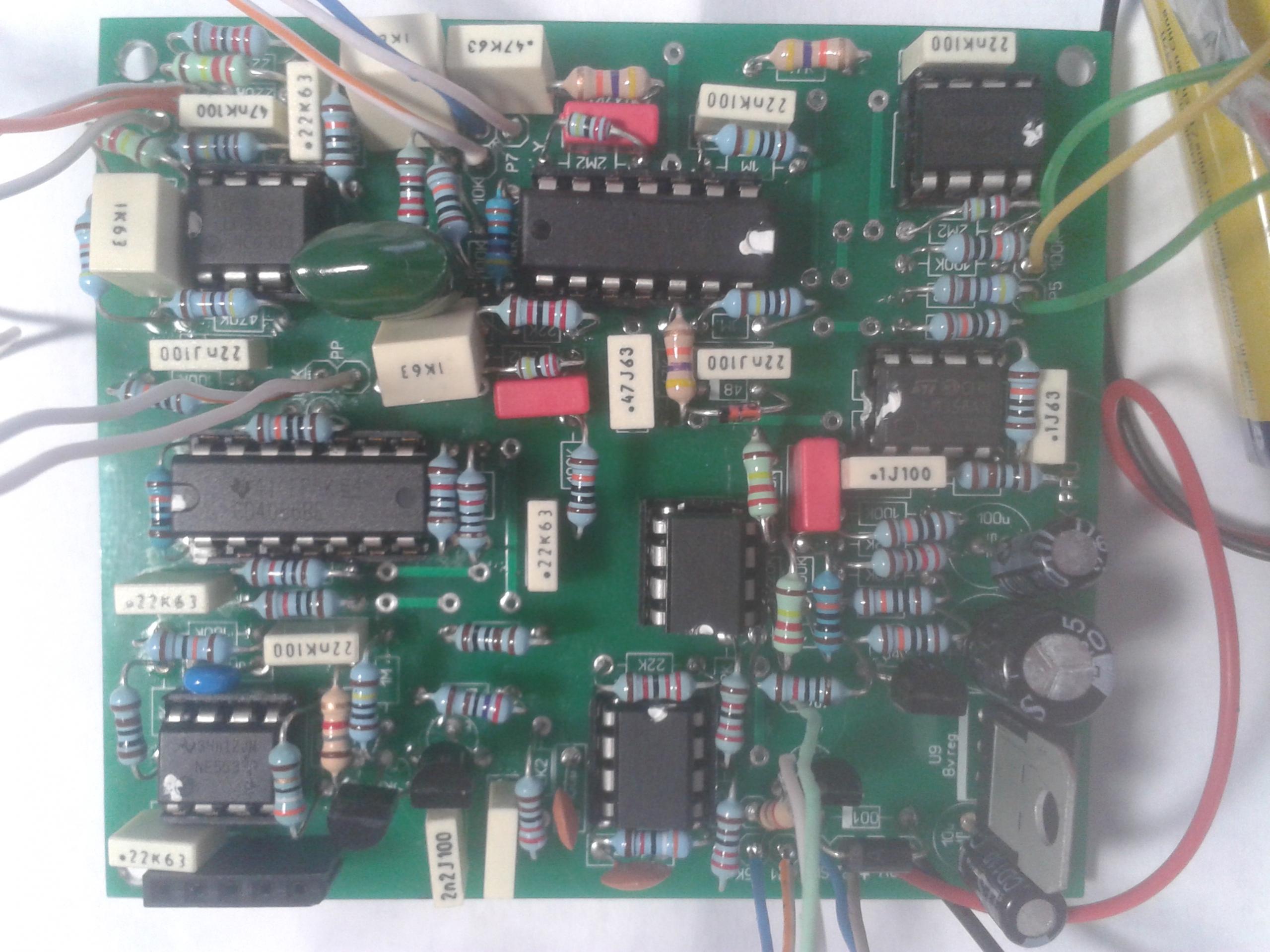

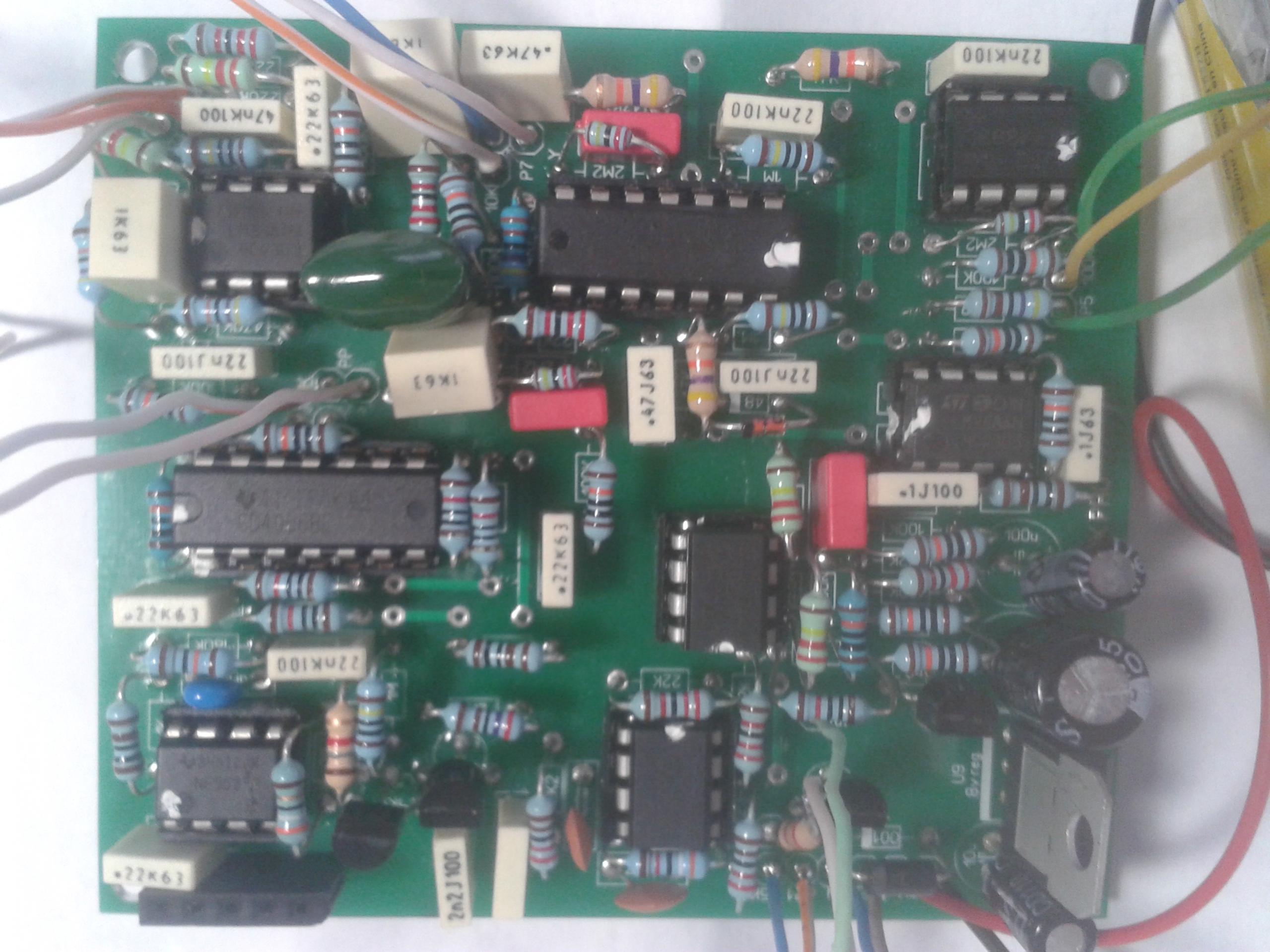

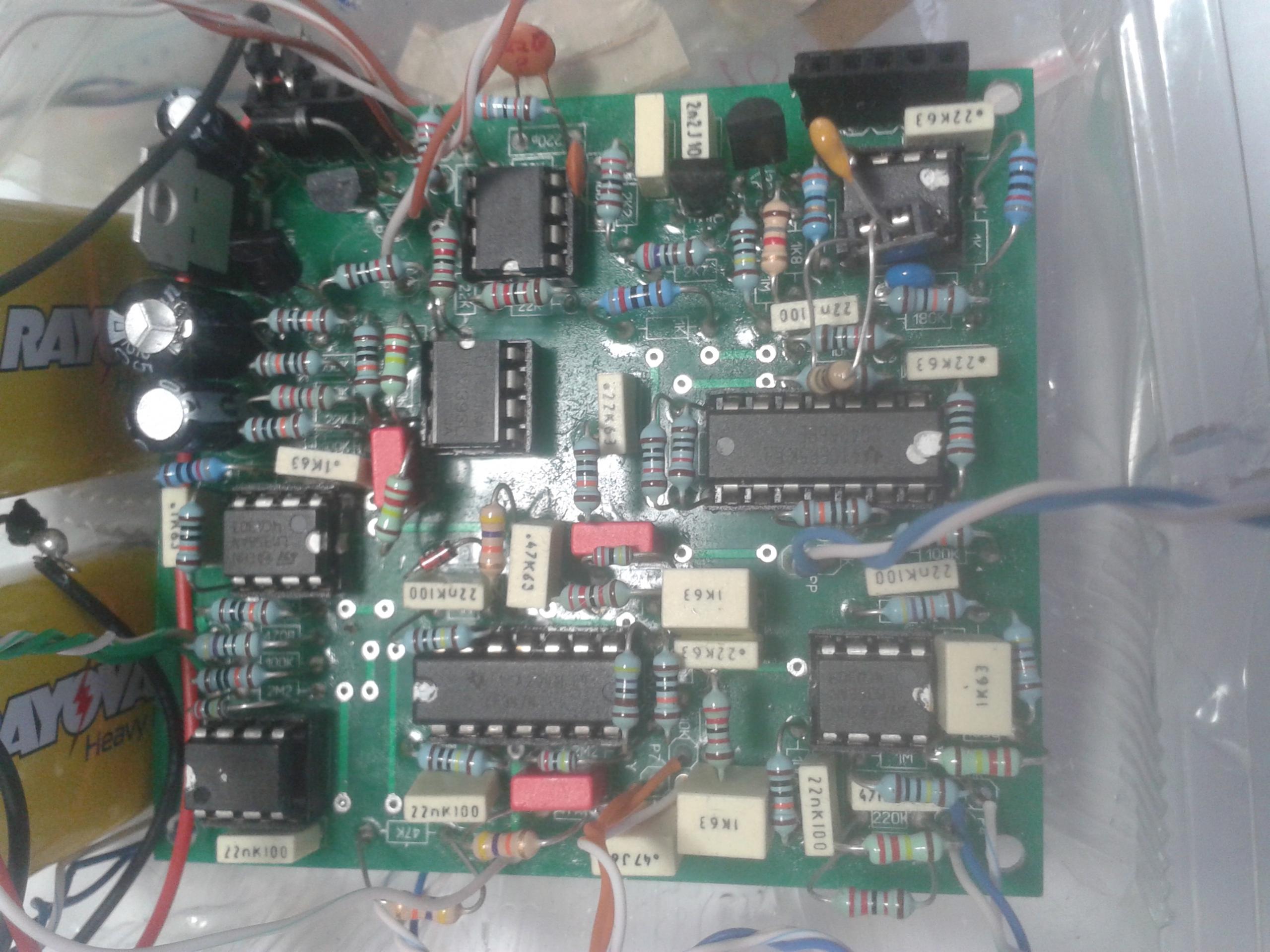

                            • Board snapshots :
                              Board snapshots :
                              Board 1:
                              Board 2:

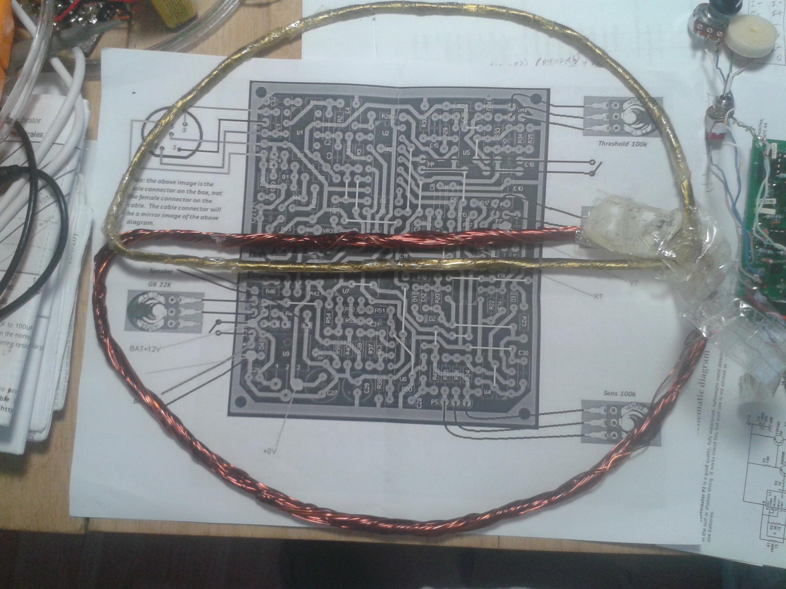

                              Coils :
                              Other friend who dropped into my project:
                              I don't see the Short - looks clean.
