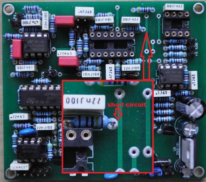

      • Originally posted by jlsilicon View Post
        I don't see the Short - looks clean.
        I do believe it was under the resist, you won't see it. Especially so that the board is built. You need someone, maybe Silverdog, to tell you exactly where it is. Someone else here could possibly confirm this? (Or deny it!!). You may need to tell him the version....
        Also, I personally would never build a PCB and place the resistors so far from the PCB, they should be lying on it....its mechanically and electronically bad.
        Andy
        • Cats like to watch people working. They never offer to help though.
          • I found this picture in the archives;

                • Originally posted by Silver Dollar View Post
                  [ATTACH]31810[/ATTACH]
                  That is a good picture, well done for finding it, hopefully that is the problem he has, he can now fix it.
                  Also, the board shows properly soldered in resistors, laying on or close to the PCB, as they should be.
                  Andy
                  • Problems with your PCBs
                    Board snapshots :
                    Board 1:
                    [ATTACH]31785[/ATTACH]
                    [ATTACH]31786[/ATTACH]
                    Board 2:
                    [ATTACH]31787[/ATTACH]
                    [ATTACH]31788[/ATTACH]
                    [ATTACH]31789[/ATTACH]
                    Coils :
                    [ATTACH]31790[/ATTACH]
                    Other friend who dropped into my project:
                    [ATTACH]31791[/ATTACH]
                    As far as I can tell with the bad picture quality that I guess a mobile phone made, I could not see the short.
                    What I do see is appalling workmanship, leads on most components are far too long, which means that they could have tiny movements and cause major signal changes in such delicate circuitry......such long leads change capacitance dramatically...
                    My best advice to you is to simply start again, after reading some tutorials on how to place components on a PCB correctly and solder.
                    I would also suggest that you identify each resistor and capacitor using a meter, to make sure that you have the exact right component in the right places.....it is easy (we have all done it!) to place say a 4K7 resistor where a 47K0 needs to be placed. Caps are even easier to misplace.
                    All leaded components must be placed as close as possible to the board, but without straining the component to achieve this. I would say that you could probably stand up some of the resistors on one end, to allow all to be fitted in dense areas...though the other board shown is neat and looks good, did not seem to need this at all....
                    Most of your components can be saved by simply cutting them off at the PCB, removing the legs individuallyusing a solder iron (they sort of "stick" to the iron and are easily and quickly removed) and in the end, reforming the legs using a long nose pair of pliers, refitting and soldering. That way, you will not heat stress the PCB too much.
                    I could not see well how your soldering is though, that may also be questionable too....
                    There seems to be a socket with components stuck in it instead of chips, this looks terrible. If you need to do such mods (are they documented here?), then remove the socket and solder correctly.
                    To remove sockets, cut them up and remove each pin separately, do not try to remove it whole, or try to reuse it. Sockets are very cheap. Reusing will just cause extra problems.
                    Perhaps some quality pictures of your PCBs from both sides, using a better camera, might be a good idea if you want further help from us here.
                    As built, you will have major problems getting either them to work reliably if at all.....as the old joke says, "if you want to drive to London, don't start from here!"
                    Think of this as a learning curve.
                    By the way, there are many soldering tutorials on the web, you can copy a few and print them out for reference.
                    Best of luck.
                    Andy
                    • Originally posted by der_fisherman View Post
                      Andy
                      There won't be a short on current boards - it happened once with a batch, they were soon dumped when it was identified
