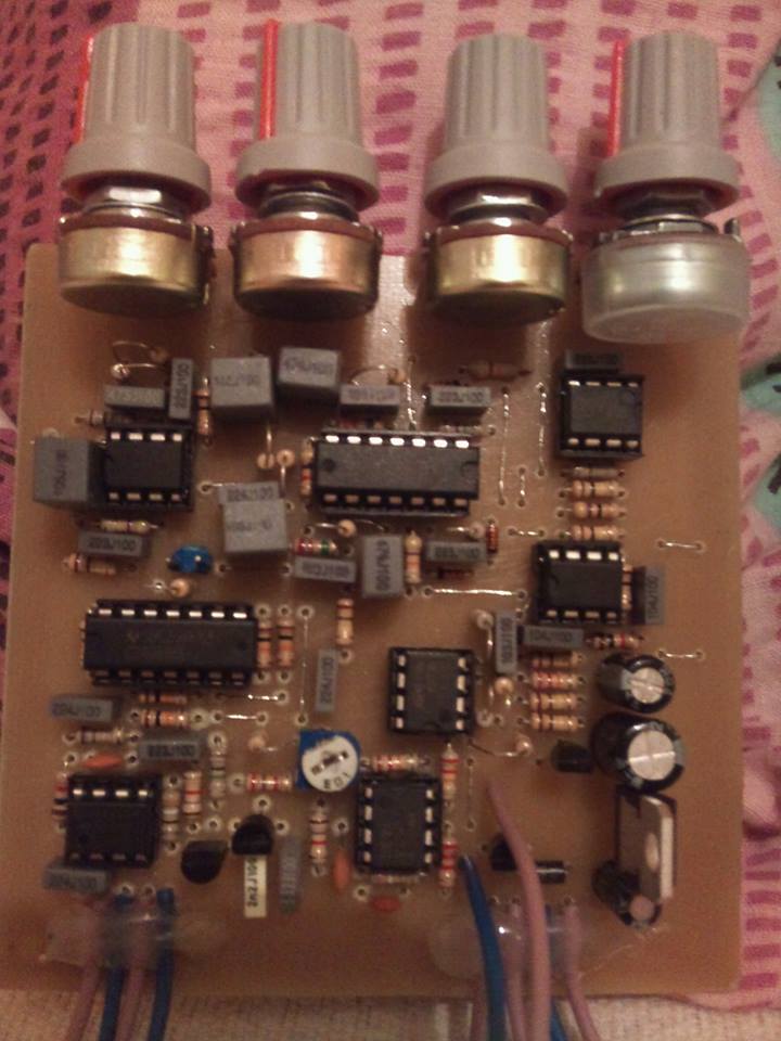

                      • My new IDX pro board with pot in board.
                        • Originally posted by seadoggy View Post
                          Nice, well done, lots of hard work.
                          Does it work well.
                          Not strictly necessary but I do like a multi turn for the ground balance.
                          Should be nice and easy to package
                          • Originally posted by Koala View Post
                            Does it work well.
                            Thx alot Koala!,Work very very well,its is very stable.my old board is not stable like this with pot in board.This is my best IDX ever.
