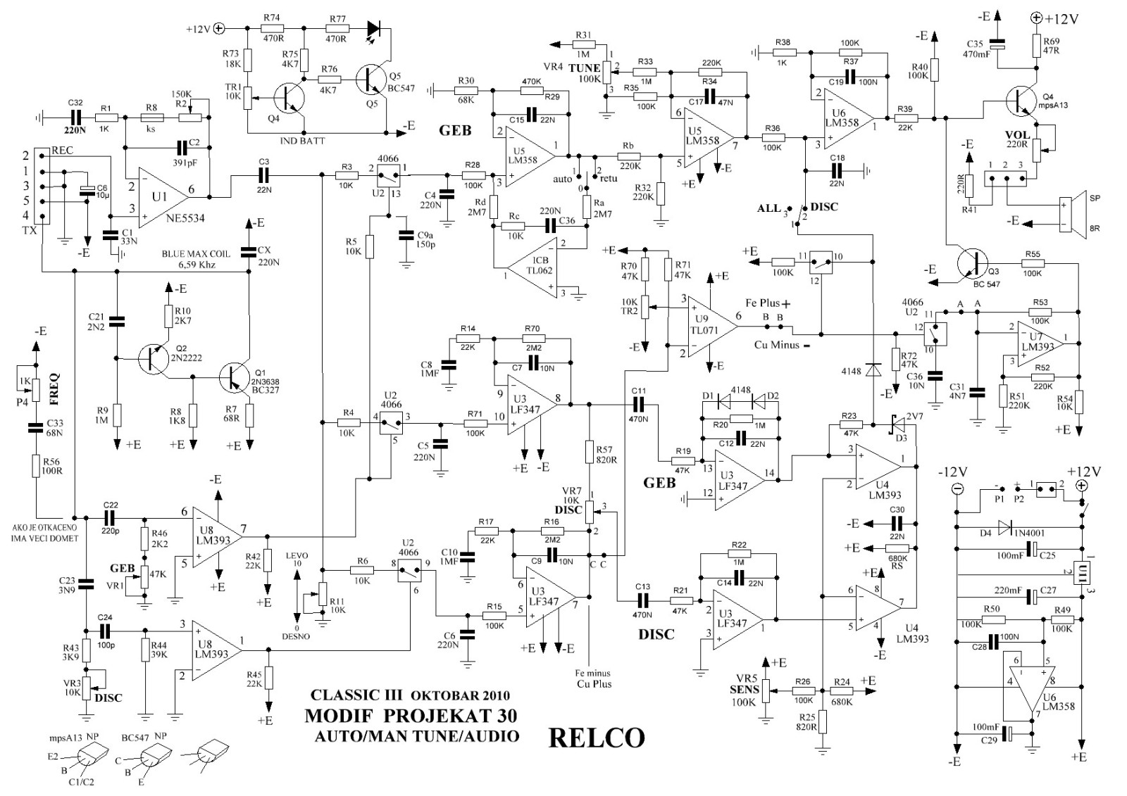

        • I keepp looking for a simple way to do tone ID.
          The thing in my mind is, use the signals on the channels to give the tone freq, like this.
          With Iron, the signal goes negative on one of the channels and pos on the other
          With bronze signal goes positive on both shannels.
          With this in mind I want to sum the Disc and Geb signals --
          So Iron is approx +x with -x
          bronze is +x with +x
          If the summer amp out fed a VCO ( rather than existing fixed tone) you get a range of frequencies for ID.
          As long as the audio VCO could steer a bit lively, so when the amplitude trips on the comparator you hear a tone representing Fe or non Fe.
          You could get decent silver to be one extreme.
          S

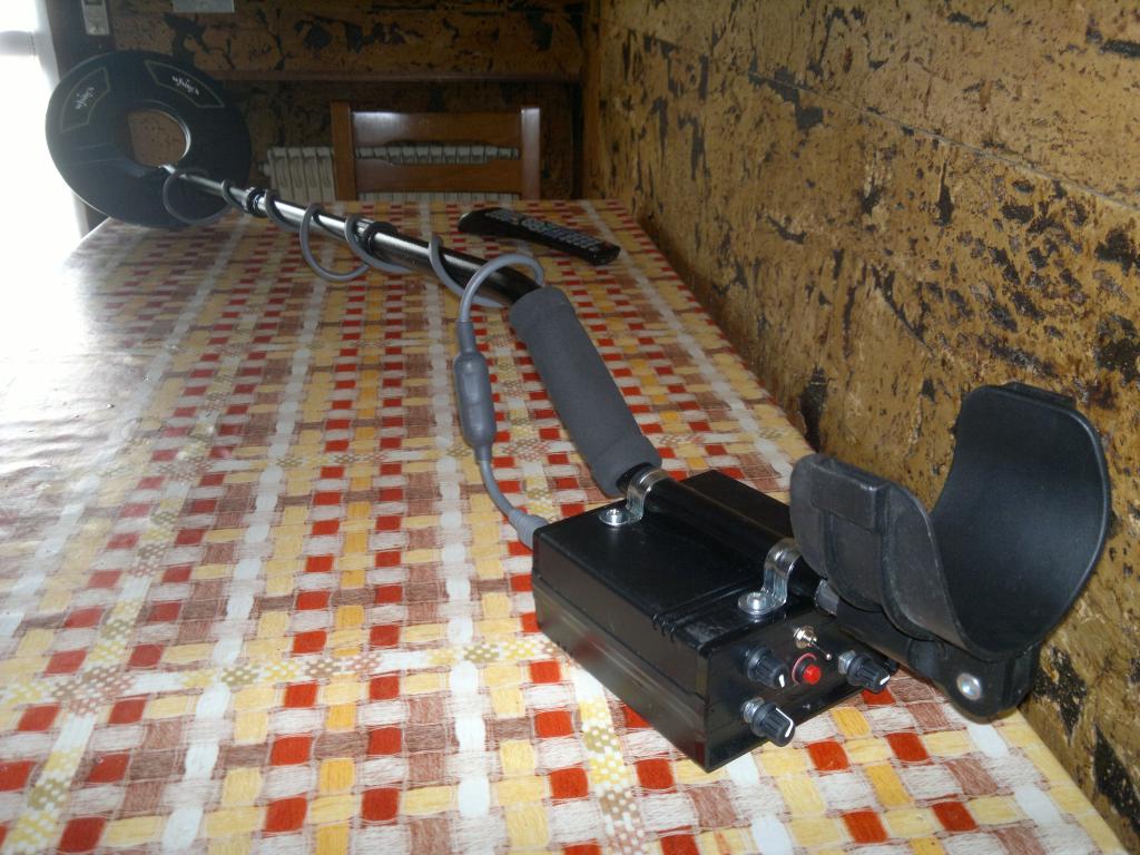

          • I finally finished my idx-pro, I'm very happy with the performance, 2 euro are heard in air at 42 cm and 30 cm below ground.
            1 euro is heard at 28 cm below ground.
            http://s740.photobucket.com/user/ven...60aaa.mp4.html

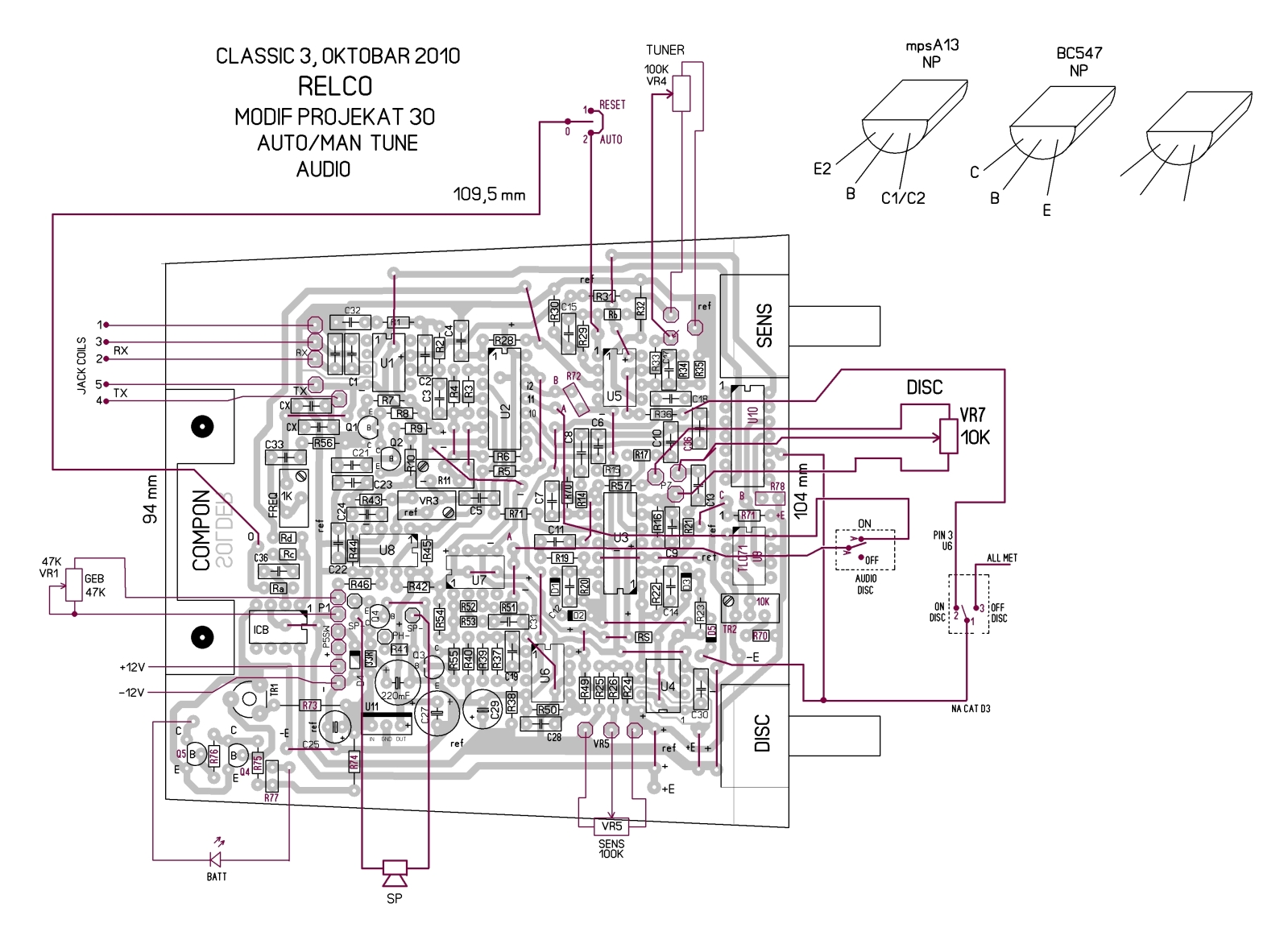

            • For tone ID the Russians have created a Cibola clone and used a PIC 16F73 to do the tones.
              Here is the hex and the wiring;

                • fabio-evo
                  Could you please tell me what is the Whites coil you are using on your Idx
                  thanks
                  • the coil and 'a Blue Max 950 Loop (6:59 kHz) taken from the site's white's uk
                    • Originally posted by fabio-evo View Post
                      Thanks for the info
                      • Tone id
                        Tone id with 2 tones ,in all metal mode and disc mode.
                        • nice, I tried something similar one time wuth a fet in as the resisor in the tone oscillator - I wanted the delta between the two channels to adjust the RC time const of the tone geb but I couldnt get it to work
