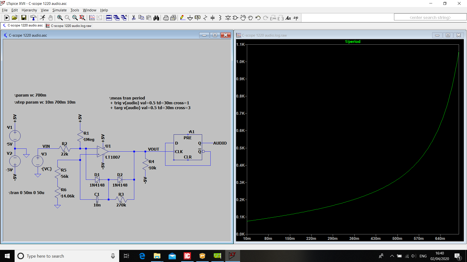

          • Try this circuit, it is taken from Cscope 1220b metal detector. Nice vco sound.
            Look for the complete vco circuit (the audio amp is missing from the ltspice circuit) by searching for the 1220b schematic here on the forum. I'm will show you how to do he circuit is connected to the rest.

                              dbanner is there in this one who knows what transistor is used in cscope1220B audio
                              https://www.geotech1.com/forums/show...ighlight=1220B
                              • Originally posted by SWL View Post
                                liekwang --- It is for PI
                                yes for pi but i haven't tried whether it can be used I highway it can be used for idx but who knows what the tone will be like
