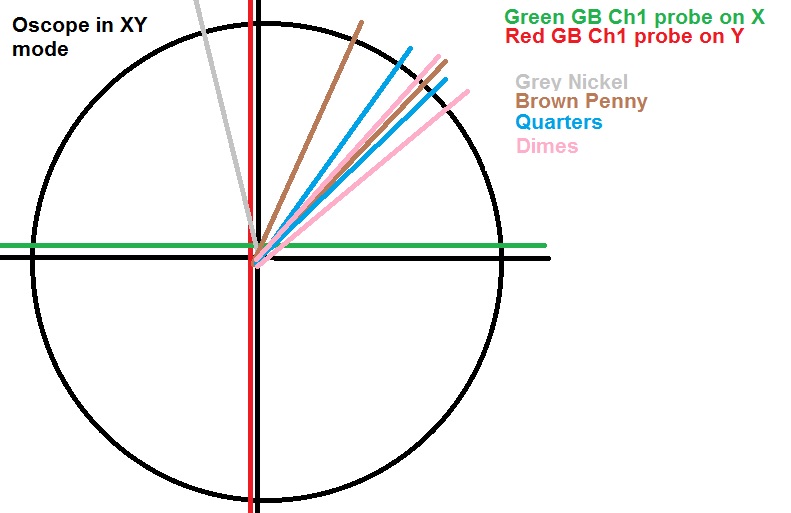

                  • Question, IDX Pro red board, With my Scope in XY, Channel 1 probe on X and Channel probe 2 on Y, GB goes up and down, would that not be 0, Should it not be at the -95 - +95 left to right ? by switching the probes it does switch the GB alone the 95 Plain. With a Nickel it is being detected in the negatives not the positive, look at the little sketch please and tell me what you think. Seems like everything is all bunched up together besides Nickels and ferrous metals. I do not know if it is they way I have my Oscope set up or if there is a problem with the detector, the scope is Plugged right in to the detector with out a MCP602

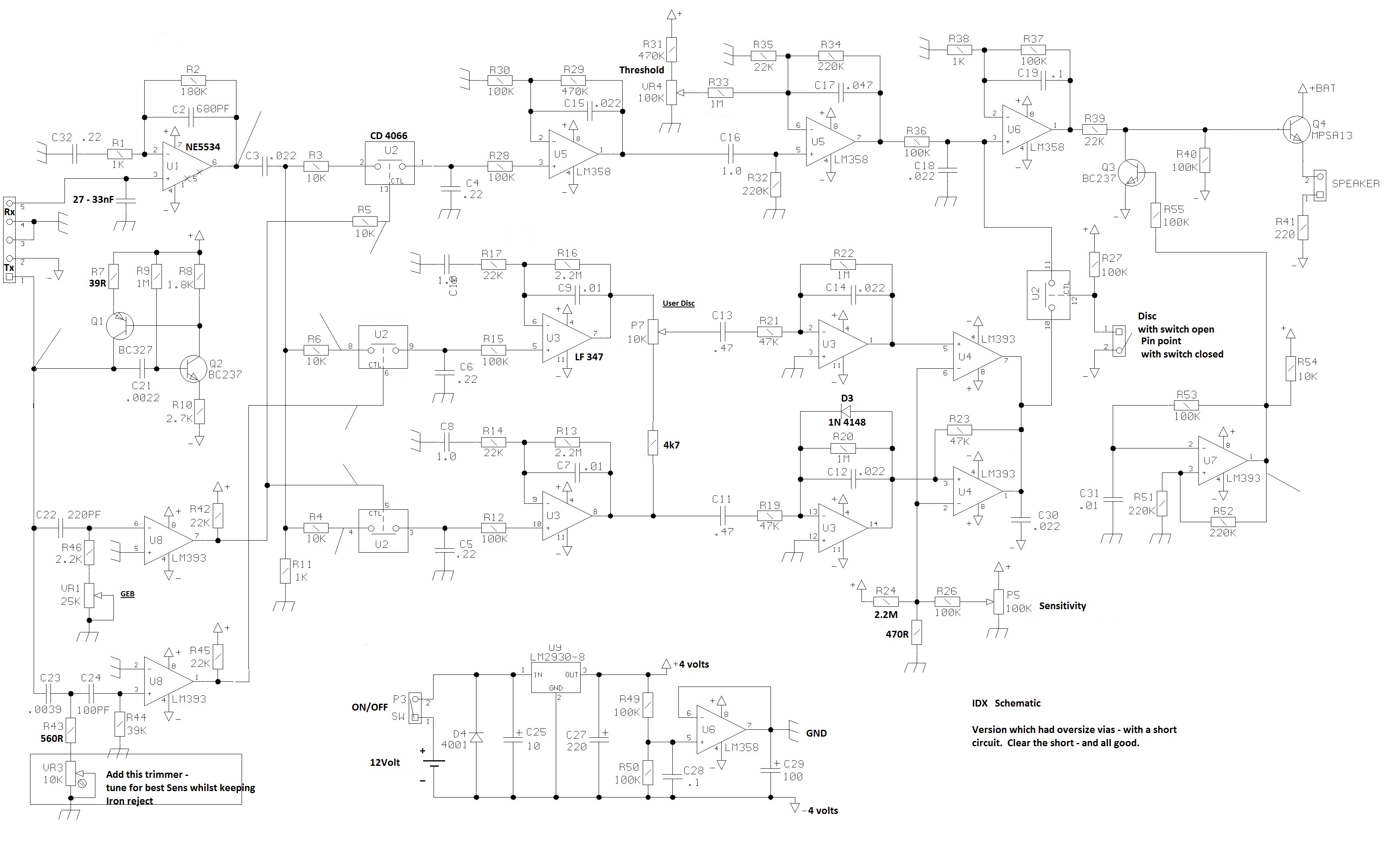

                            • Is this the correct version of schematic to compare with?

                              Also does anybody have it in sch file?
                              • yup. almost. just add Zener diode on outputs of the comparators.
                                typical mistake that you do not want fix and notice.
