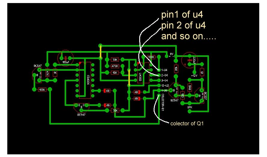

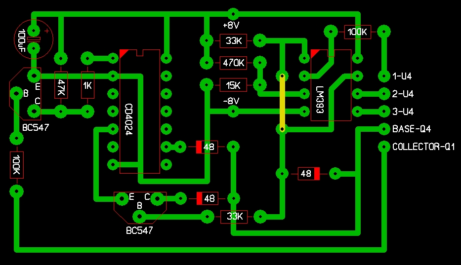

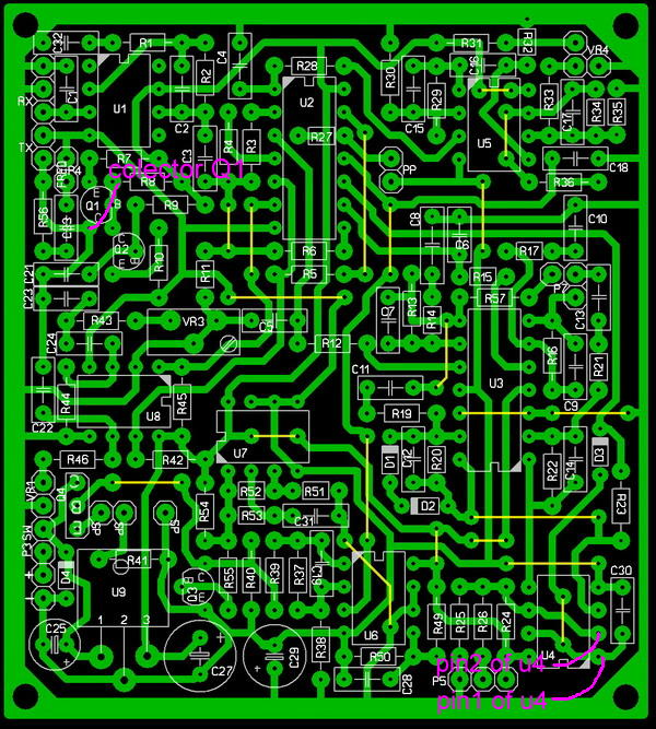

    • Hi all,
      Can anybody help me how do I connect my IDX pro to Eduardo's 2 tone board ( all from Silverdog).
      As you can see I'm not a pro
      Lax
      • perhaps this can help
        • This scheme is correct. The former does not. Look at the pin 5 of the CD4024.
            eduardo1979 Place the file here (lay)
            • 2 Tones
              That is correct.
              • Thanks a lot.
                I've thinked this as well, but I wasn't sure.
                Lax

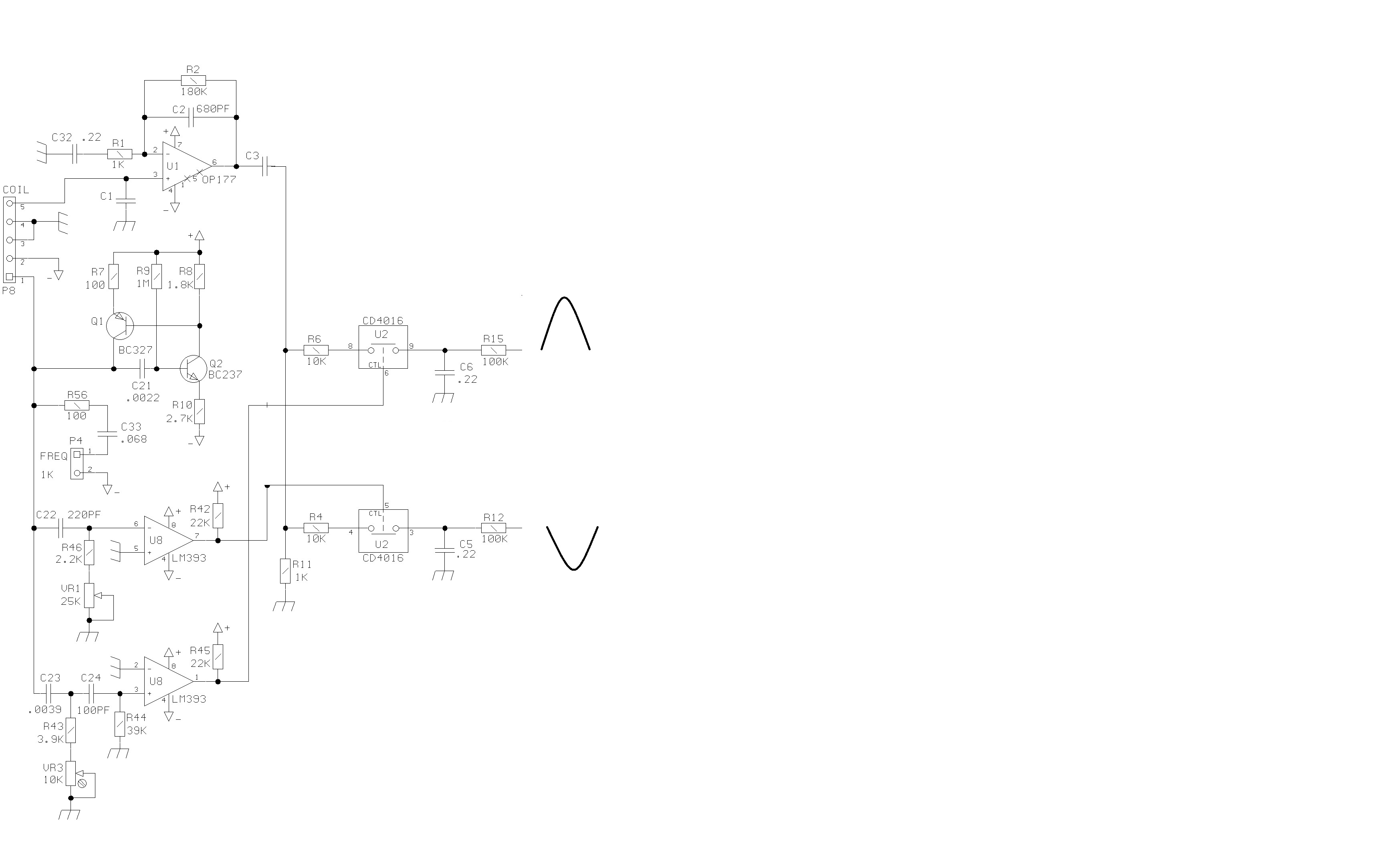

                      • Signals from DET
                        Looking at my IDx - it works well... -
                        when waving pliers at it....
                        The Disc/GEB detector signals are opposite is polarity - one up, one down. ?
                        Is this correct?
                        If these signals are going into a common comparator for triggering - both sigs have to 'trip' above threshold (both sig paths are AND - ed together) then the sig polarities should match - so seems wrong?
                        Steve
                        • pic
                          pic
                            Is this correct?
                            Yes. IDX and TGSL are single quadrant detectors, and they trigger only for both I (GEB) and Q (Disc) channels going positive (in this particular case, and that particular spot it must be both negative, the inverting gain stages take care of that). If you reverse inputs of the lowest comparator, you'll get a Fe discriminating rig.

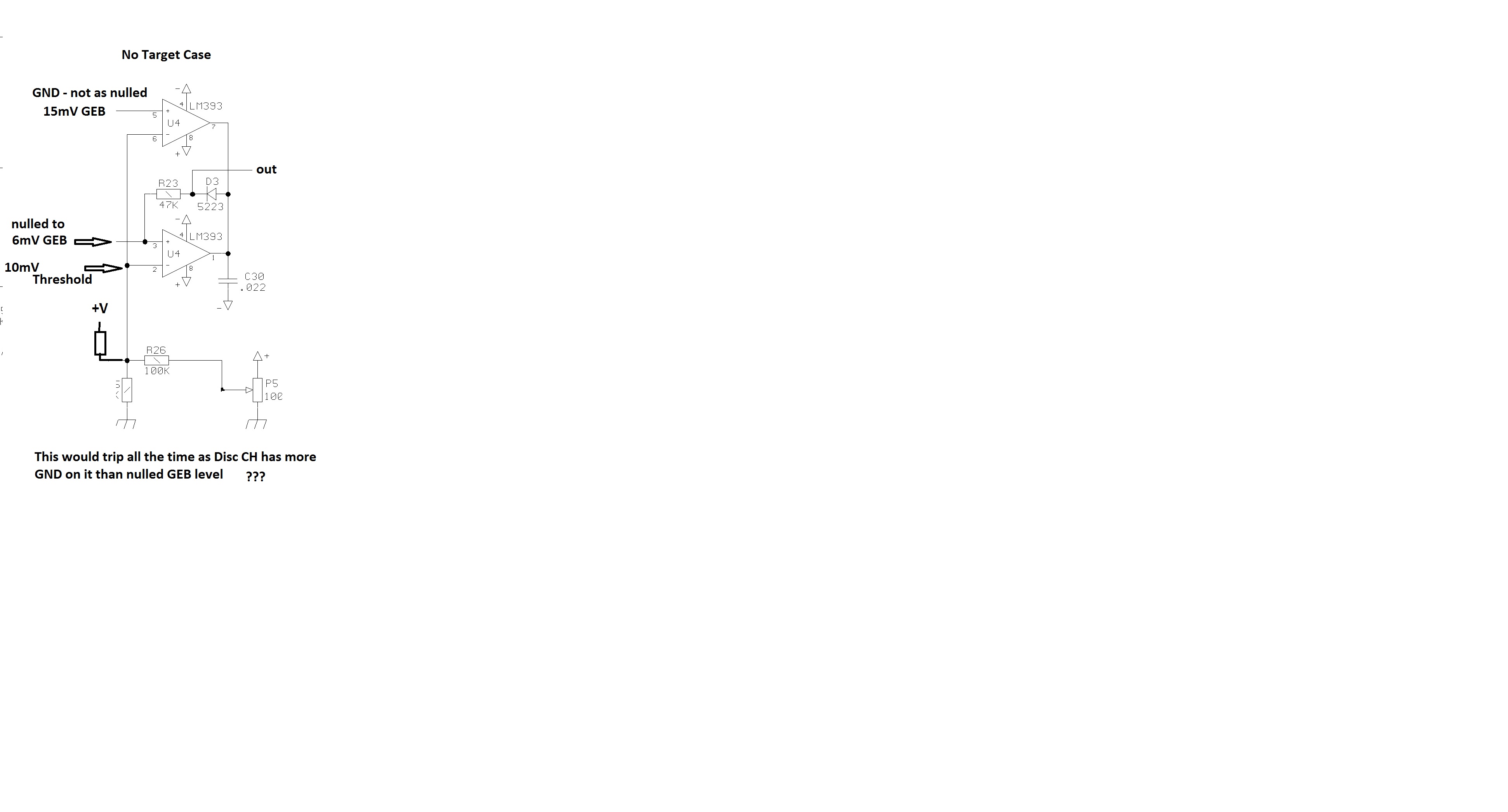

                            • In recent dicussion the Comparator stage on IDX was described as an AND function - having satisfied the amplitude requirement with both channels being over the common threshold.
                              When I look at this part of the circuit I see an OR arrangement. As either comp OP will trip tone..!
                              So Im lost here..
                              If One comparator output was High and the other low - the +dc OP would go thru the diode and put tone ON ...
                              Or is it the case that if one output is Hi while the other comparator output is low - The Low condition output sinks the HI from the other CH?
                              So both would need to be Hi.
                              Again I apologise for the dumbness
                              S
