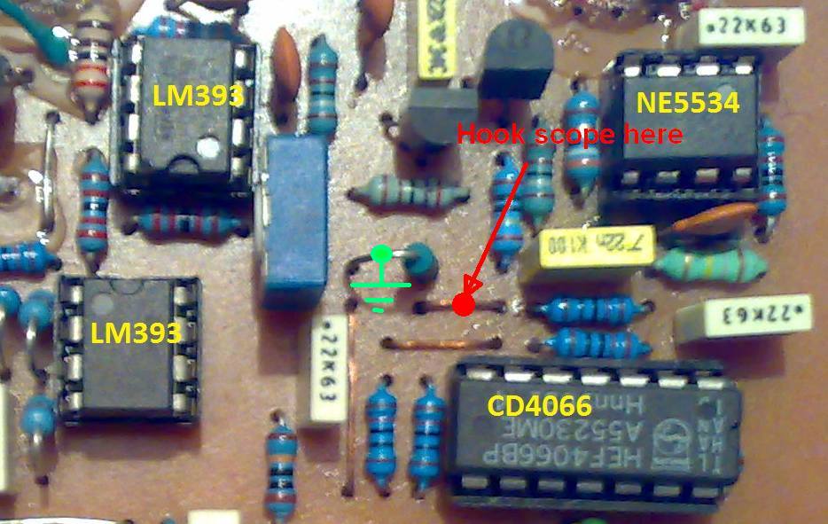

        • Originally posted by konan View Post
          This is PCB :
          Could you please try connecting your scope to a jumper as indicated on the attached picture and see what residual unbalanced voltage is found here. If under 100mV you're golden, and you can seek your problem elsewhere.
          Otherwise try to reduce this to as low as possible by carefully balancing your coil.
          Edit: I added a green ground connection too.
          • I measure value it is about 90mV...
            • It is good. Try extracting (one side of) R24 to increase sensitivity of discrimination. it is the blue one on your board next to U4.
