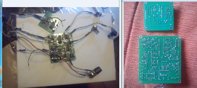

                          • It works perfectly and to the first jajajaj ,2 tones does not work tendre envestigar Or pondre vdi better:clap
Name:	26-3-2013 21.3.28 1.jpg
                            Thank you very much eduardo helping and to give me advices
