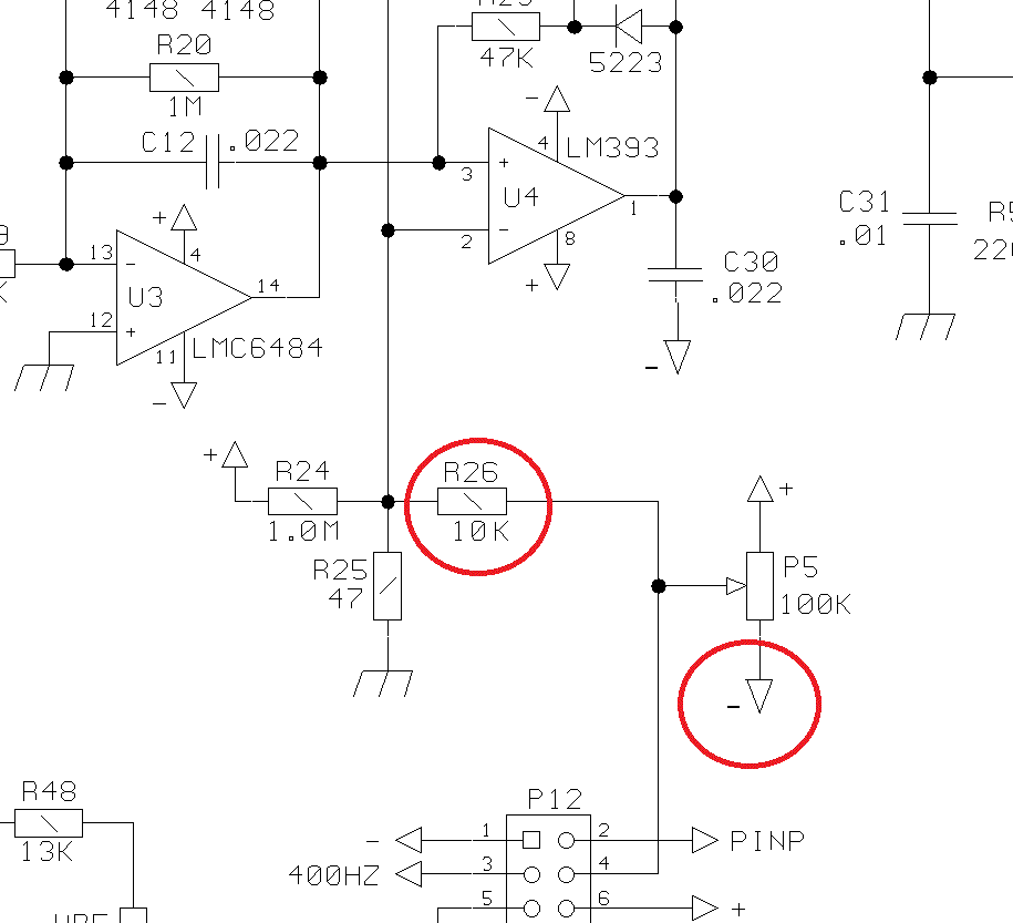

          • IDX MOD
            I finished the IDX kit from Silverdog, minus the VDI module as I do not plan on using it.
            Everything works fine, but I was looking for more. With the stock 9.5 coil from my XLT, I could only detect rings and coins to about 25cm. Then I realized that the offset on pins 1 & 14 of U3 was a mV or 2 below ground potential. The signal just has too far to go to trigger the inputs on U4!
            I am using the LM324 from the supplied parts from silverdog instead of an LF347. In looking at the specs for the LF347 is can have an offset as high as 5mV!!. With no way to adjust the offset of quad op-amps, I just implemented the same fix as I used with the TGSL. It allows you to adjust the reference voltage slightly negative so the LM393 can trigger earlier. This brings the detection range to 40CM for coins and rings,, the ragged edge of the detection range for the stock 9.5 concentric coil.
            This may be a band-aid fix and may be a symptom of another problem, but I'm not sure what. I just figured out a fix..
            Don
                  Interesting stuff. Can you please point me to the fix for the TGSL, I have just finished building it.
                  Thanks!

                        • Originally posted by joop View Post
                          Thanks!
                          This just allows you to adjust sensitivity as crazy as you want.
                          http://www.geotech1.com/forums/showt...864#post112864
