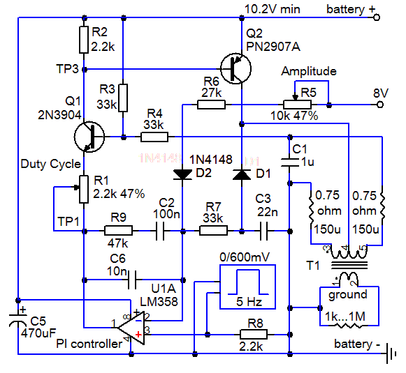

      Joop, it will be less sensitive to modulation of AIR&GND signal. I'm waiting you to show your SPICE analysis of TX.
      The SPICE circuit should simulate amplitude modulation of TX, which is very important problem for metal detectors. The TX modulation is caused by:
      1. Change of ground conductivity (resistivity). For this purpose, the SPICE circuit in my post #656 has an induction coupled loop (transformer T1) containing a resistor which value changes between 1k and 1M when TX coil passes over ground with different properties.
      2. Change of coil height (distance from ground). Coupling coefficient k of transformer T1 changes in SPICE circuit when the operator changes the height of TX coil.
      3. Change of TX supply voltage. In my SPICE circut this is shown as battery discharge, but this is not important process because the change happens very slowly. However there are quick changes of TX supply voltage caused by battery load. For example, if we have an audio circuit powered by the same battery as TX circuit, the TX supply voltage changes when loudspeaker beeps. We have a problem if this causes modulation of TX field because the demodulator sees the modulation of AIR signal.
      My above SPICE TX circuit also generates the effect of variable battery load because supply current increases when TX coil passes over more absorbing ground. Note that in post #656 resistor R5 is connected to battery voltage. The modulation by change of battery load is avoided in the attached here SPICE diagram because R5 is connected to a 8V constant reference voltage.
      The modulation of AIR signal appears as an interference, which the operator can not eliminate with GND knob. Let calculate for what small modulation index m_i of TX field we speak?
      Without TGT signal, in RX input we have for example an AIR signal 10mV. A deep buried or small target generates TGT signal 1uV. The TGT signal appears as modulation of AIR signal with an index m_i = 1uV/10mV=0.0001. To detect TGT with such small index, the movement of TX coil should cause modulation of AIR signal with an order less than TGT signal, ie weshould achieve index m_i<0.00001.
      To increase sensitivity of metal detector, the circit should:
      1. Suppress amplitude modulation of TX. That means TX circuit should contain an automatic controller to maintain constant current amplitude in TX coil.
      2. Balance the AIR signal in RX input. This can be made with an ABC - automatic balance control, which slowly eliminates all signals in input of preamp.
      3. Suppress the GND signal in RX input. This can be made with TWIN LOOP RX coil configuration. Two RX coils in opposite direction can also suppress all interferences generated by remote sources because signals are subtracted.
      4. Increase the amplification of preamp near to saturation in output. This can be made with AGC (automatic gain control) widely used in radio receivers.
      Here is the TX circuit with increased power.

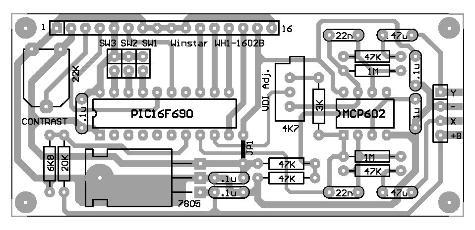

      • “Display sized” PCB for VDI (16F690 version), standard components
        • Very Nice Tepco. Be cool if you could make one pcb the used either the 16f690 or the 16f88. Maybe with some jumpers. I might play around with Eagle.
          • Nice job Tepco
