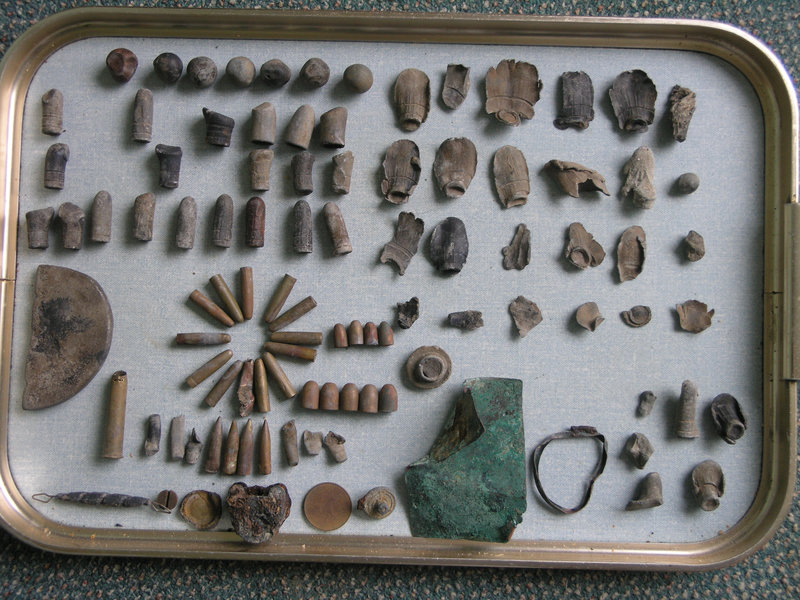

                  • Had a good couple of hours out with homemade IDX (original silverdog board no modifications) with a stock 8" concentric.
                    Not had much success in the past over wet salt beaches. Started to use a different pair of headphones and the good and bad tones are much more pronounced. Ground balance over the wet ground was just pass the range on my potentiometer (will have to adjust this) and searching in all metal mode then testing in disc mode if the target is iron. Keeping the coil the same height from the ground and searching in all metal mode the lack of ground balance did not make that much difference. Most of the finds were from an area about 20 foot by 15 foot and not much junk dug

                    • Hi, awesome colection of military items! thank you for your feeling tone detector seems to work well.congratulation.

                      • Good little haul.
                        Was this on fairly wet salt sand - if so you did well - these cant really run on wet sand. Drier sand and dry sand is fine for these, as is clean soil, and short dry grass.

                          Yes very wet and some from under a few inches of water in rock pools.
                          Still can't work the area where the very dry meets the damp (jumps all over the place) but the the fully wet is very doable.
                          Could not work any very small pools as the edge of the water to the sand gave a signal.
                          Floating the coil on top of the water and moving the coil very slowly gave very good results. The old 10p came from under 3 or 4 inches of water.
                          Could not ground balance over the wet sand out side of my range. But by moving the coil very slowly slight up and down movement are noticeable in all metal mode but easy to deal with as soon as you over a real target it really jumps out I just had to slow the sweep speed right down.
                          Once over a target switched to disc and only moving the coil a few inches from side to side listen for a clean tone.
                          Normal sweep speed in disc mode pops and squeaks all over the place.
                          The old padlock was the only iron I dug and this was a slightly iffy signal
                          one of the 9mm FMJ gave a slightly iffy signal that I probably would not have dug but noticed it was sitting on the ground
                          Majority of the finds were from a tight area did walk either side and the finds were a lot more sparse. Ground was slightly different think it had been dumped from somewhere else in the last storms
                          Strange range of dates musket ball to WW2 ignoring the old decimal coin that was from about 50 yards away
