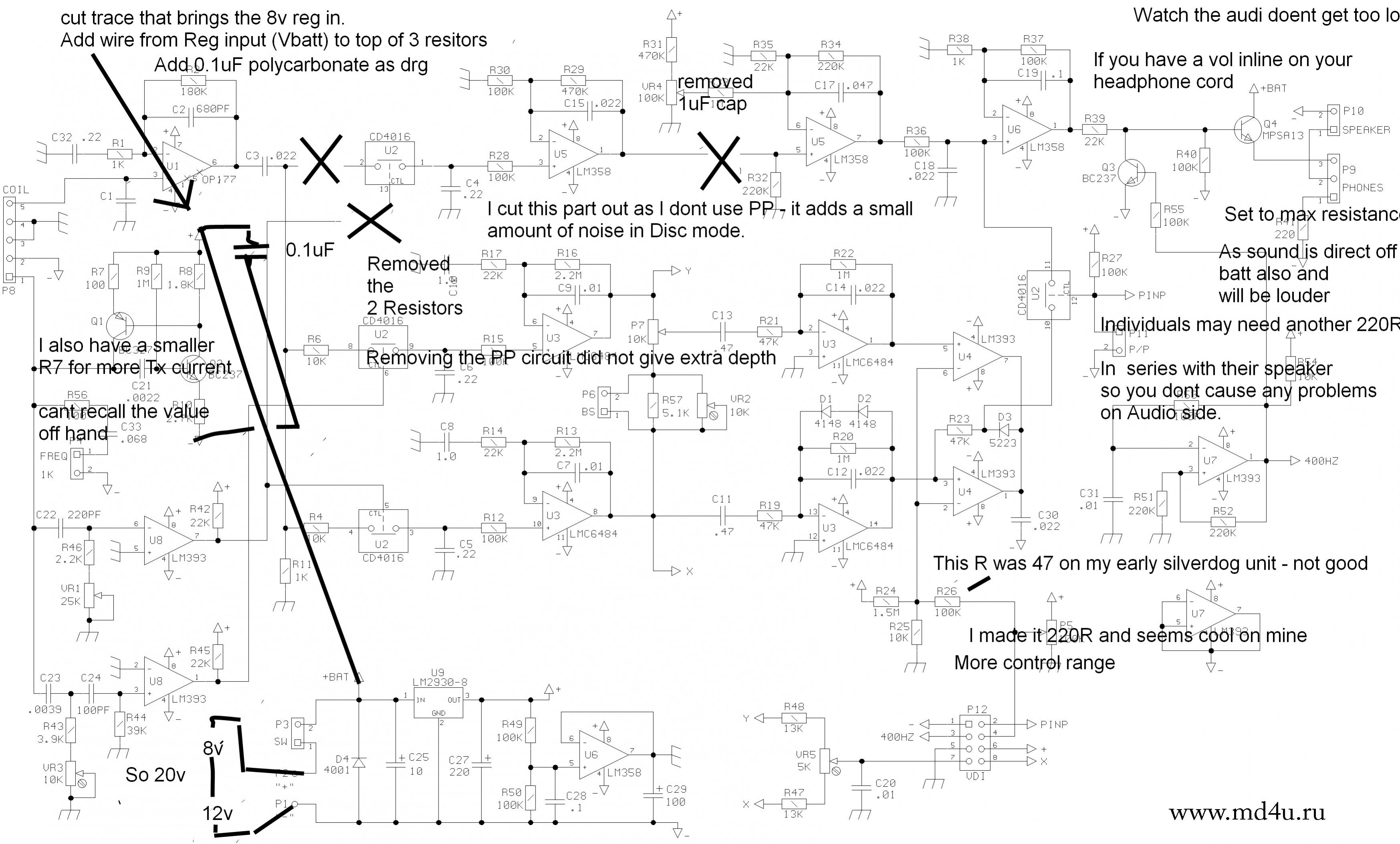

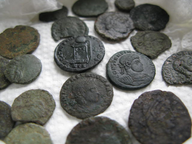

              • 2 Minor IDX mods
                1)My kit was supplied with a 47ohm in the Sens resistor chain (for setting the tone trip level) I always felt that in use it had too little range or throw and chatter was issue especially on damp grass.
                I fitted a 220R and this gives 9mV at full throw of the pot. Sits nicely mid point (~4mv) with less chatter - good mod for my unit.
                2) I cut a trace to the Tx osc supply and fitted a switch so I could toggle between 8V reg or 12V direct in use.
                I arranged coil height over buried target to almost loose valid signal - so only a one way tone on 8v.
                Flip tthe switch to 12v and it repeatadly restored the 2way valid tone.
                Minor but tested valid mods.
                Some roman with these mods.

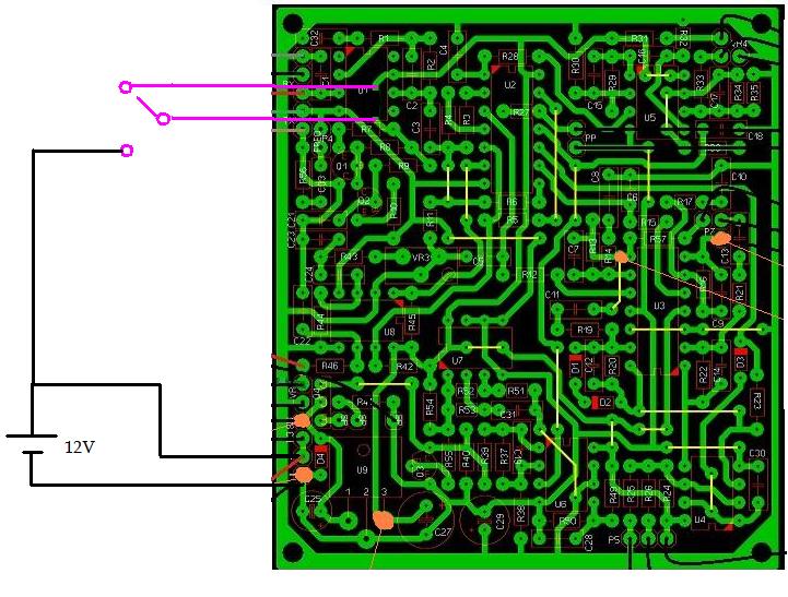

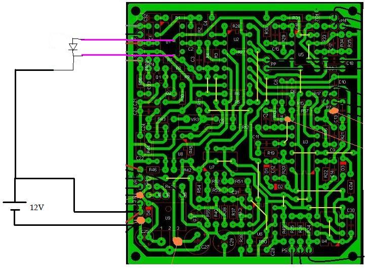

                  • Nice!, but I`m not sure if I understand well. Besides R25 47Ohm You put 220Ohm or potentiometer resistor to indiwidualy adjust U4 like Eduardo wrotes earlier. And You increes Tx voltage adding just one switch like this:
                    Soe if oscilattor works better with 12V, for what is this switch? Maybe it can be done separating others components from 12V adding a 4148 like this? :
                    How much power consumption raised?
                    My IDX now works like this (sory for the quality):
                    http://www.youtube.com/watch?v=2VksAet3jHw
                    http://www.youtube.com/watch?v=-j4Vtx0RjSI
                    This coin has 15mm diammeter, and it is burried at 28cm (11'')

                      Great results -- I'm always amazed at the number of Roman coins to be found still. Must be exciting.
                      -SB
                      • Riev - the switch was there to allow a two condition test.
                        I cut the trace from the 8v reg to the Tx cicuit, so I can wire higher volts to Tx. The 8v (+/-4v) still powers all other circuits as before.
                        While over real target I could flip from 8 to 12 to see if there was a change. There was a minor improvement.
                        When I realised it was better with 12v I removed the switch - I ran from 12 v direct to Tx - Via an on/off switch as before.
                        That was that.
                        I added 8v to the 12v in series to get the extra depth. This meaqns the Tx is 20V and rest of ccts run off the 8v (+/-4v) as before.
                        I also removed pinpoint circuitry, as I do not use and it adds noise in Disc mode.
                        S
                        • Hi Simon yes you would think it would be exciting.
                          The first one floors you.
                          After 10 its ok, I know a guy who gets over a hundresd a year and gives them away.
                          I would love to get a silver Denarious, or GOLD coin - I have had 2 silver aincient coins but no GOLD. Im ready for GOLD.

                          • All, Im not saying go do these mods. Im saying I did them and they work well on my machine.

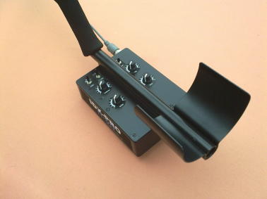

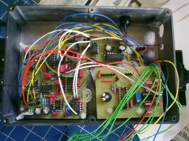

                            • My new IDX
                              I have made it with the 2Ton mod. I got two tons....but not different tons for ferro-non ferro. I switch to 1Ton...and every metal gives a deep sound. I switch to 2Ton....and every metal gives me a higher sound.
                              can somebody tell me where i can beginn to search the mistake?

                              • Originally posted by Schatztaucher View Post
                                My new IDX
                                What is your disc. pot position when you check 2tones? For example it is the same reaction for different metals when you turn disc at "0" or "5"? At "0" will by signalizing all metals with higer sound which is normal.
