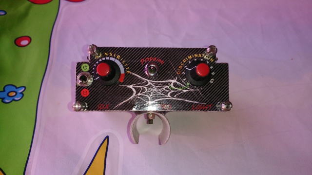

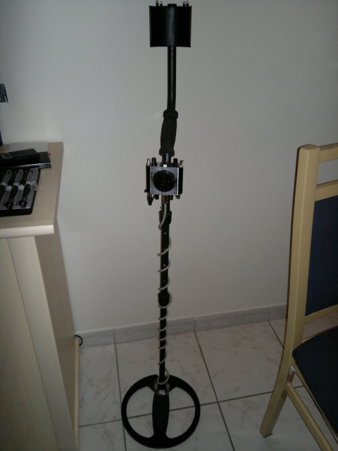

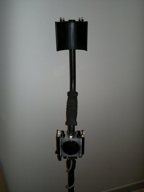

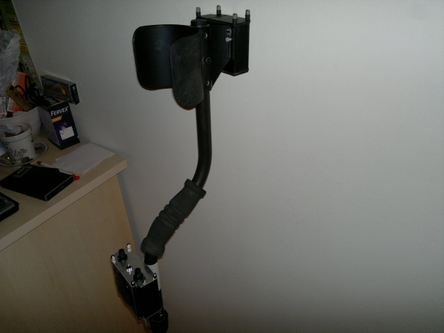

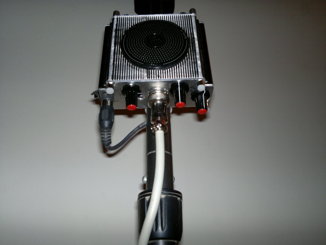

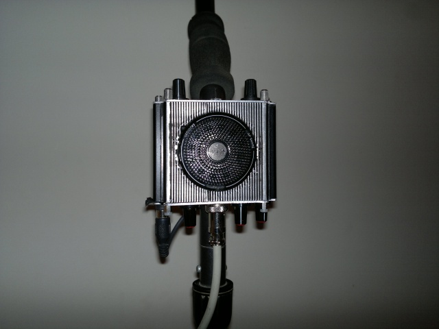

  • hello, here is the front of my idx pro and a picture of the complete assemblyClick image for larger version

    • What fitting did you use for the length adjustment?
      • ashefr10 if it starts to rain, the water will flow directly into the speaker?

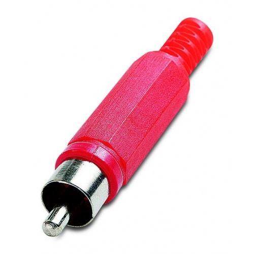

        • Hello , for power Click image for larger version
ID:	337442 and for coil http://www.loisirs-detections.com/fr...reign-266.html
          • my speaker is waterproof
            • These speakers have a mylar cone and will take water splash.
              Conventional paper cones turn to mush.

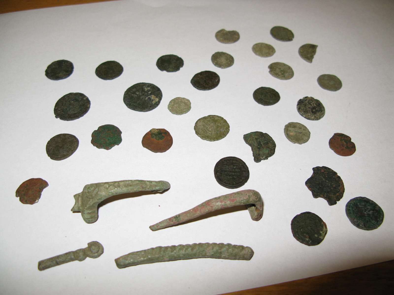

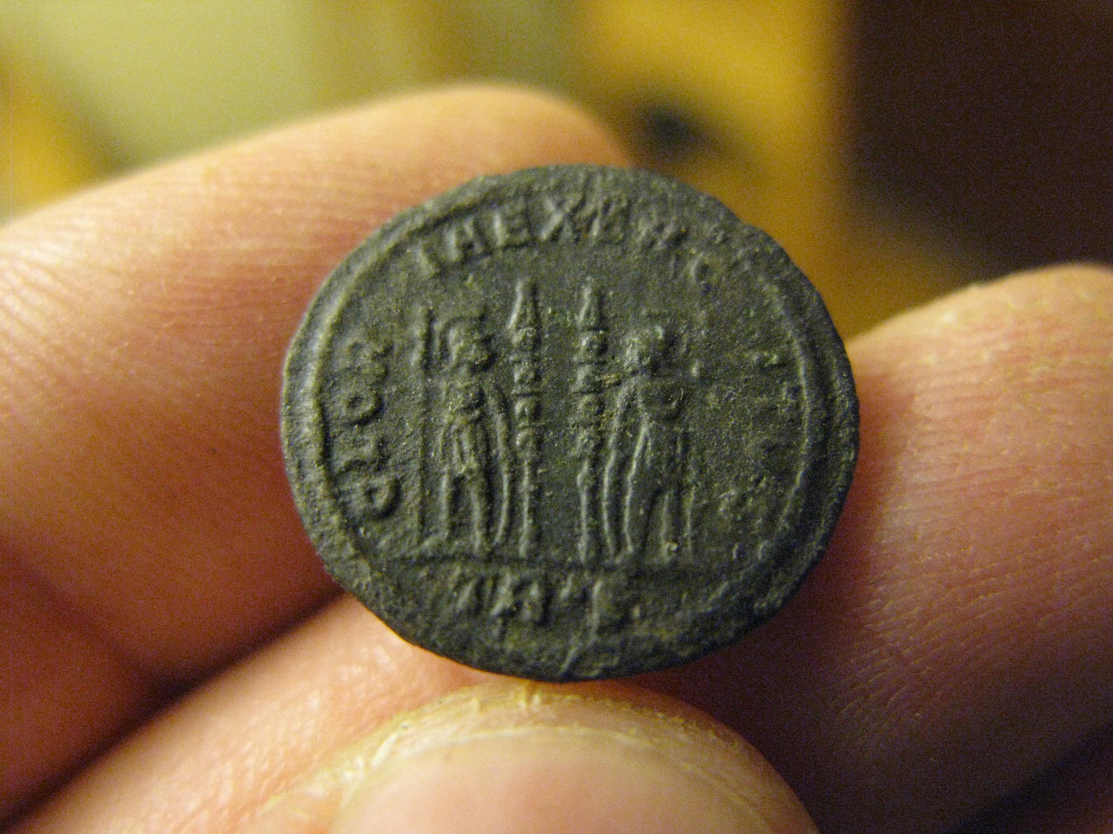

                            • Roman action with the IDX
                              A weeks coins/brooches.
                              The result of some very enjoyable detecting/amatuer archaeology on a previouly unknown roman settlement in uk. The likes of which I wont see again as most sites are stripped. All of these and other finds are gps'd and will be going to the local FLO for record with the land owners grace.

                              S
                              • Nice and that`s the reason why we made own MD`s.. for satis-faction..
