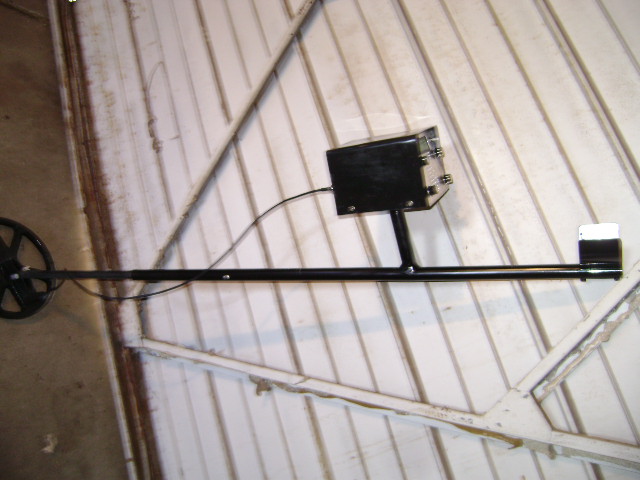

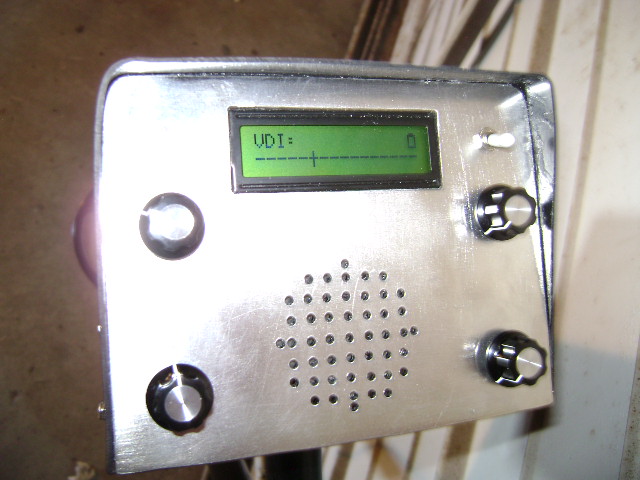

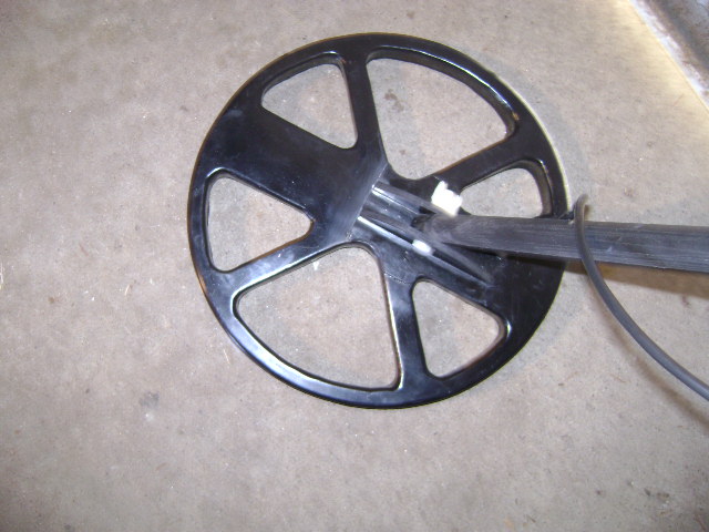

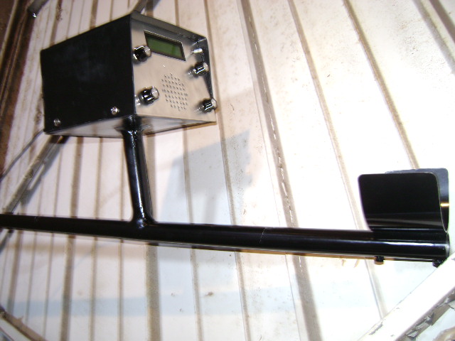

                          • IDX/VDI
                            Here is my IDX. Perfect discrimination, depth about 32 cm air test. Vdi gives a repeatable metal indication with steel, iron around 0- to minus 5. foil about 10, penny 25, US quarter 55. I still have to do adjusting to VDI board, I still cant get the pot to zero in. Im going to test it this weekend out on the farm. , I took some pictures, but I forgot hove to upload them.

                              • Originally posted by Wiltran View Post
                                Good Job
