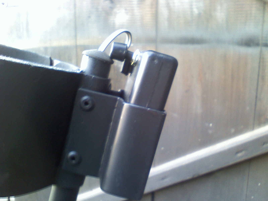

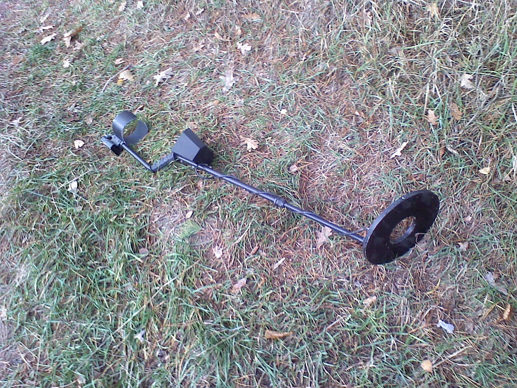

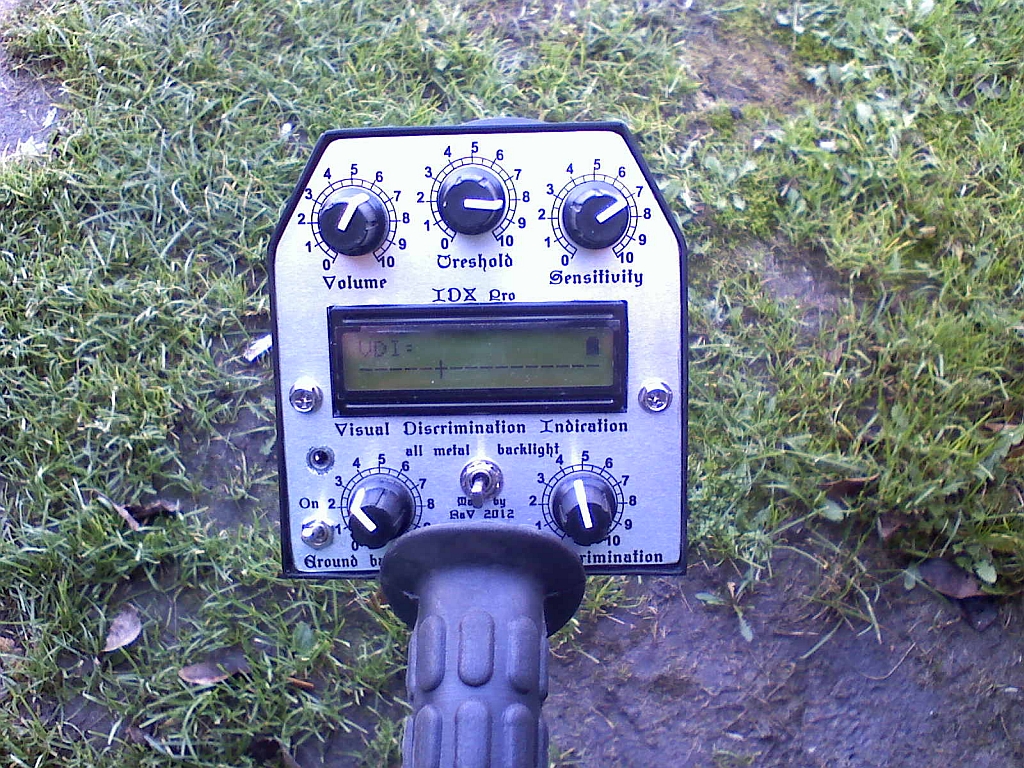

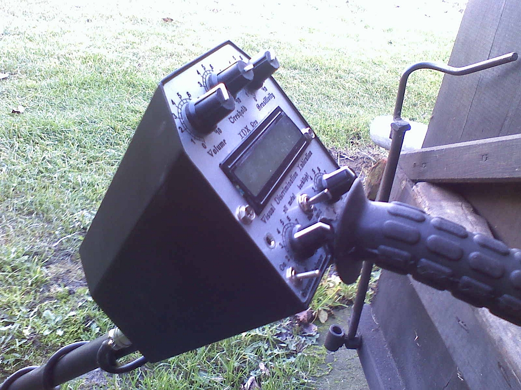

                    • My machine
ID:	333957Click image for larger version
ID:	333956Click image for larger version
ID:	333958Click image for larger version
                      Everything except pure range of VDI works fine.
                      Special thanks to
                      Eduardo,Ropcsika for help.

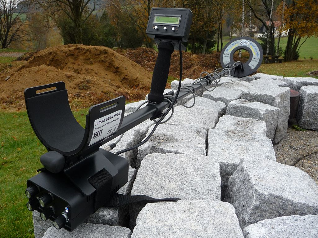

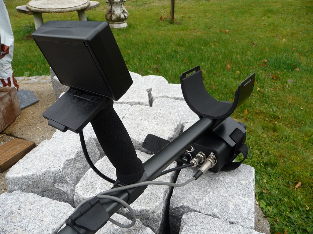

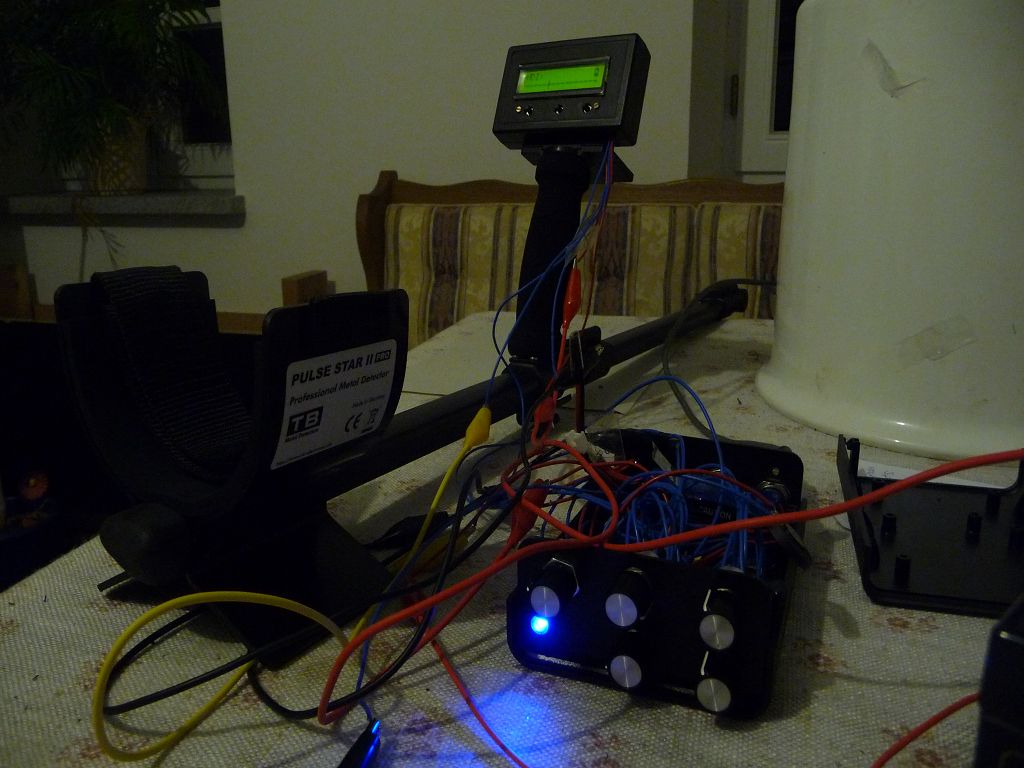

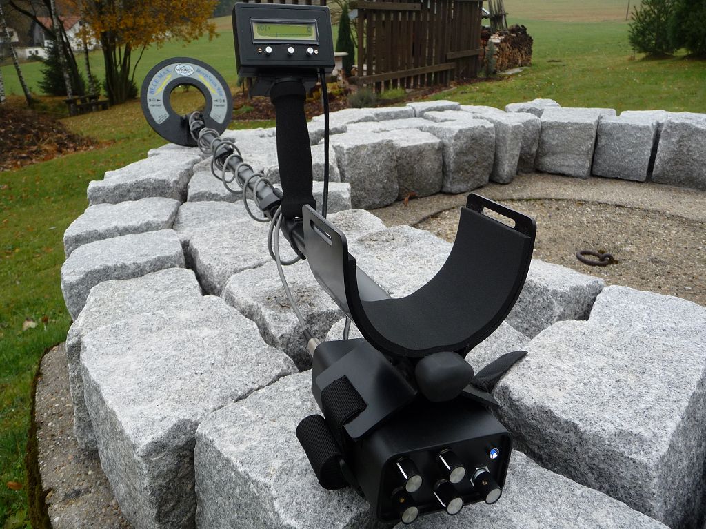

                          • Hi, nice work !!! here are some pictures an videos from my IDX Pro, but without Button label
                            https://www.youtube.com/watch?v=qfcH...&feature=g-upl
                            The idx is a very good detector, but i believe the disc could be a little bit better !! when i search with my idx on field there a many faulty noises from the DISC when he detects iron! so is it possible to improve the disc ?
                            Firebox
ID:	333969Click image for larger version
ID:	333970Click image for larger version
ID:	333971Click image for larger version
                            • Originally posted by Firebox View Post
                              Firebox
                              Hi Firebox,
                              I have some questions for you:
                              1. Why does your IDX-PRO have a label on the handle that says "Pulse Star III"?
                              2. Where did you buy the nice control box that is under the handle?
                              3. Where did you buy the triangular section telescopic stem?
                              • Hi @Qiaozhi
                                the case for the idx is a german Eurobox:
                                http://www.reichelt.de/?ARTICLE=5043...FVC7zAodm2IA9A
                                The Label Pulse Star III is on it, because the Detector shaft is from a manufactor which builds PI Detectors. But you can buy ONLY the Detector shafts from this dealer
                                http://www.tb-electronic.de/start/index.html
                                so this is the answer of your question 3 too
                                Hope you like it. On youtube you can see more of my projects for example Lugatek VDI an Geotech VDI
                                Firebox
