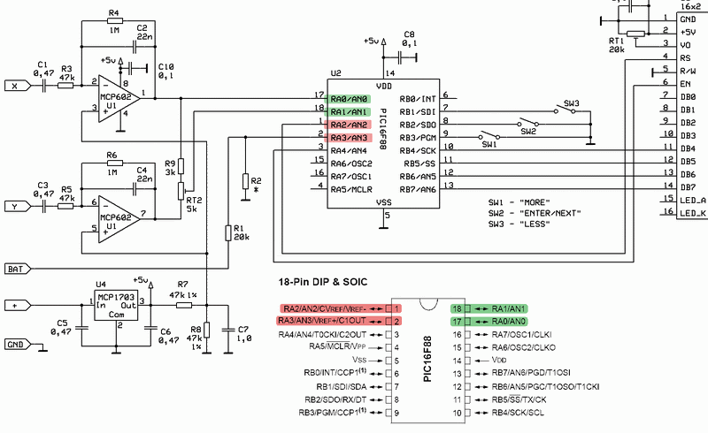

  • Is this the correct cct for the VDI ?
    • My Whites IDX-PRO.
              Yes, it is.

                    The 1uF TX tuning cap is not shown in the schematic.
                    Also, what is the purpose of P4?
                        The P4 is the Threshold and this potenciometer is very necessary. This potenciometer must be put on the front panel of the metal detector. The Threshold influences the PIN-POINT and the detection in mineralized areas to eliminate false signals. The 1uF capacitor is not because the PCB is mounted inside the search coil with 33nF capacitor.

                          Hi Eduardo,
                          can you please explain that sentence for me as I simply don't understand (too long in Germany!) exactly what you wanted to say, sorry.

                              I think he means the 33nF capacitor is inside the search head, and not on the PCB. Therefore it is not shown on the schematic. If I'm wrong, then Eduardo can explain further.

                              Eduardo - The P4 potentiometer is labelled "Freq" on the schematic, and it appears to be fine tuning the frequency of the TX oscillator. How is this related to the Threshold? I don't understand.
                                The P4 in the scheme is to adjust the frequency as long as there are 2 metal detectors looking for the same type very close to each other. PCB is the Threshold p4. I did not know what you mean, a PCB or electronic schematics.
