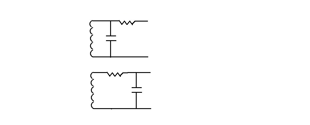

      The series resistor is to fine adjust the RX phase. It also raises the Q of the coil. Nothing to do with nulling. Which is mechanical. White's did put a high mega ohm resistor between the TX and RX windings which I never understood. I guessed it was for static dissipation? Maybe nulling.
      Make your windings matching the inductance then add a resistor in series with the RX to equal the original total of 111 ohms.

            • The bottom one will be wideband (low Q) low R low output more BW
              Top one will be narrow band (Hi Q)

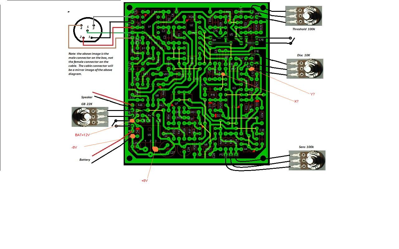

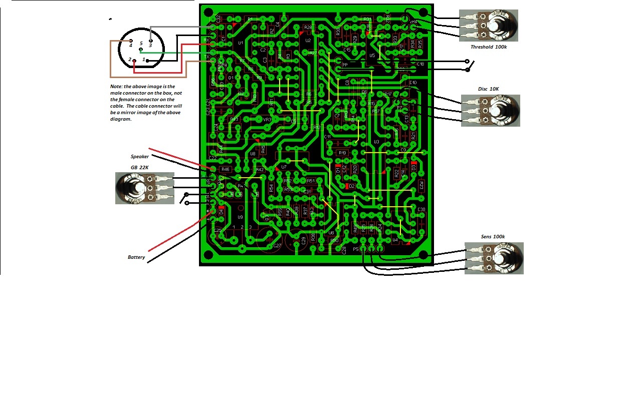

              • IDX Quick connect diagram
                Don

                      • would someone please check the connections from the vdi?
                        Would be super nice if someone would check the connections vdi ....
                        Many greetings marc
                        • Looks rightly.
                          • many thanks!
