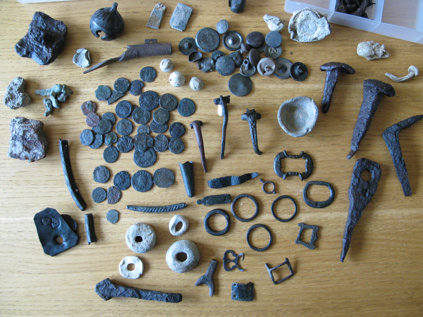

      Some finds mostly roman and medieval from the summer while crops off, all being catalogued through my finds liason officer. (I would have doubled this with a deus!) but I enjoy the fight with the simple machine!!

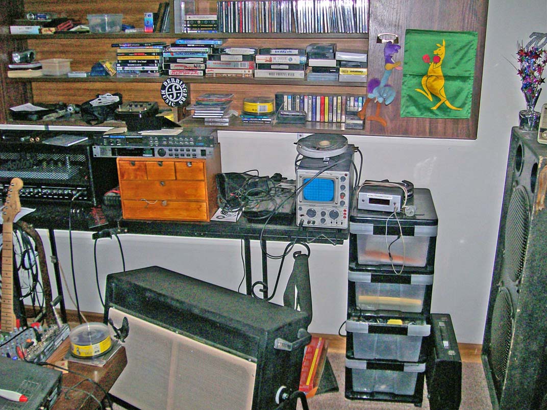

        I do have an old but little used Scope ,But I will need some help to get it doing the job as I only used it on Audio etc I also have a signal-gen Click image for larger version
        NOT sure if this older type will do the Job????
        Thanks for your Help ,,BARRY

            that should be fine barry, a scope is better than no scope.

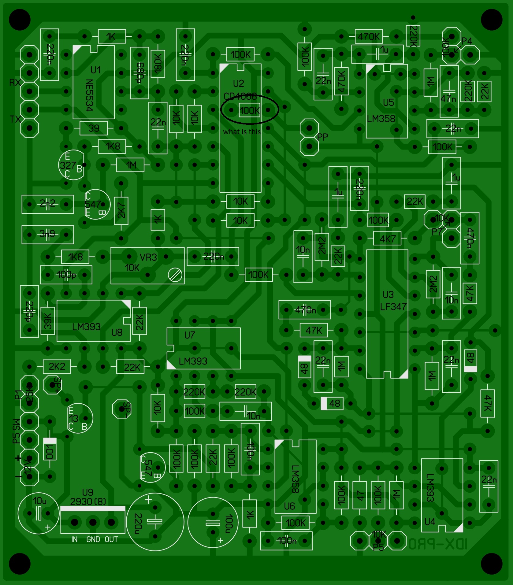

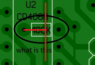

                            • hi can any one explain what is goin on this board have 100k but not connected
ID:	338915It would go on the bottom side and it is connected.
