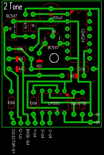

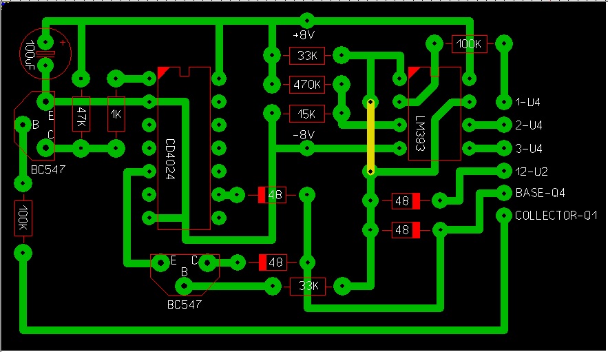

    • guys I need the pattern right for the 2 tones, you can post it? thanks
