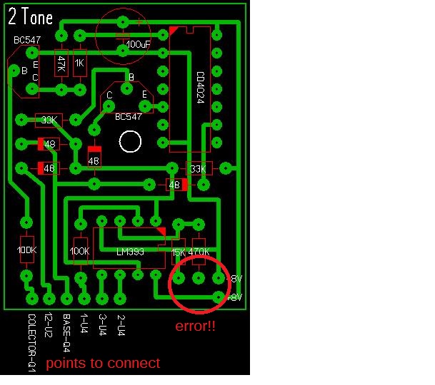

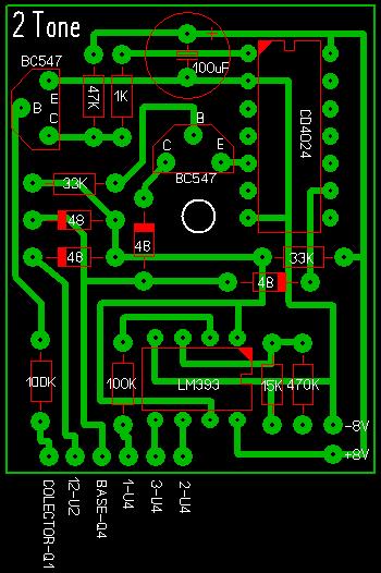

  • Hello guys, I wanted to build me the pcb for the 2-tone, that's the model I'm Following?, What And another, in what points I connect to the pcb IDX pro?
    [attach] 29128 [/ attach]

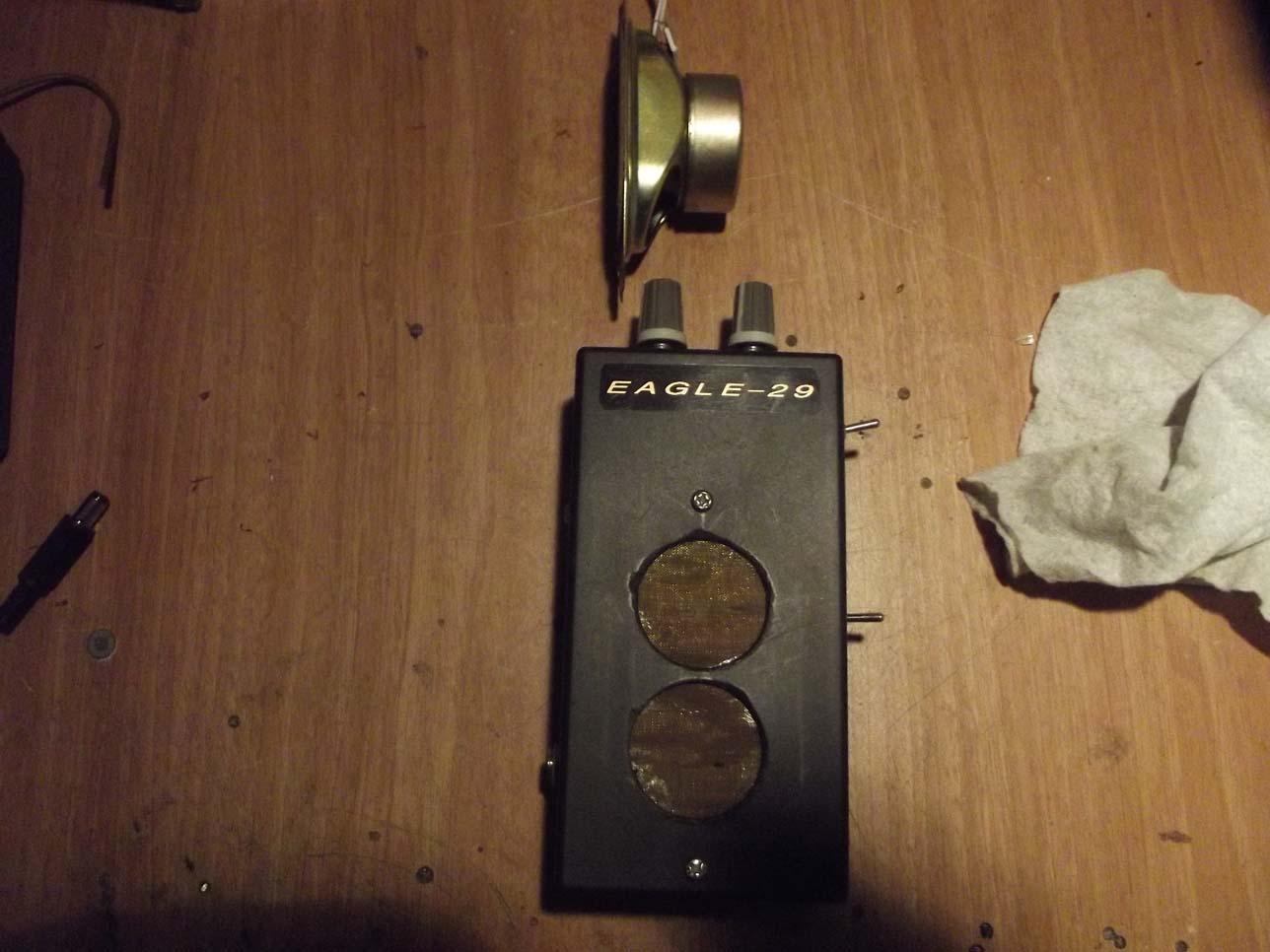

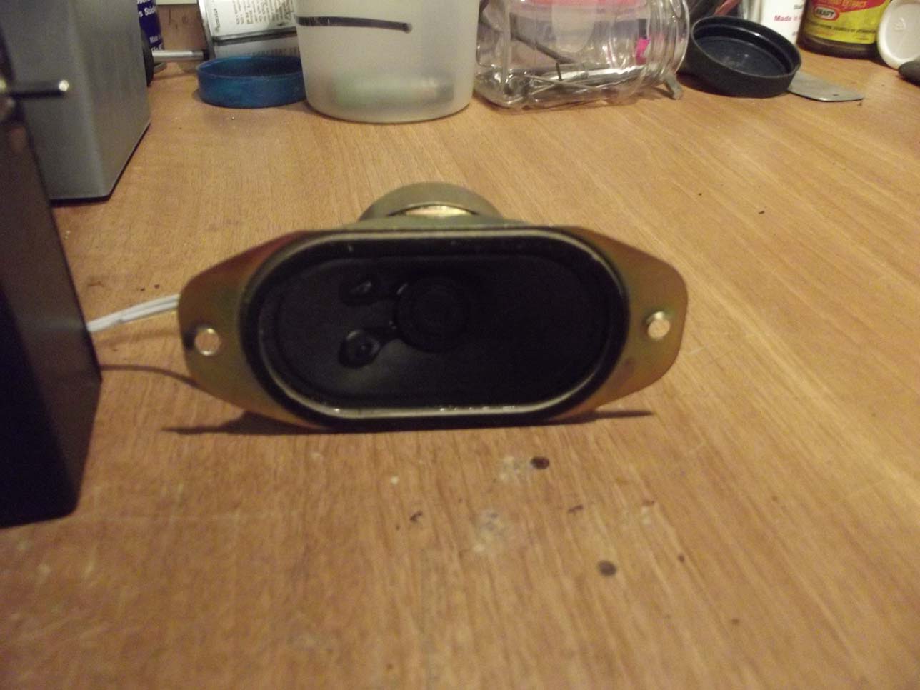

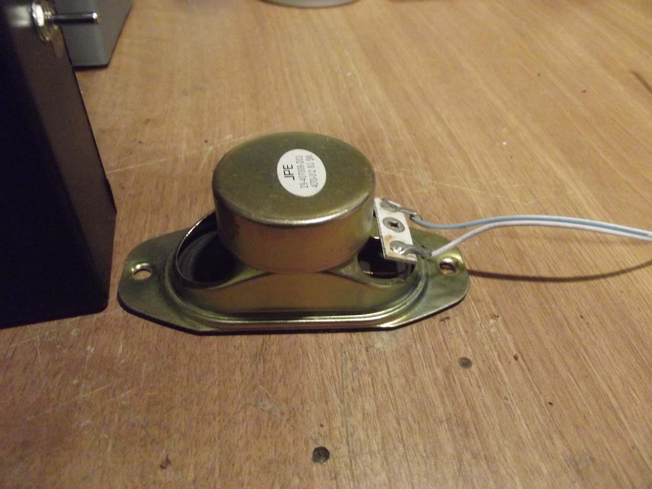

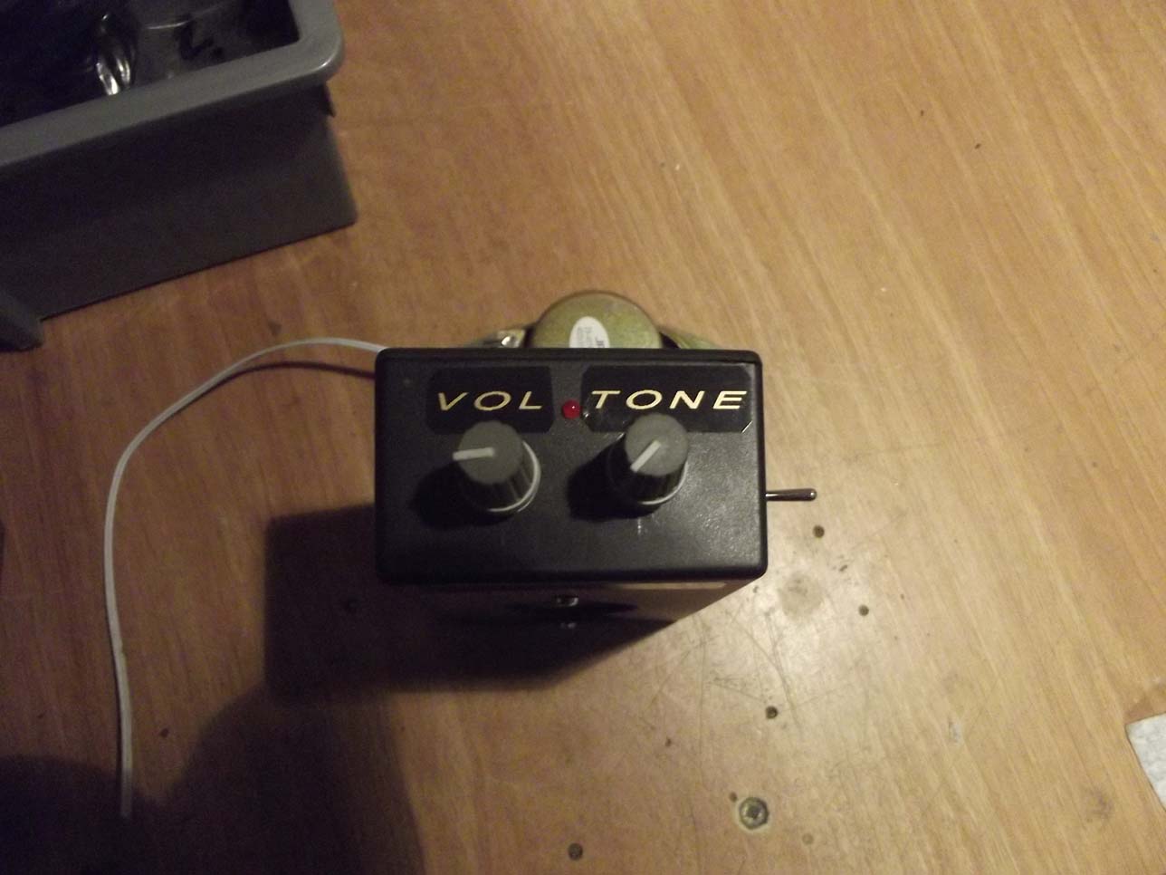

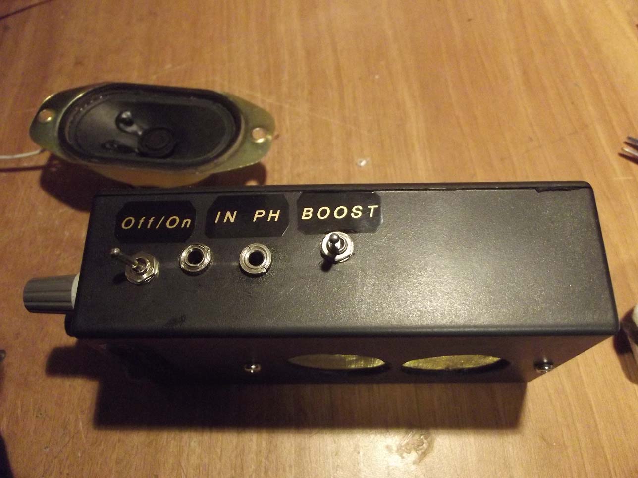

    • POCKET -AMP -SPEAKER -FOR-MY -IDX- ETC..
      HI TO ALL ,, I have been away [Not M/Detecting]-''BUGGA'' ..
      BUT I have tested it & its Very good IMOP. on the Ground I find the DD-Coil best ..
      Yesterday I built -up a Pocket amp -Speaker to use inplace of H/phones [at Times] ..
      IT is based around the LM386 Chip ,Runs on 9v -15v [this one has a 9v batt inside & a Socket for exturnal PWR if needed..
      I added a treble Tone lift pot & a Boost-switch ..Phones socket -LED to remember to turn-off-HA.Haaar..
      Easy to build just the LM386 which I had here a few resistors & caps ,See the speaker I used 1 of 2 from a wrecked little TELE..8 ohms..
      CHEERS fOR NOW ,,,,,,,,,,,BARRY..Click image for larger version

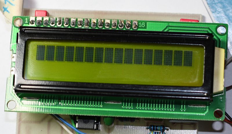

                      • Hello,
                        Today i connect the lcd to IDX but i only see this !
                        whats the problem ?Click image for larger version
                        • @ compadre
                          perhaps problems with the PIC !?
                          • You have power and contrast but no comm from pic to lcd.
                            Check pins 4,5,6 and 11,12,13,14 especially make sure 5 is grounded.

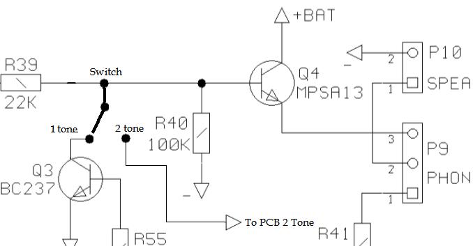

                            • @ fabio-evo
ID:	339988 you can do this......
