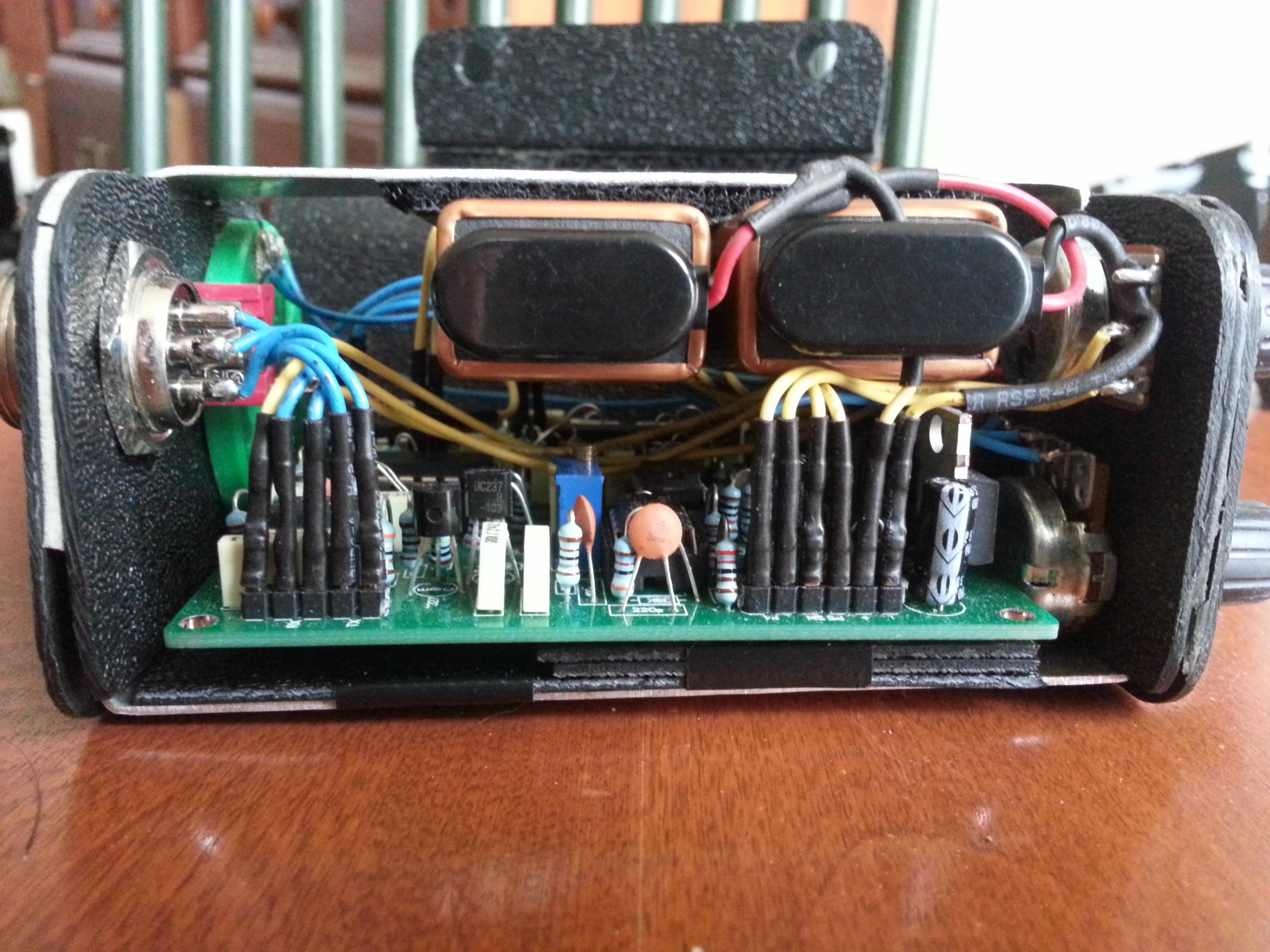

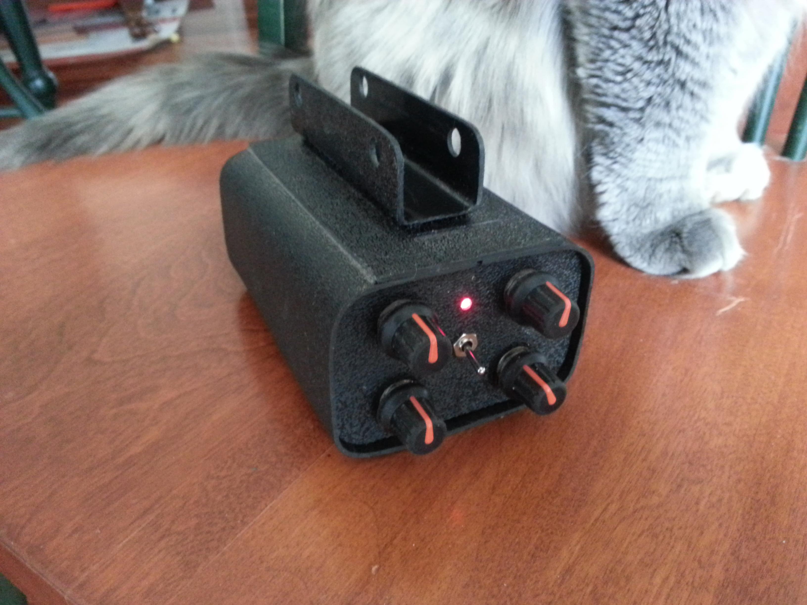

        Nice pictures Don. Did you build the enclosure or re-purpose it from something else?
        If it is from scratch could you give some construction details on building the enclosure? Maybe on it's own thread since it is off subject.

            Hey Jerry. It's made from thermoformed plastic, heated and shaped. Same stuff I use for making coil enclosures.
            Don.

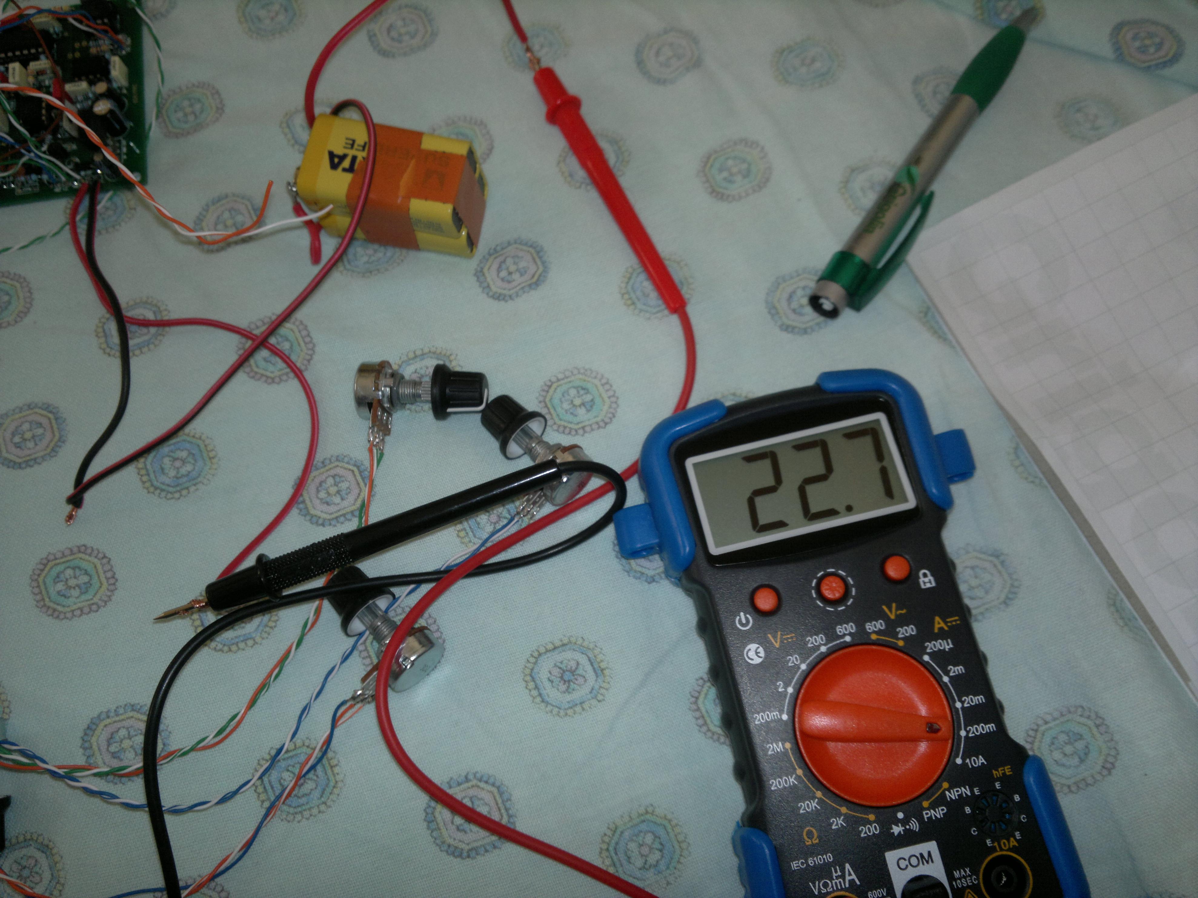

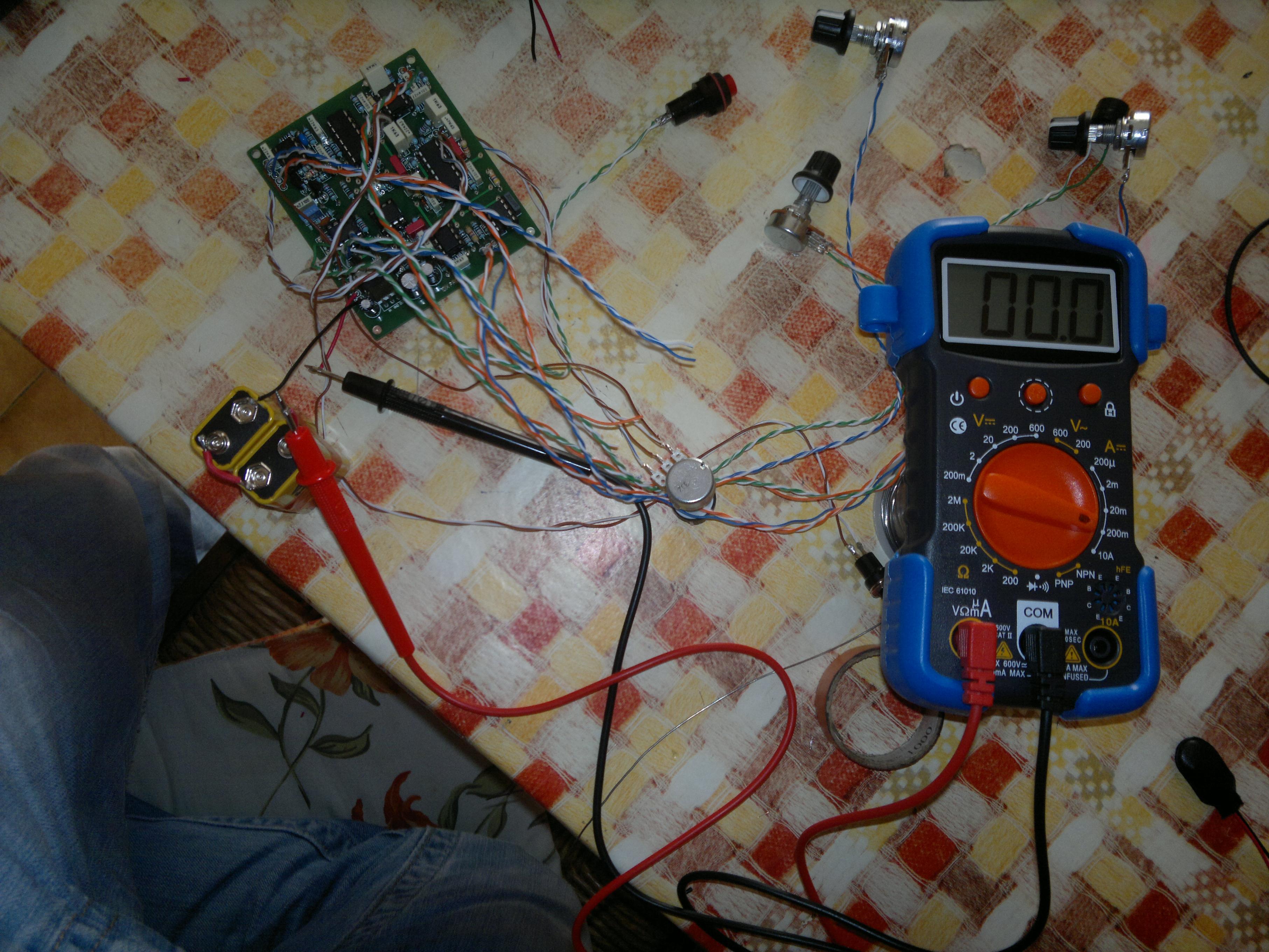

              • hello guys I 'was advised to measure the absorption of energy' cause I have a problem 'if I measure the right things?' cause I do not understand from a value of zero on the multimeter

                • keep the wires to the pots less than 100mm.
                  12v is Normal supply
                    thanks, now shortened the wire potentiometers, meanwhile I made this measurement, and 'normal according to you?
