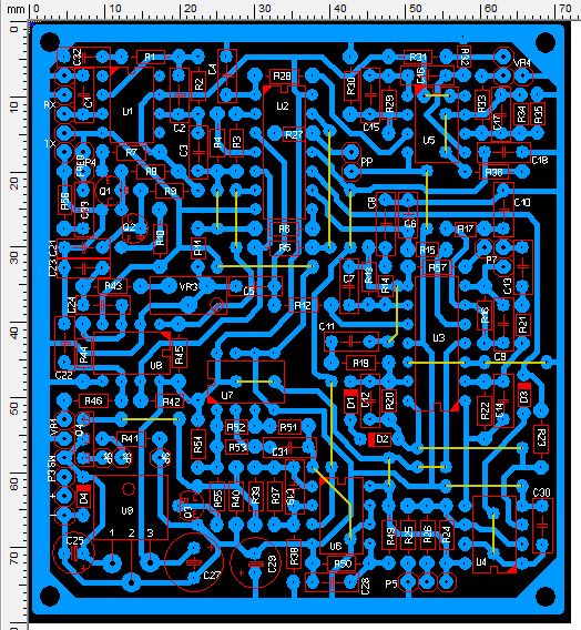

  • Well That's the problem. This board has been attached a few times but never the other side
    or files. So a bit of work to redraw it...
    • since lots of people have asked for the reverse of that board, and it has never been posted, it may be easier to blow up pics of the top side, then do the same with the top and bottom of the thru hole idx board, you could extrapolate the reverse of the smt idx board that way.
      its a lot of work, but probably quicker and easier than getting the original posted.
      • Well the other question I have, that hasn't seemed to be answered yet either is,
        what are the dimensions of SilverDog's PCB? I have a detector that I want to upgrade
        so the new board has to be a bit small to fit in the current housing.
        That SMT one would be nice but too much work to redraw...

              • The layout files show about 70mm by 80mm about 3" x 3" that's pretty small!
                Can anyone confirm those dimensions?
Name:	IDX Dimensions.gif
                • Originally posted by Silver Dollar View Post
                  [ATTACH]30444[/ATTACH]
                  Mines all bolted togther but the mounting holes or 65mm x 75mm
                  can unbox it on Monday if you want
                  • No don't unbox it. I just wanted to make sure it will fit in my box.
                    My TGSL is languishing as a large enough box it not forthcoming...
                    • 82.25 x 71.5
                      • Thanks golfnut I think I might be able to squeeze it in. I'll send off my order to SilverDog today.
                        He finally has some in stock!
