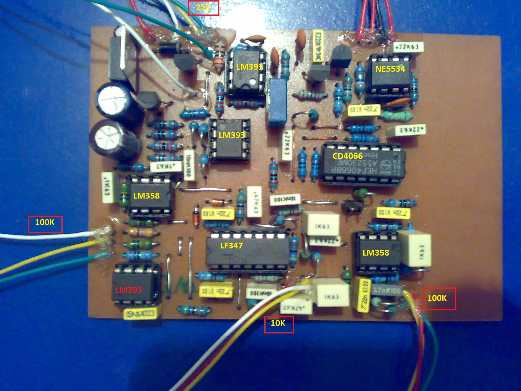

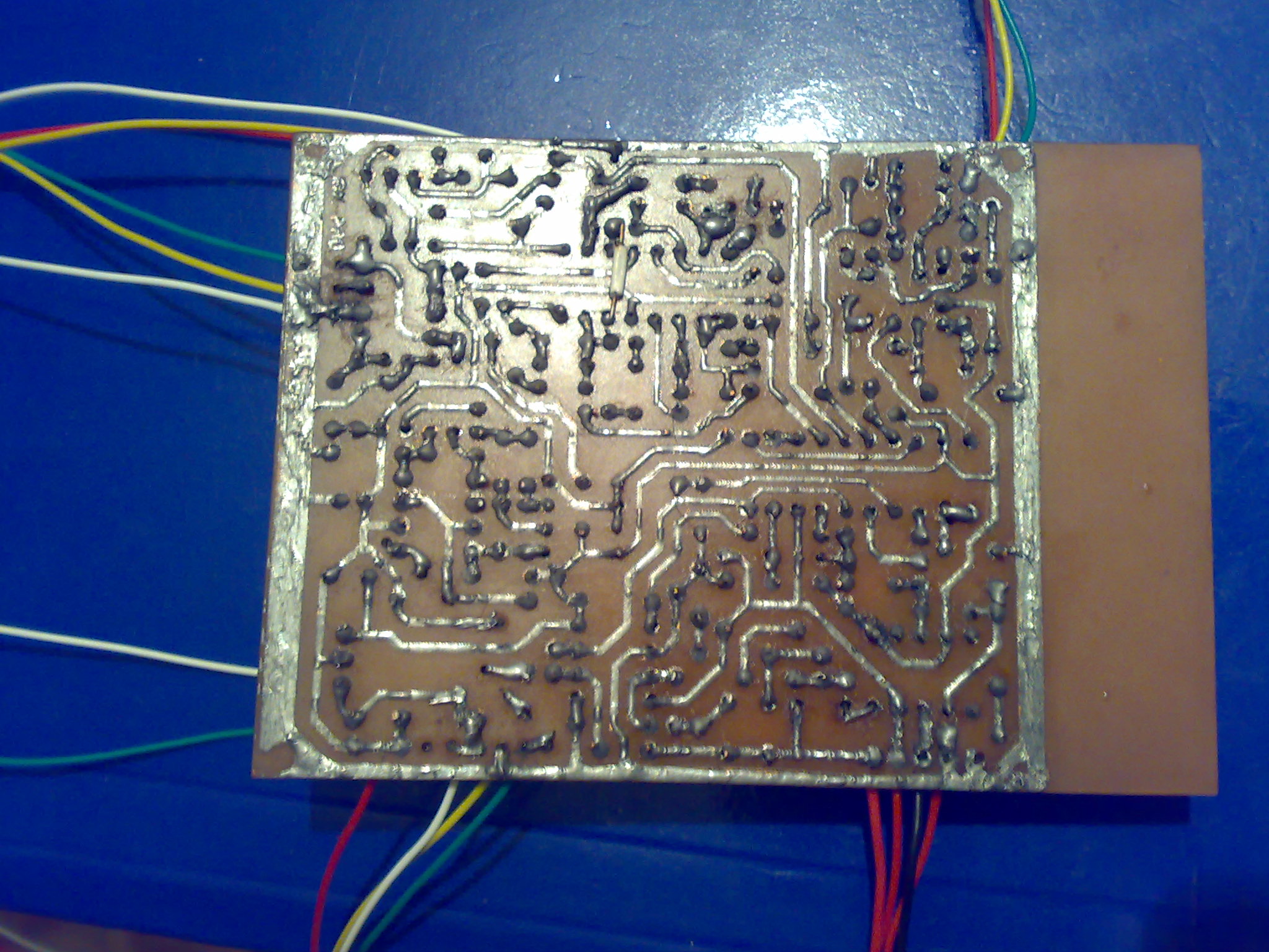

                      • Hello,
                        I made idx pro without display and its performance was pure. 1€ coin detect on about 15cm in the air, I made coil as founder give data for it (RX 35,6 mh, 92ohms and TX 0,587 mh, 1,8ohms) TX operate at 6,5 khz. I really don know what is wrong, pinpoint work perfect with them I can detect 1€ at 28 cm so I think that coil is good set. What can be reason for that pure performance ? Any sugestion?
                        I make from this pcb, from attachment
                        • Don't know what your problem is - daj po naški.
                          • This is PCB :
                            • Originally posted by konan View Post
                              Hello,
                              If the cancellation of the coils is good, then you have to change the LF347 and U4 (LM393). You have to get some IC with more gain. The rejection of the ferrite and iron as they are?. Many factors can influence. The PCB is not very clean. Try what I said and tell us what happened. Regards.
                              • The coil is DD, when I override coils I get _____________________ on oscilloscope on RX coil. The rejection of iron is not good. I will clean my pcb. I will inform you about.
