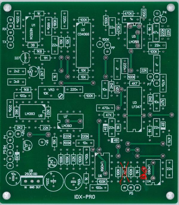

    For threshold tone discrimination mode, you have to eliminate the resistance of 470 ohms, and connect a 4K7 resistor between pins 6y7 of U4 (LM393). This way you will get a nice tone threshold discrimination mode. The threshold tone level is adjusted with the potentiometer sensitivity. Greetings. Eduardo.
    I have to remove the 47 ohm resistor R25 to a wire in place and put a 4k7 between terminals 6 and 7 of the LM393?

      • ok but instead of Resistance R25 I have to put a wire or not?
        • if I remove the resistance of 47 ohms Point P5 is no longer connected.
          • Originally posted by ashefr10 View Post
            You have to remove the R25 (47 ohms). It resistor remove without putting anything in its place. Simply remove. Add 4k7 resistor between pins 6 and 7 of U4 (LM393).

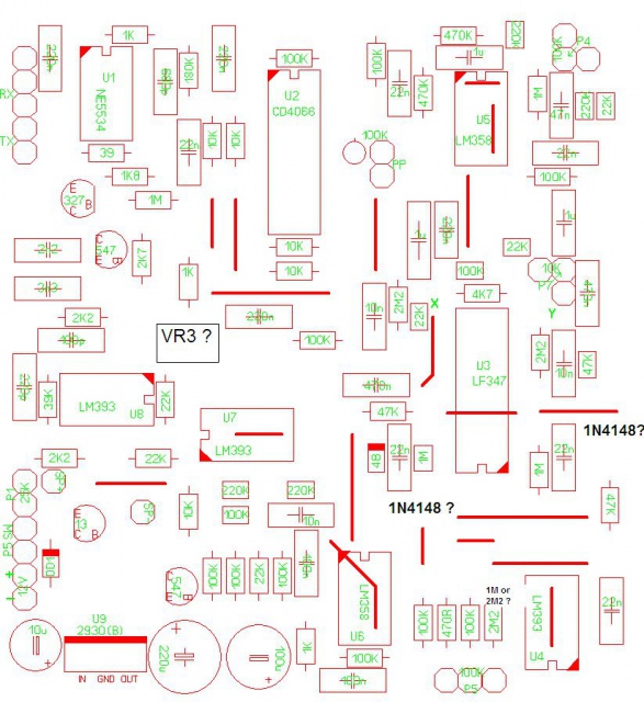

                    • the last pcb edouardo that offers several components have disappeared from the pcb I have. Two 1N4148 diodes and adjustable resistance VR3. I also see a resistance near the LM393 is not 2M2 and 1M. should I do the same thing? VR3 If this is not what I replace it with?

                            • Edurado could you just replay for my question in #1249
                              After this Yours update:
                              C23 - 3n9 -> 3n3
                              R24 - 1M -> 2M2
                              R25 - depends of U4 (my value about 800Ohm)
                              D2, D3 - out
                              VR3 - out, only R43 1k8 -> 2k2
                              I have worst masking, and my idx is a little unstable- is it normal or I have some sort of problem?
