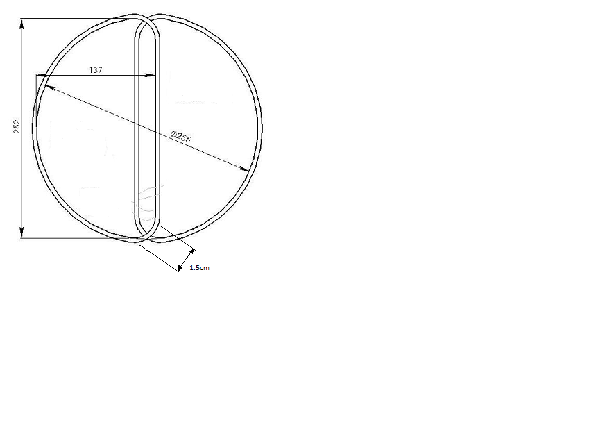

                    • Who can help me ? VR1 is minimal and does not remove all ferrite, why and what they can do?
                      • Originally posted by gaby_sult View Post
                        What coil are you using ??
                        • DD 255x137 template to TGSL but characteristics TX - 0.7CuEm 35 turns - 0,587mH - C = 1uF and RX - 0,2CuEm 265spire - 35,6mH- C 0,033uF. As adjustment VR1 has some effect but not all remove ferrite
                          • What is the recommended coil and which data coil diameter and induction for IDX?
                            • Homemade data is on the first page of this thread and the DD shape is the same as in the TGSL101 PDF
                              Factory coils the Whites 950 works well. Be careful with their concentric. The ones built for most of the older Classics will not ground balance properly or will be right at the end of its adjustment.
                                I using this shape.
Name:	sonda nacrti.png
                                TX-0.580 mh wire 0.65(cap 1uf)
                                RX-35.2 mh wire 0.20(cap 47 nf)
