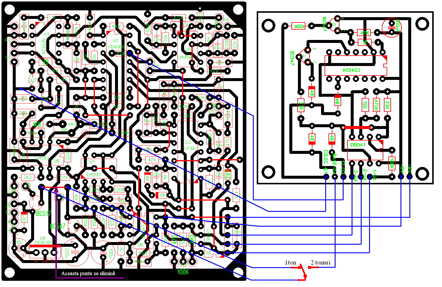

                    • Can anyone say where is wrong because it does not work correctly.Click image for larger version

                      • Originally posted by gaby_sult View Post
                        Can anyone say where is wrong because it does not work correctly.[ATTACH]34885[/ATTACH]
                        I also connected like that not work correctly,but i think you must take out BC 547 from idx board but not sure
                        • And yet is someone to say where is the mistake?
                          regards Gaby
                          • Originally posted by seadoggy View Post
                            Most can't help as they did not do the two tone mod. Noticed "rev" on here has a nice video on YouTube with it working maybe a PM is in order
                            https://www.youtube.com/watch?v=Bw90MPkXrWY
                            • Silly auto correct "reiv" not rev in the above post
                              • Tried that method from your pic Gaby, also, tried without bc547, nothing. Exactly the same board's like mine, both.
                                I got only lower or upper tone, impossible to get both tone's. Never solved that problem.
