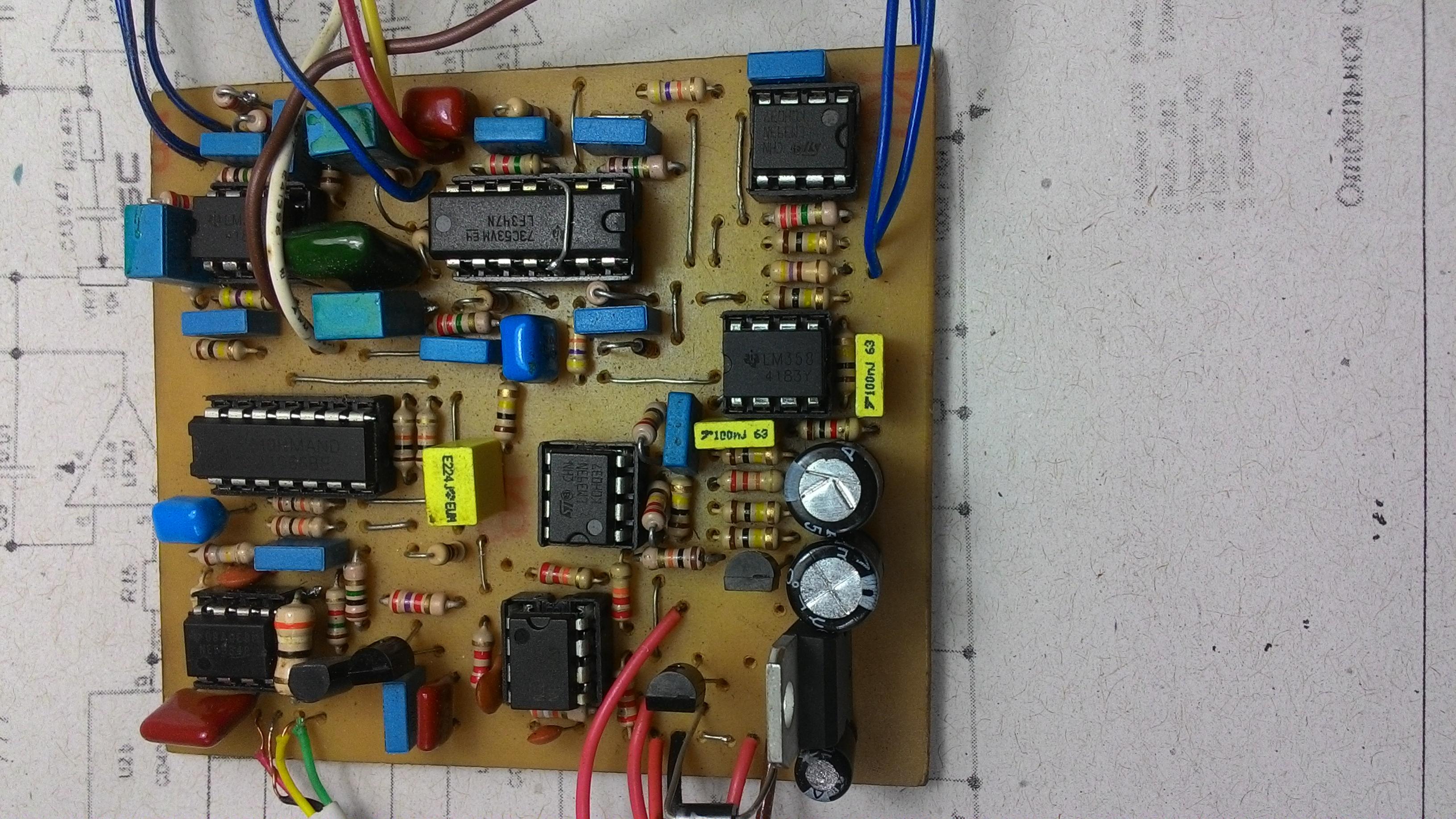

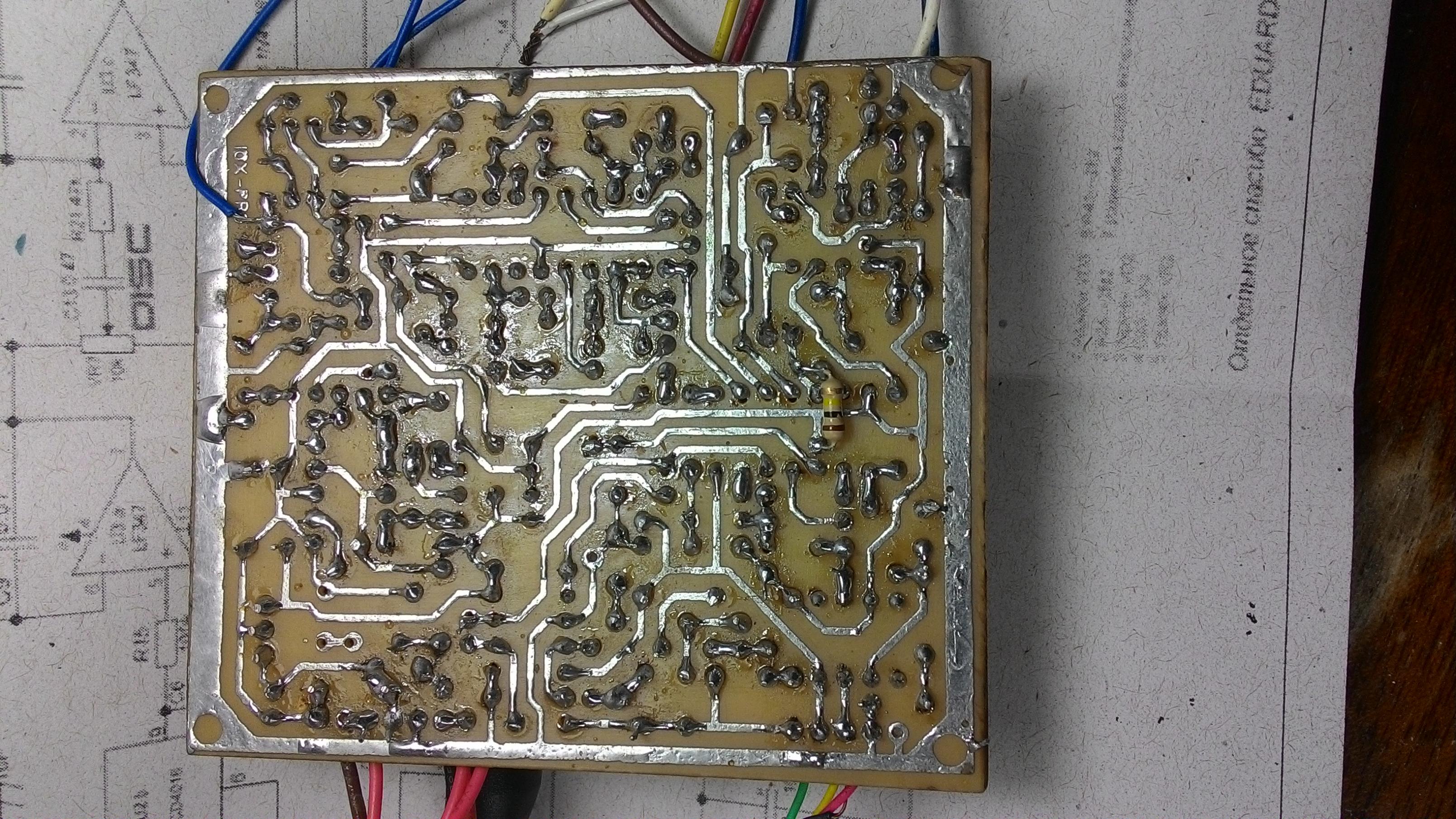

    my md only works in pinpointer mode
    https://www.youtube.com/watch?v=w-DH-vFUDuI
    Look's like not well nulled coil. Did u measured pin 3 from U1? Must be less than 200mV.
    Also, attach clear photo's from pcb...
        • What i can see from first look, u have minimum 7 - 8 bad soldered pins. Solder that again, clean with alcohol, let it dry and try again. Good luck.
