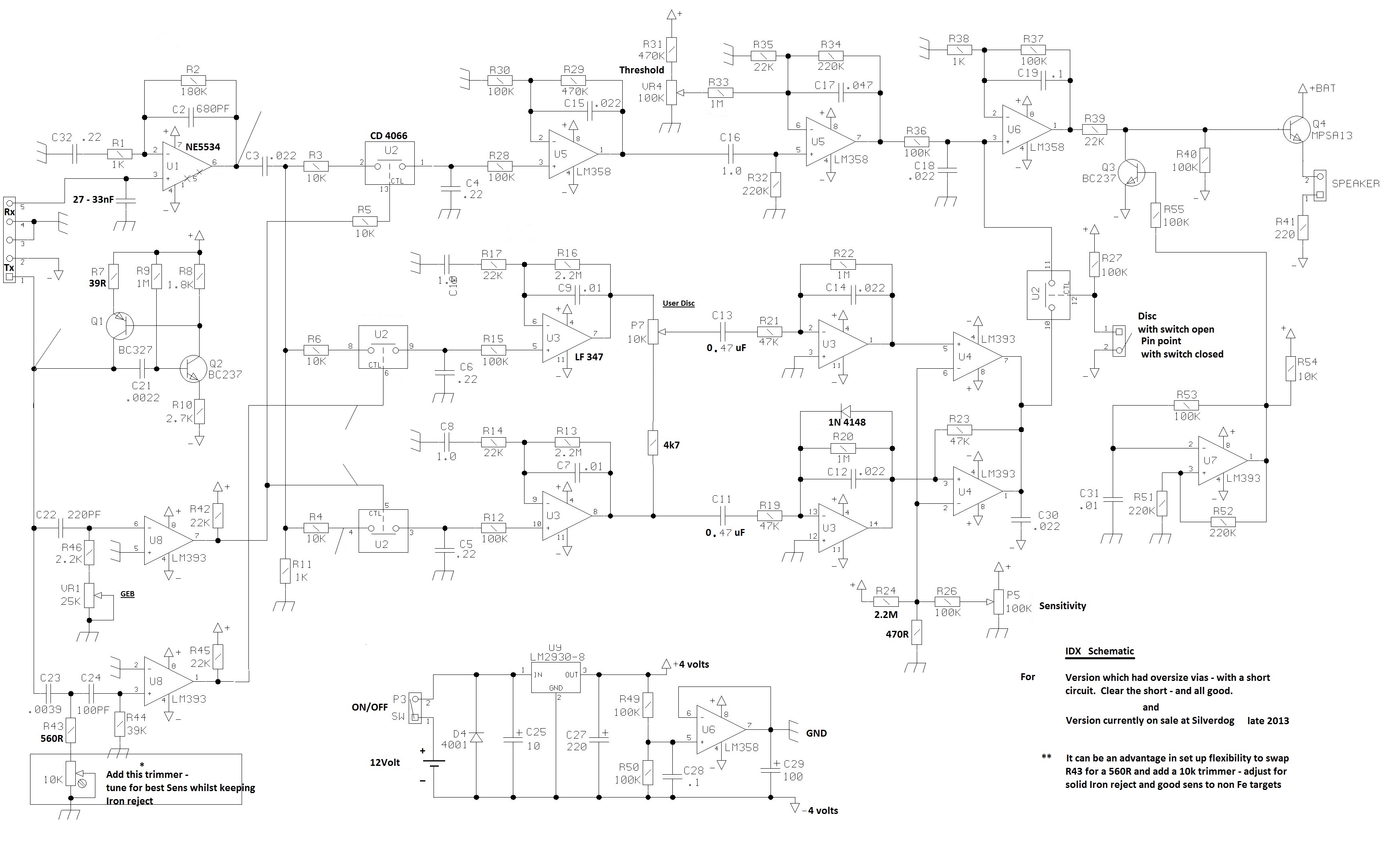

  • I looked at the current release of PCB from Silverdog and also the pcb that had the oversize pads and a short circuit. This schematic goes with both. Click image for larger version
Name:	IDX schematic - late 2013 and pcb that had short cct.jpg
ID:	338622 There was an earlier release pcb which was a little different. All of them work. S
      I looked at the current release of PCB from Silverdog and also the pcb that had the oversize pads and a short circuit. This schematic goes with both. [ATTACH]27501[/ATTACH] There was an earlier release pcb which was a little different. All of them work. S

      • Hi everyone!
        I build PCB (from Silverdog) and 27 DD coil from georgi(not filled with epox yet). I get 6,15kHz on TX.
        Sensitive on silver ring ~20cm (~8 inches), but detector is really unstable ( somebody move in room where is detector, it starts beeping). If i turn on PP, detector become stable, but max deep on the same ring is ~4-5cm (less then 2 inches).
        Maybe someone has i idea what problem i have?
        P.s. I dont have oscilioscope.

                • You have a few unknowns, and little way of viewing without scope.
                  To help the foto we need better. closer images we can read the resistor colours etc. plus a bit more resolution - file size.
                  The good start is "I get 8" on silver ring" so the disc and geb CH's appear to both work.
                  Can you reject ferrite
                  can you reject iron
                  can you accept ally, bronze, gold silver
                  For more sens you need to adjust the Rx cap either up or down by 1nF at a time and retest.
                  The initial phase you cant test.
                  The stability may improve by twisting the pot wires.
                  What volts do you have on the op amp rails --- put meter black on one of pcb corner holes
                  you could reduce Tx cap by a few nF to boost it up
                  make sure the resistor on the Tx transistor is 39 R
                  • Greetings, I have a problem setting the detector are .... have a range of 30 cm to a coin ... but with much background noise interference is annoying ... I could not remove this noise will ... I'm not using the BC327 ... I'm using the other TNT159 not know if this affects? ... I already have that sound crazy interference ... ask for help .. sorry my translator does not use English
                    • may be your coil not well balanced what is the voltage at ne5534 pin 6 when no metal near the coil ?
                      does you use sheild ?
                      in room IDX is noisy little but outside home it is so good and stable
                      • everywhere interference and annoying background noise ... lowest voltage I can download it a1, 2 volts on pin 6 U1 ... looking componetes ... I still can not get uid remove that line ... even an intermittent sound outside the house .. I fail to know that you may be going ... ask for help .. regards
                        • Originally posted by ricalbertvig View Post
                          ok,voltage at u1 piin 6 shoulld be (0.1-----0..2max)
                          diid you use shield?
                          DD coil is more stable than cc coil
                          check cable connector it will make instability if it not good type
                          check ground balance potentiometer or replace it
