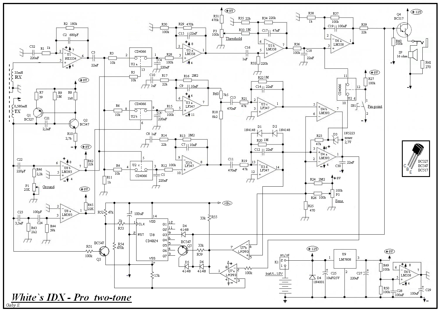

  • Today I combined logic with TGSL and and went out this scheme, is it functional?
    regards Gaby

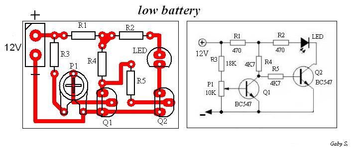

              • A schema, simple and practical. Low Battery
                low battery.rar
                regards, Gaby

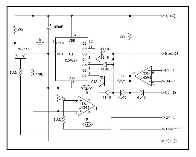

                • Hi dear friends,I do IDX-PRO-VDI project...this schematic ıdx and vdi and 2 tone schematic LAST VERSİON add ? thnx regards
                  • Originally posted by kuzen View Post
                    And I'm in the same situation as you, Mr. Eduardo says this would be the last Scheme 2 tons will work if you give us the news.Or a video on youtube with your work.
                    Regards Gaby

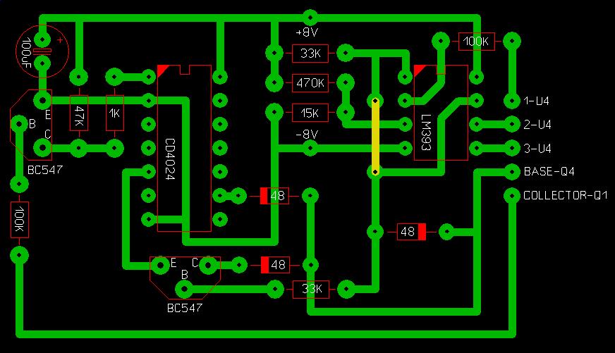

                      With all due respect. Mr. Eduardo at me the why not go and your work 2 tons?
                      I tried all the variations that have been posted by you, and nothing.
                      I respected the scheme and not wants nothing just a hoarse tone.
                      Best regards Gaby.

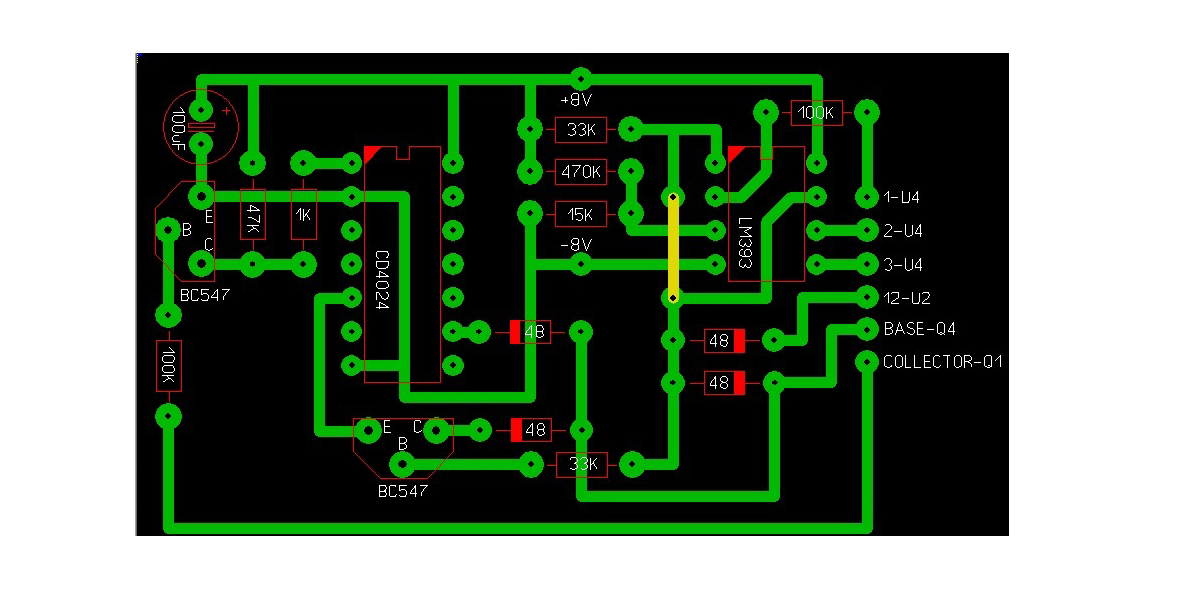

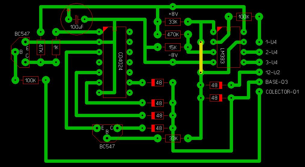

                      • For the circuit to work properly, you must disconnect the collector of transistor "Q3". In this case everything should work. Somewhere in the forum, everything is well specified, but many people do not read all the details.
                        A greeting.

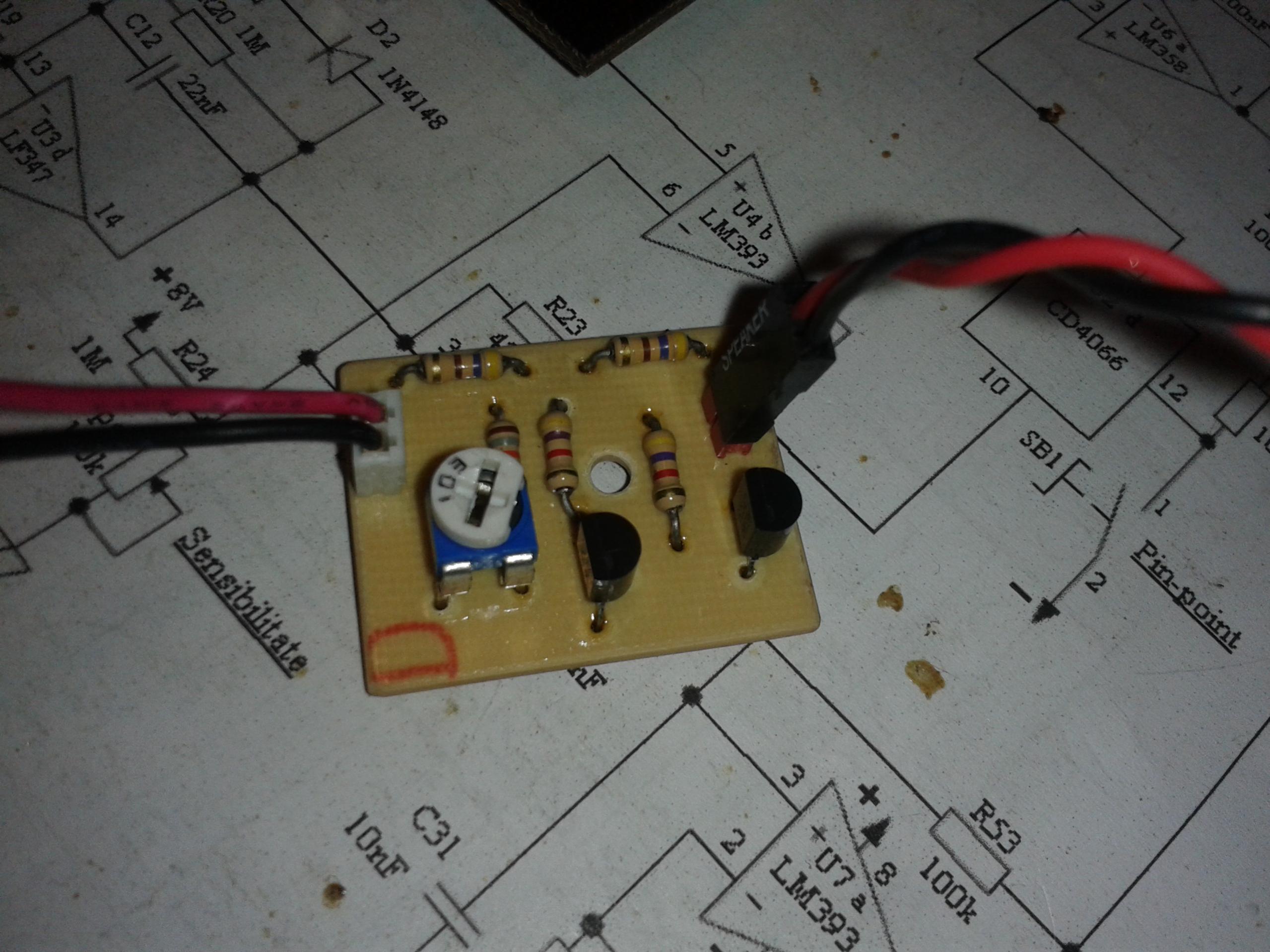

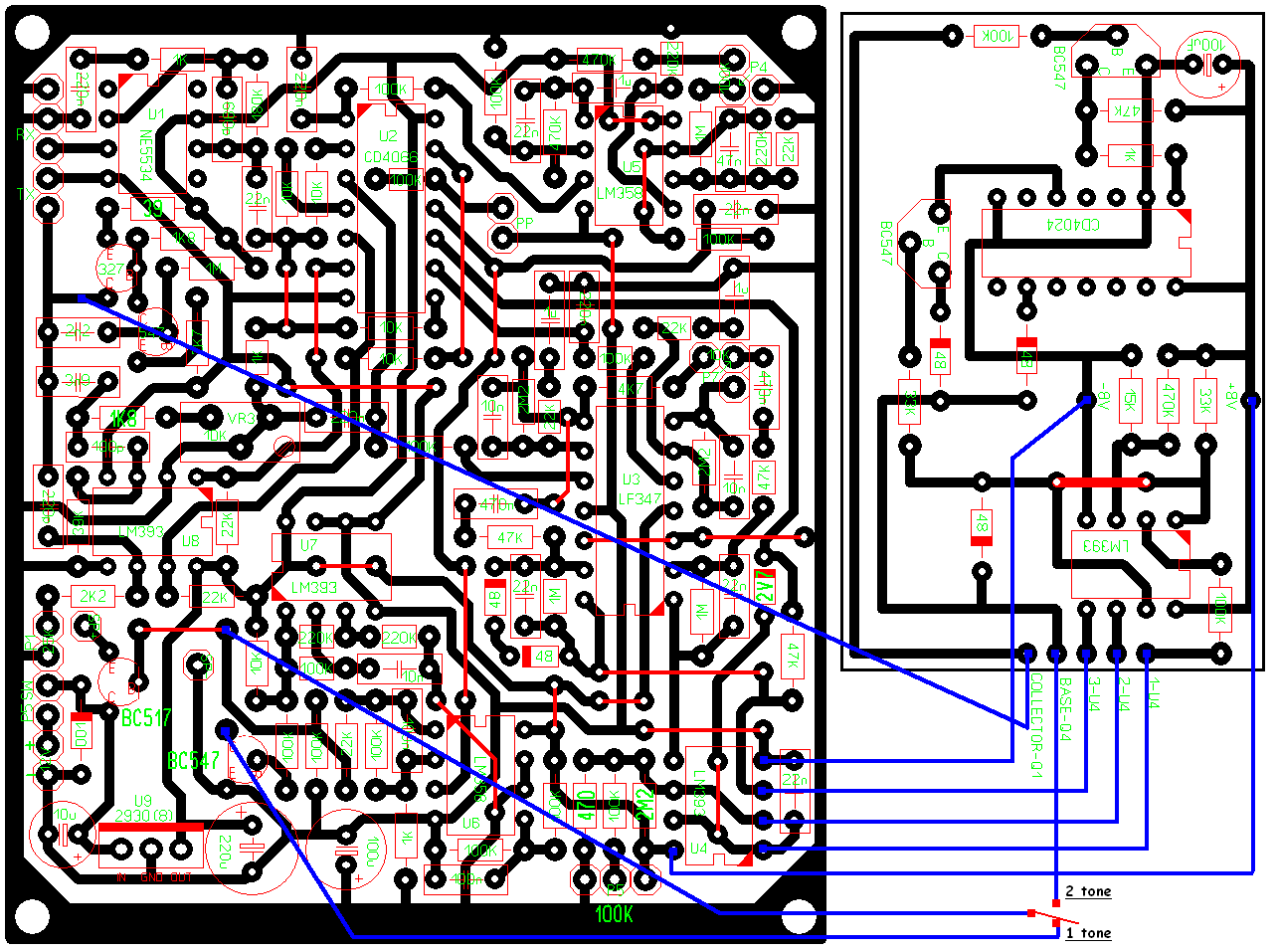

                            • With much patience I understand how it works Circuit 2 tons which no one has mentioned it appears then the second tone.
                              Here is change IDX-2ton board, but to enter the two tones have intervened in P7 (discrim.) as though eliminate iron.
                              Gaby

                              • For those interested here you have modified scheme IDX-Pro two tons.
                                Maybe it's someone younger to make a PCB for this scheme.
                                Gaby.
