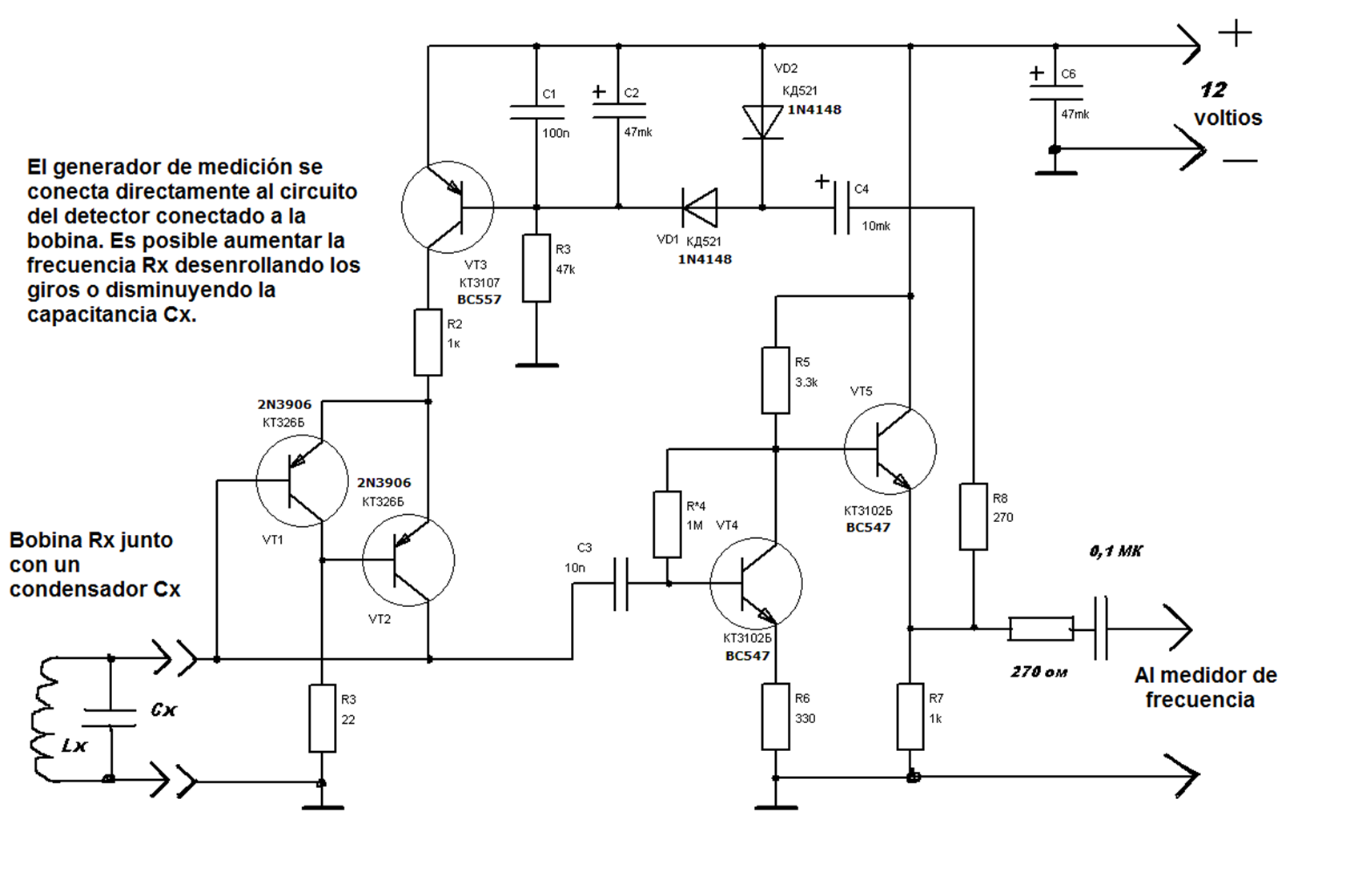

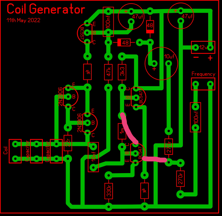

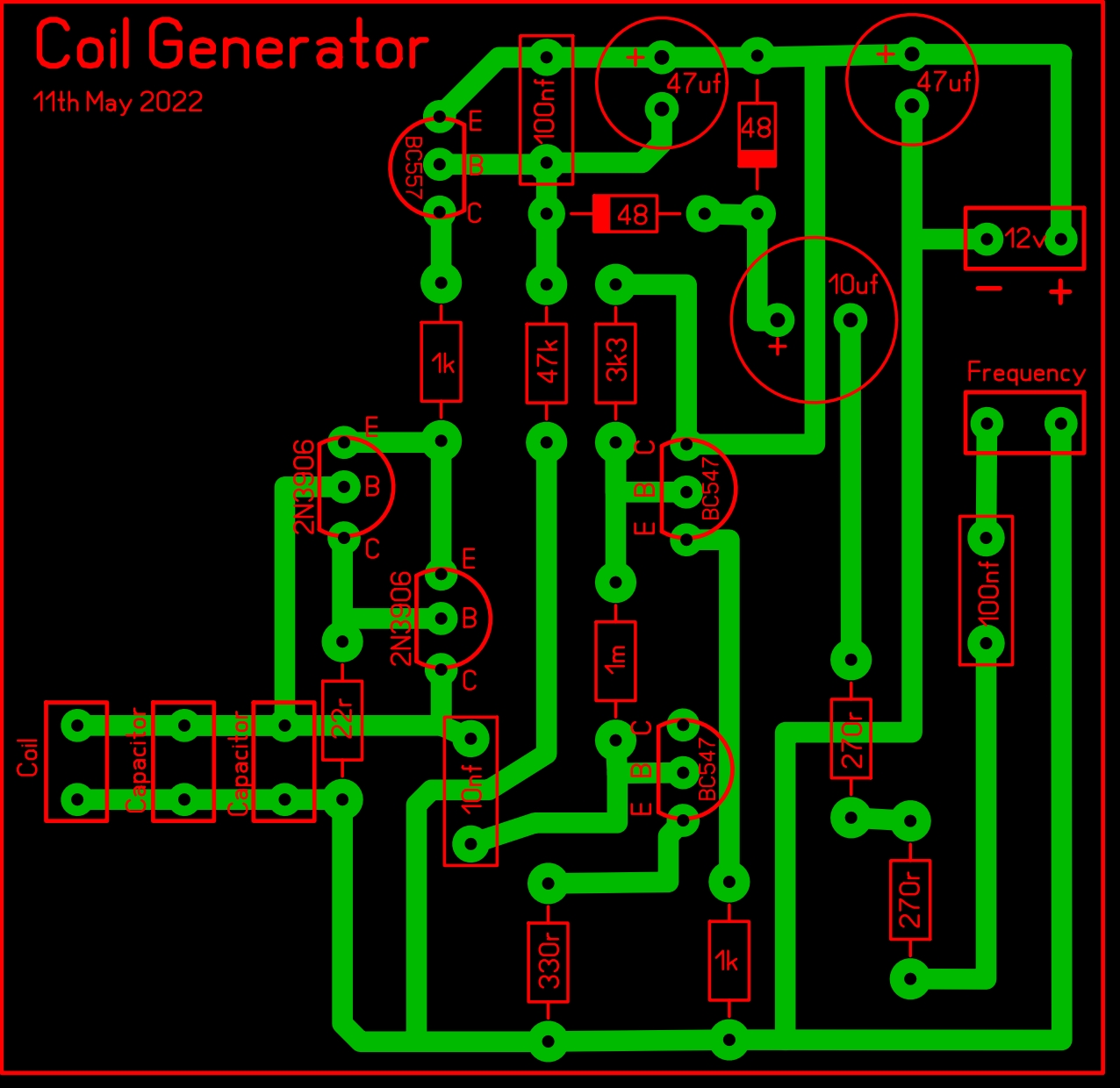

  • Hiya Ruben, Hope you are well! Could you please check my Coil generator PCB drawing please? I did it according to the schematic you posted earlier in the thread and I would like to make it so I would just like a second pair of eyes to check my work before I build it, Lol. Thanks Ruben, Regards, Marty.
    • This generator does not start well with low resistance TX coils. To eliminate this, it is necessary to reduce the resistance of the resistor R3 to 24k
      • Hi Marty, thanks for the greeting!
        I have seen two union points that you are missing here I send you an image.

          • Thank you Ruben, you're very kind to check my work and make the corrections, I appreciate it! I will alter my drawing and collect the parts to start building. Take care Ruben, Regards, Marty.
