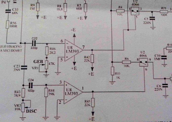

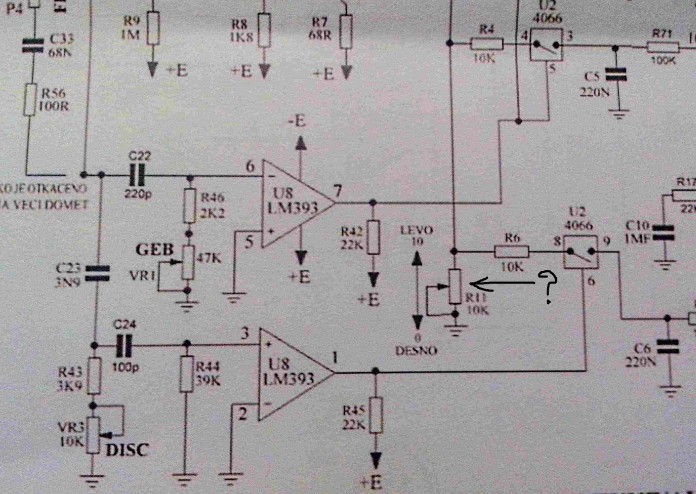

    • Hello. Who knows what the variable is used instead of a permanent control? The scheme specified by an arrow.Click image for larger version

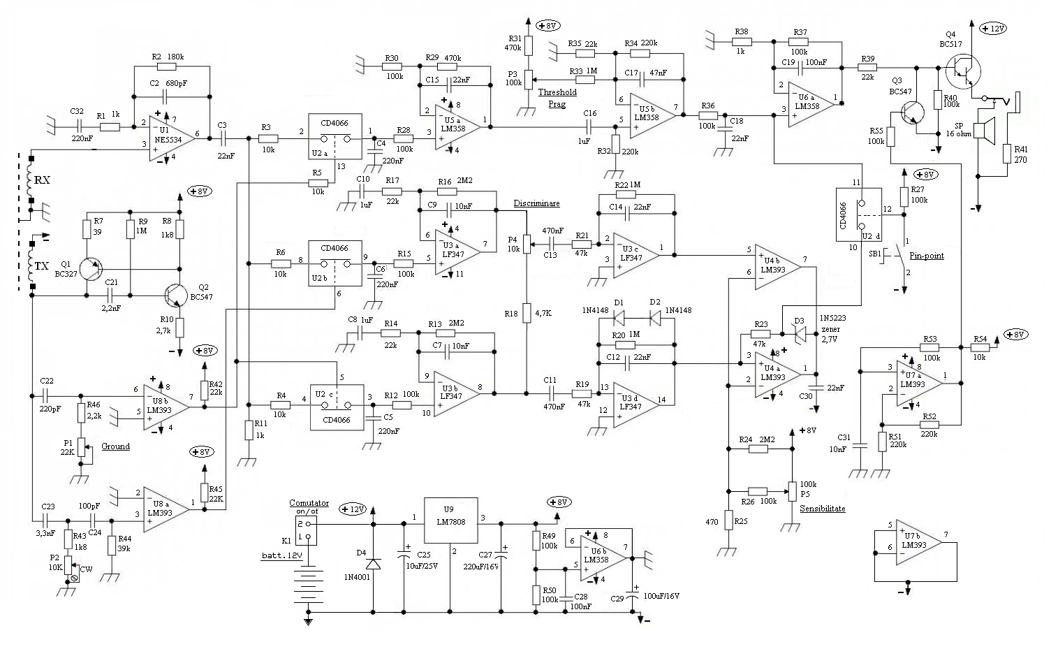

      • Hi all
        Why my idx cannot detect coin when it is near the coil but can detect at 35 cm
        • Originally posted by Artyom View Post
          Hello. Who knows what the variable is used instead of a permanent control? The scheme specified by an arrow.[ATTACH]35124[/ATTACH]
          it's a mistake it is correct
          Gaby
Name:	111 correct.jpg
                    i see very archaic russian word "desno" that means (AT) RIGHT. "desnitsa", is right nand in russian forgotten. what your native? what country you are from? where you got this chematic from which forum?
                    • Originally posted by ossamaussama View Post
                      Hi all
                      First time I have seen this. Will it ground balance ferrite.
                        Word "desno" is serbian, it means "right", and this schematic is from Serbian hobidetektori forum. Second thing - this schematic is for Whites Classic 3, not for IDX.
                        • Originally posted by Koala View Post
                          yes it can reject frite in all metal and discrimination mode
                          i change rx capacitor and still have the problem with large copper target
                          small coin can be detected very near the coil\
                          but large bronze coin can be detect only if it 5cm to 35 cm
                          not less not more
                          is it saturation problem in amplifer stage ?
                          is it normal?
                              not less not more
                              is it normal?
                              in all metal ( pin point ) it can detect large copper very near the coil
                              35cm on large coins is normal.
                              Not detecting if close to the coil is not
                              I have no ideas hope someone can jumps in. Only thing I can think of is the phase is altering and the target is being discriminated out as iron
                              Is it the same in all metal mode
