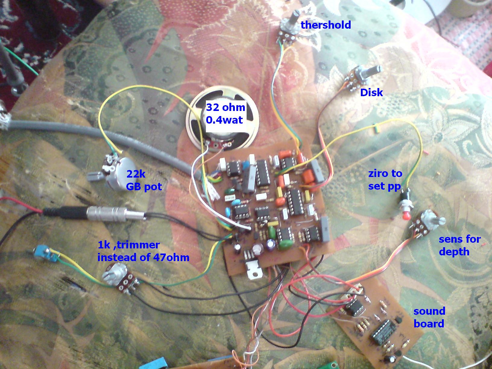

            • Can someone explain the function of the pot threshod?. Is it necessary in this circuit?
              thanks

                Firsly you have D3 crossed out in the schematic....
                You will need this..
                Most have a IN4148 in here... as per silk screen - You can use a 2v7 zener also - fit as per the schematic ( i.e. The zener would go one way around, the dide must go the other way around. ) I think we covered this before, twice
                The Disc pot when set CW will reject Iron
                The Disc pot when set CCW will NOT reject Iron
                The Geb pot when set correctly will reject ferrite
                I call the Sens pot the Threshold whish is very confusing I apologise.
                The pot tha goes to the two comparators - this sets up a small positive DC level for which signals on BOTH Disc and GEB channels must exceed for a tone.
                the pot at the top has its main use when in PP - if set too high the tone rings out continuously. So in PP require to back it off CCW so just no tone.
                IN Disc mode leave this pot CW almost fully. This puts more positive DC bias on MPSA13 base - so closer to loud conduction. Works a bit like volume in Disc mode, It does reduce volume of HIT if set CCW

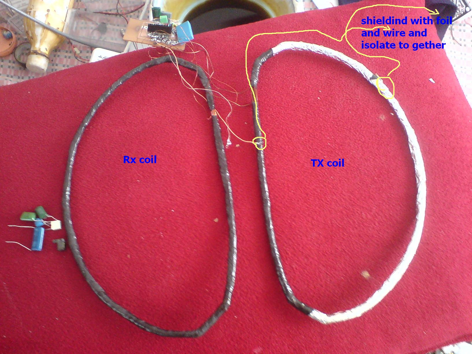

                • My friend Mr koala
                  first i change 47n to 22n+8.2n and can mor detect(i set once thershold for all) detect in 28cm
                  then 22n+8.2n+3.9n detect in 33cm
                  next 22n+12n+2.2n in 35or36 cm
                  it is good depth or no?
                  this coin for all above parts ( 26mm diameter)
                  but discrimination is not good and i think frist set Geb pot next do it, correct?(when i set Disc in CW fully can not find gold ring fine,not good sound when detecting that and iron things!!)l

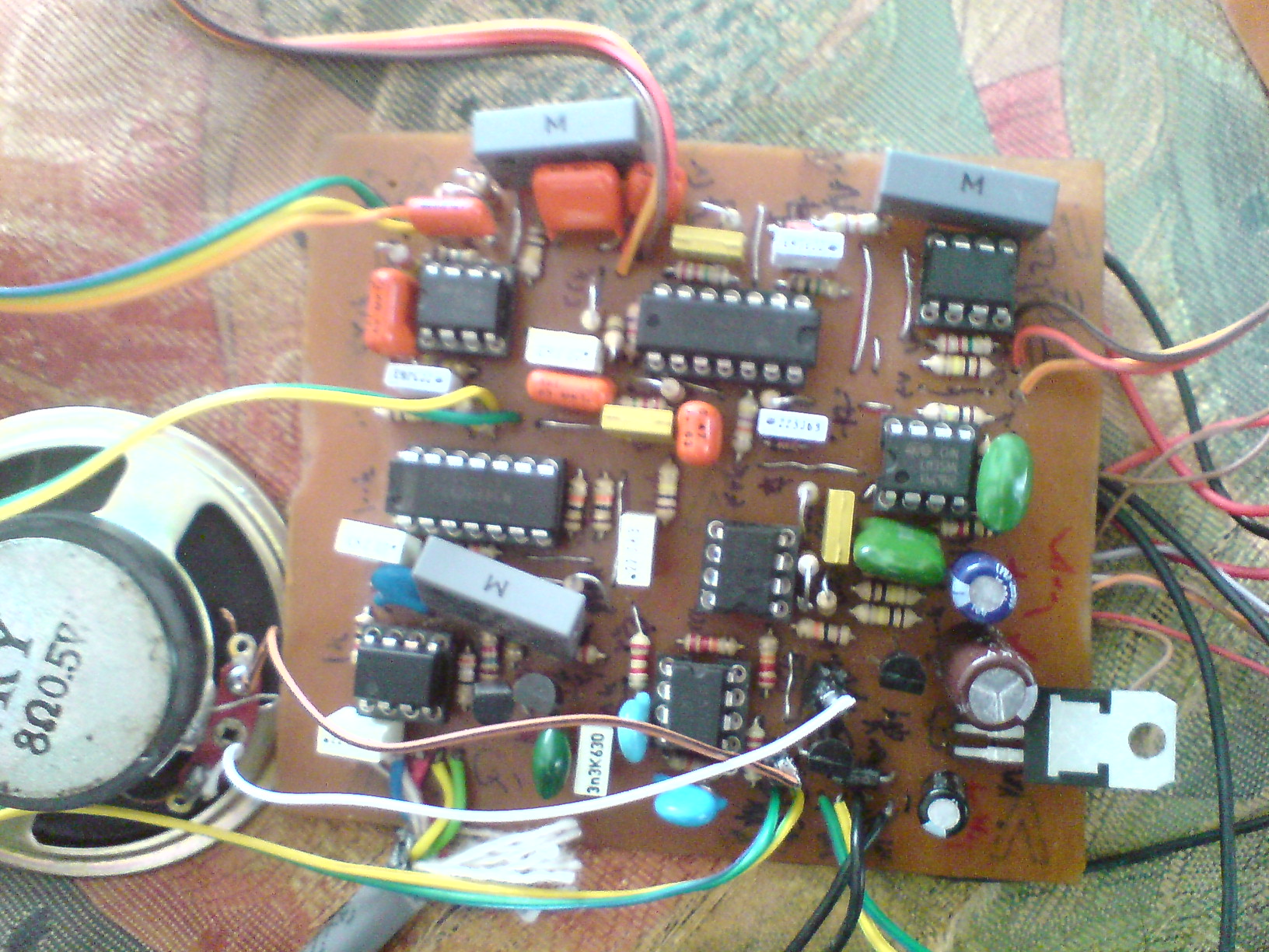

                  • well done by experimenting with the RX capacitor you have gained nearly 1/3 depth
                    Best I have had with that size DD is just under 40cm but that is with a 120mv null on pin 6 of U1
                      You have a large DC offset at the preamp output of at least +3.5 volts.
                      That why the Rx signal looks clipped - its saturating on the pos rail..
                      This needs to straddle the 0V position
                      Make sure the rails are +4V and -4v WRT the copper around the cct board edge.
                      I dont know what you have done here to get this.
                      Put some good 2Mbyte images up in good focus with natural light and we will all try to help you
                      You could force a better DC offset condition like this...

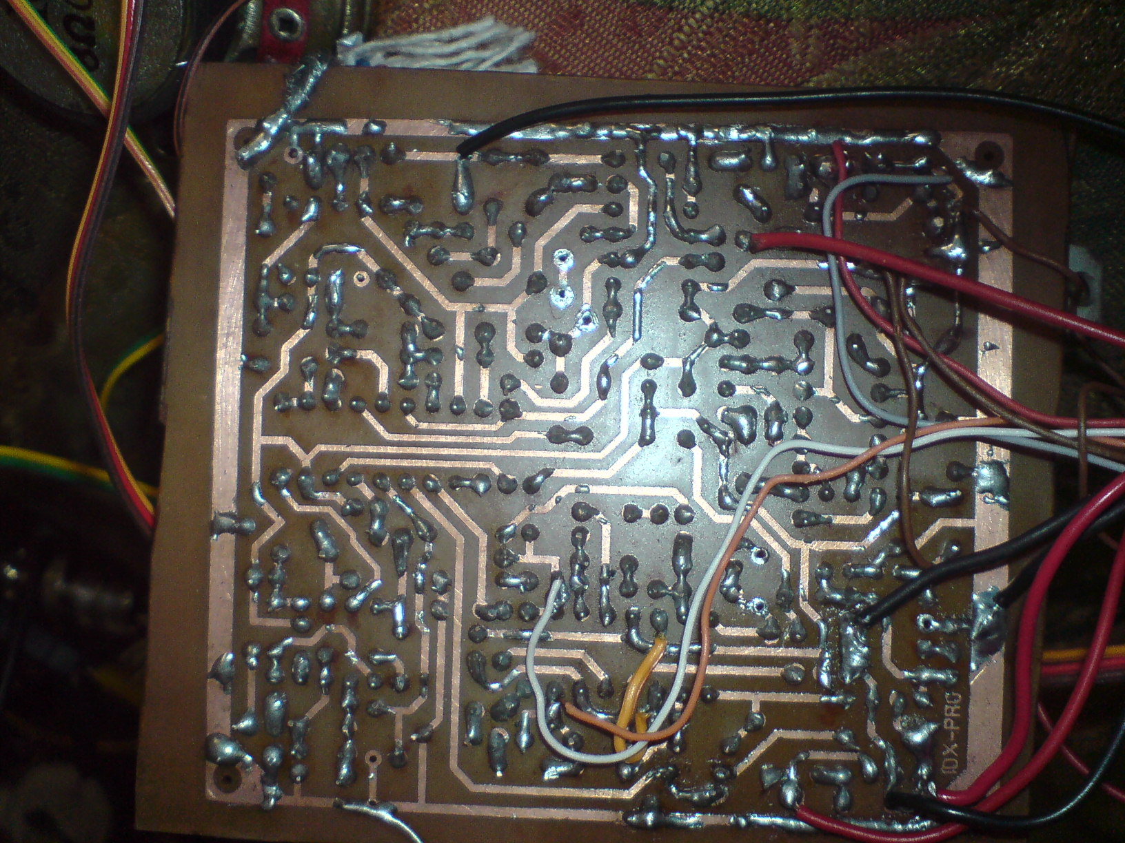

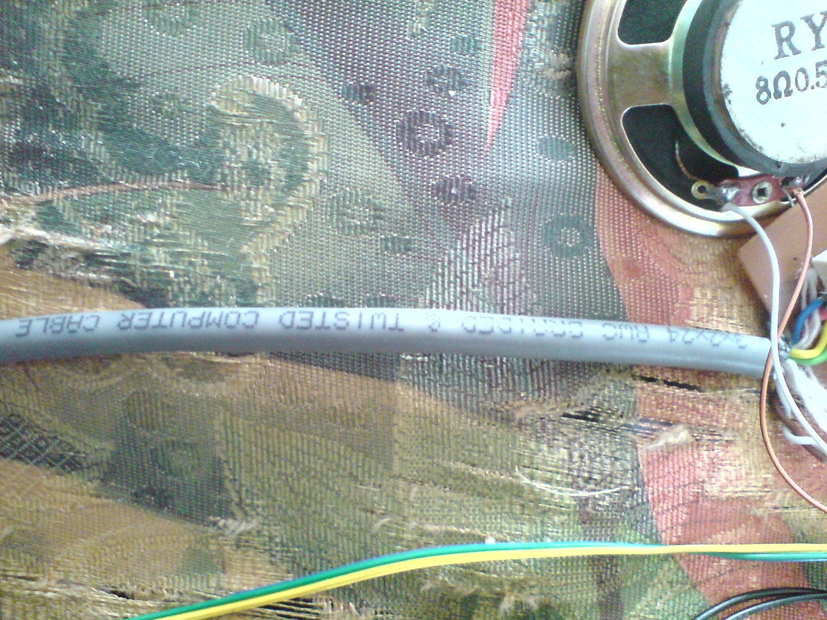

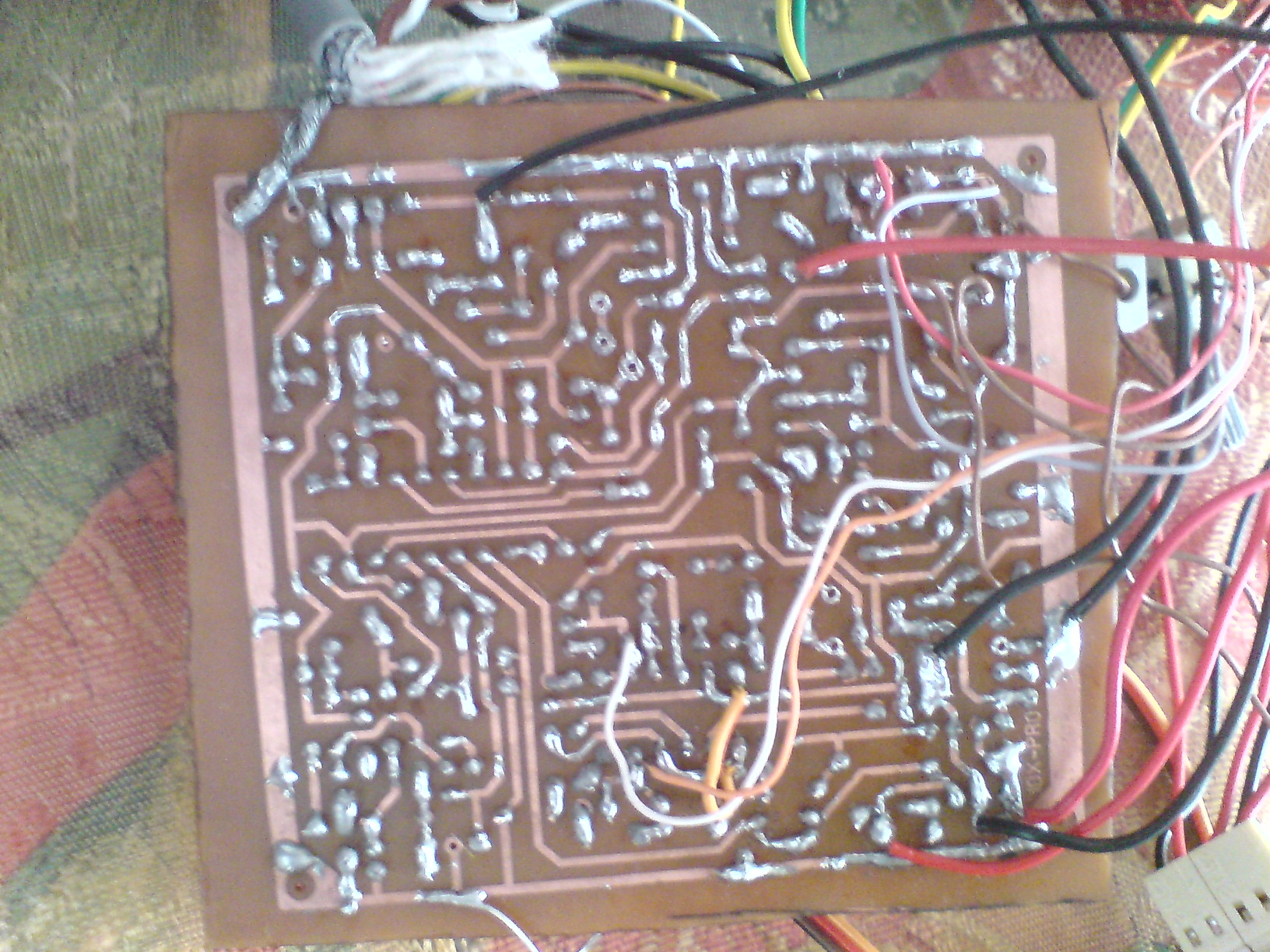

                          when i use this attachment i can imrprove very best , and i adjust it on 200mv.but in middle pot i add 22k and now is 22k+22k = 44k(i change it , true? )
                          look this pic befor adding attachment

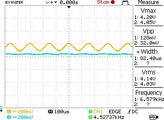

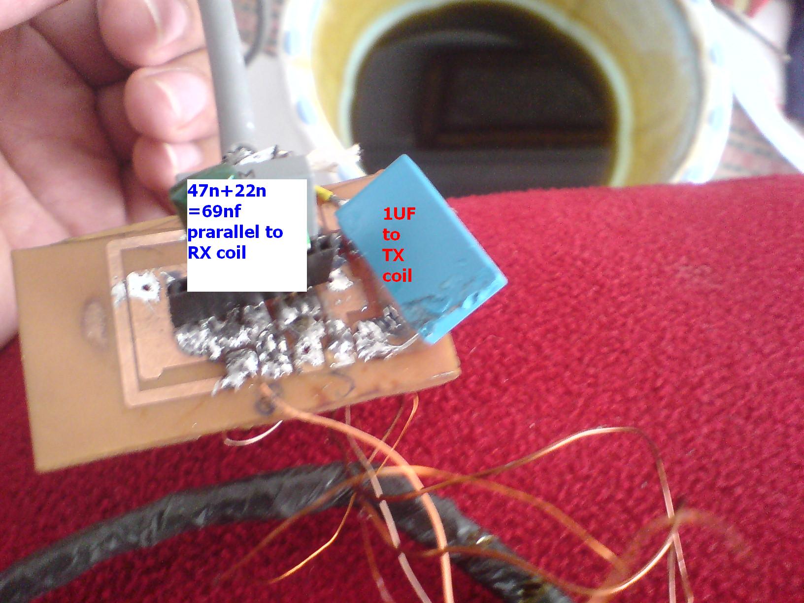

                          and when i add the attachment in IDX , i use (22n+47n) and can detect at 28 to 30cm
                          , is it good depth for this coin ?
                          this is the pic , Yellow is ne5534-6 and Blue is Ref RX coil

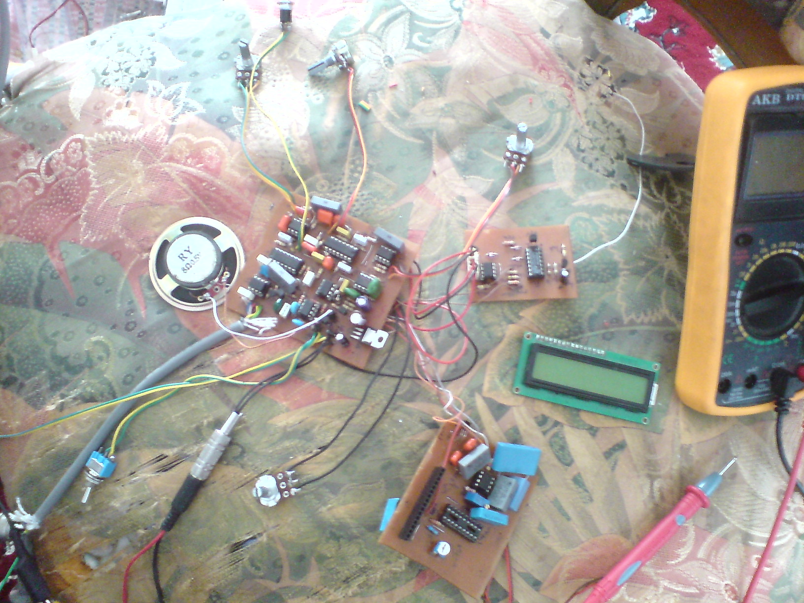

                              I can see you have put a lot of effort into getting this to work. Well done.
                              You were on 35 or 36 cm with 22n+12n+2.2n I would go back to this
                              You can not get lower than 1 volt on pin 6 of U1 this is due to the nulling of the coil. You can try moving a small piece of ferrite between the coils. Hope you have not left the oscilloscope on 10X an easy mistake to make. If you can not null your coil then this will affect the detection distance.
                              Can not think of anything else that would help here unless there is some interference somewhere or metal nearby as my coil nulled fine. Anyone any ideas.
                              You are using using a LF347 as some alternatives have been know to cause problems.
                              A cheap set of earbuds (in ear headphones or earphones) are very good for testing PP mode it is much easier to pick up the change in threshold tone than a speaker.
                              Nothing jumps out at me as an error on your photographs but they are a little blurry
                              Hope this gets sorted soon
