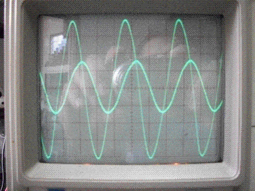

                  Hello Silverdodg
                  Here is a photo of the cancellation coil, my IDX_PRO
                  RX seems to work best near 90 degrees as in the photo.
                  16 volts for TX, 2 volts for grid
                  + or - 150 mV for RX, 50 mV per grid, pin 6 of 5534.
                  Greetings Jose
