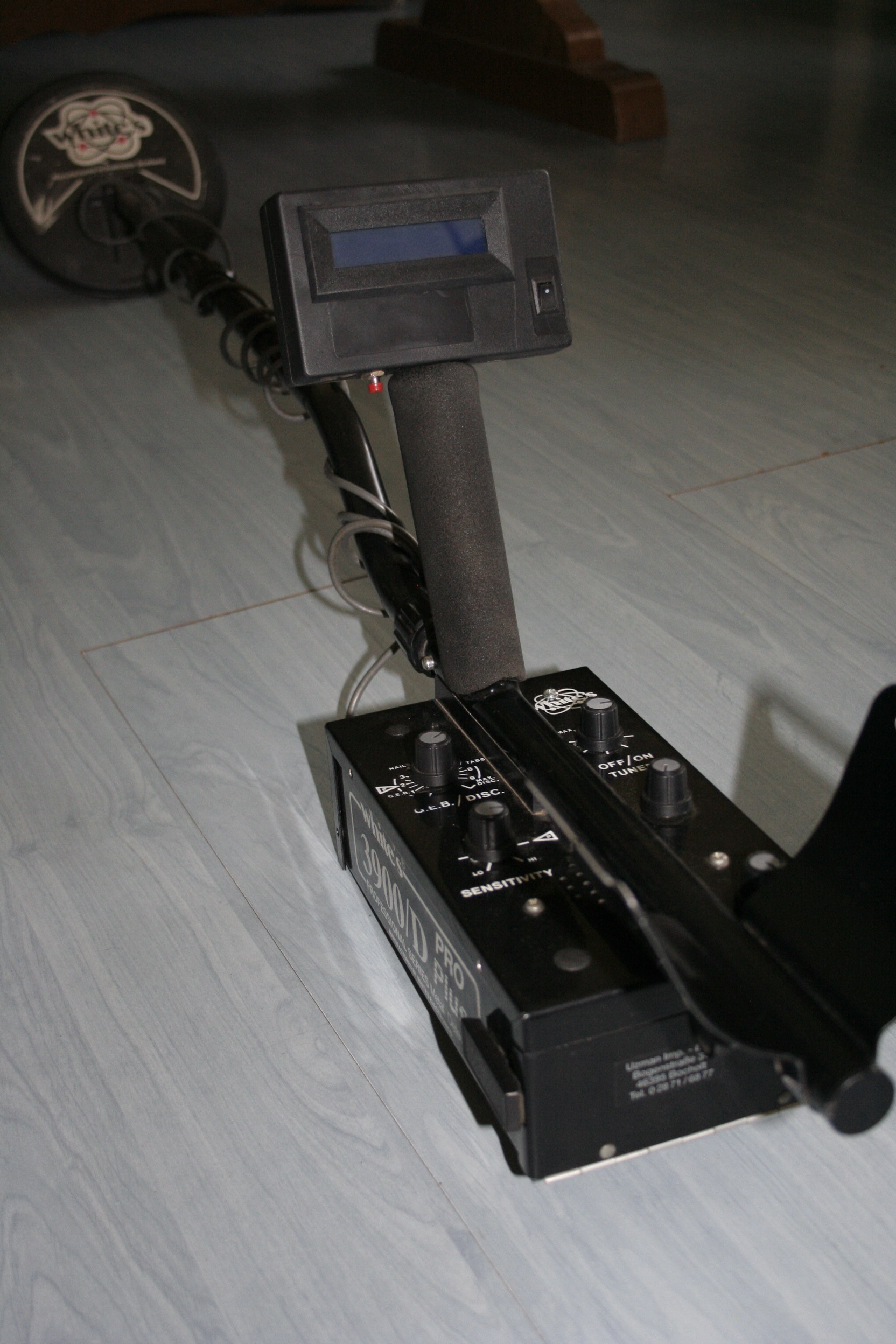

              “Display sized” PCB for VDI (16F690 version), standard components

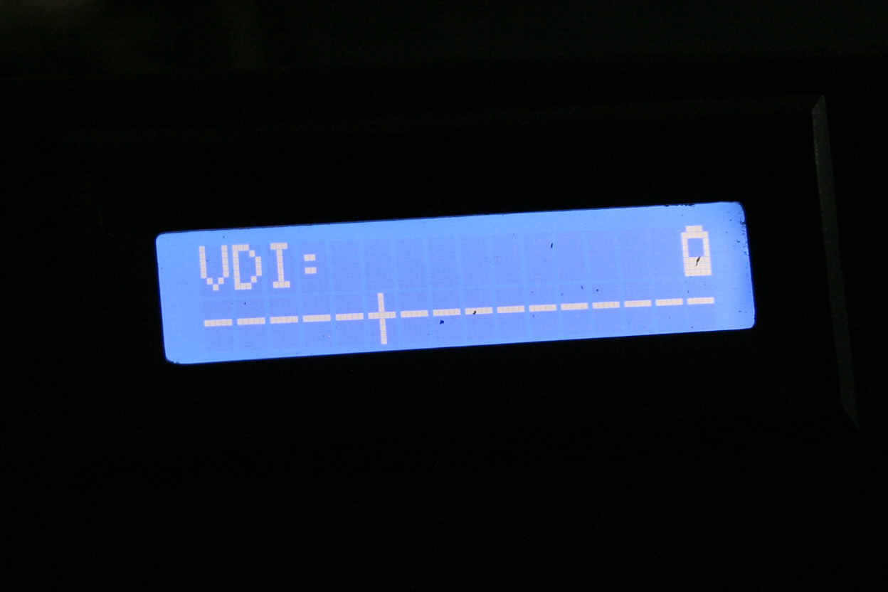

              I was finished the 690VDI project. How can I setup it? The IDX work good, but the VDI donn't present well. All of the metals take a +16 value.
              • Originally posted by szucs_g View Post
                Somebody can tell it, that what kind of sign is needed get with an oscilloscope it X and Y on dots?
                Works for somebody with 16F690 PIC built VDI?

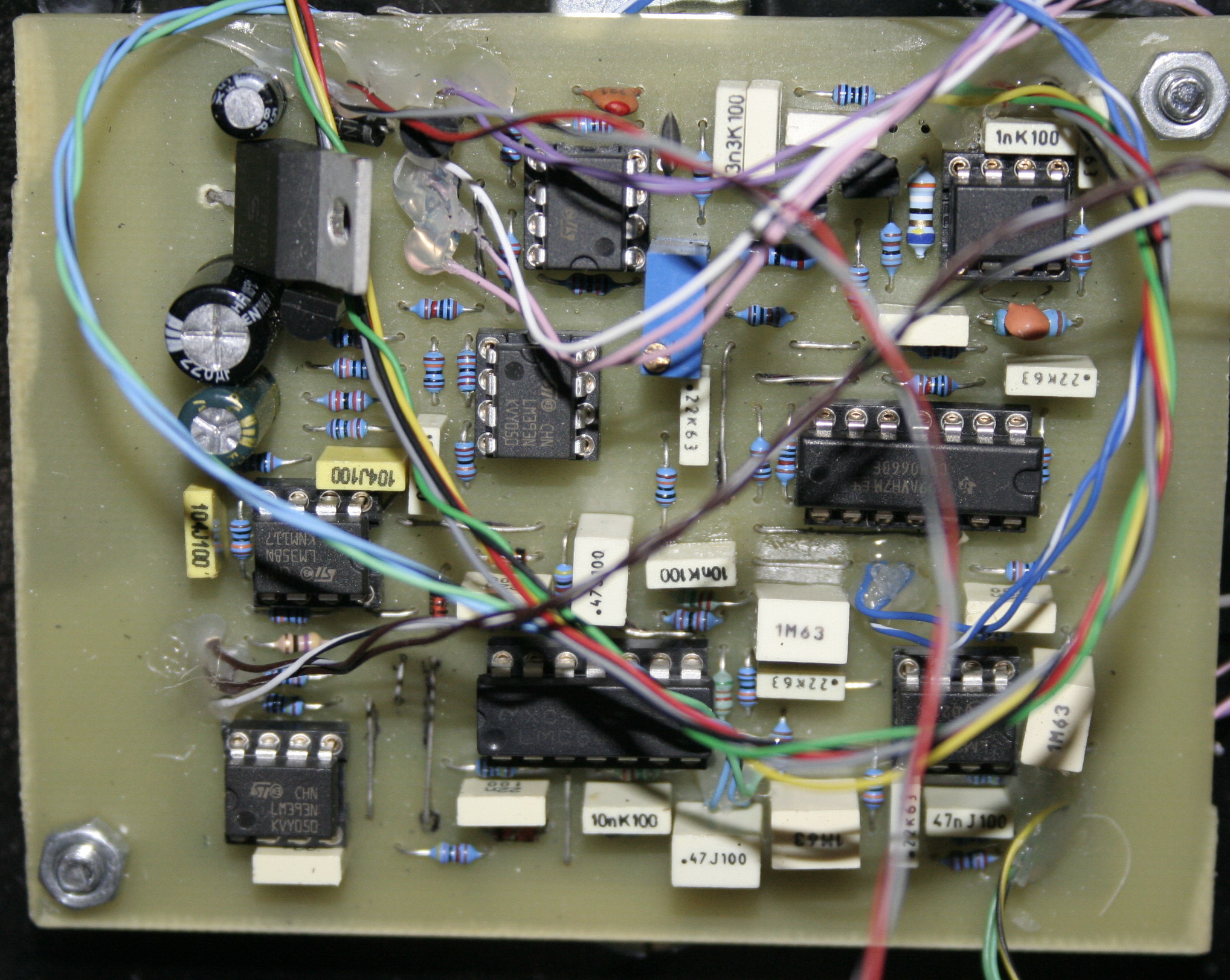

                  It's working!!!!!!!!
                  I'm wery happy!
                  I have a mistake on pcb. A short circuit took shape in the course of the etching caused the trouble! He came undone. I revise it another time the pcb, before solder the components

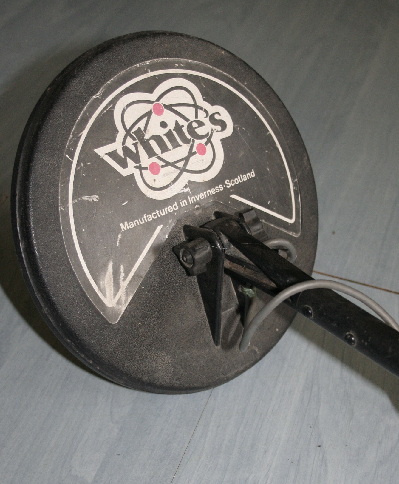

                    I finally tried the IDX-PRO with the DD coil 27cm and is really incredible. 1€ coin to 60cm in the air.
                    Im curious to see what this is in the ground.
                    Has anybody done this?
                    Steve

                      I think.. it's unlikely that even half of that is usable. My experience is that is becomes unstable mechanically at higher sensitivity settings.. even with a stock White's coil. Plus, the ground will surely be a limiting factor. I will say this though - with careful tuning , the depth is right up there with my Nautilus!
                      Another observation - the IDX hits harder on high conductors as compared to say, the TGSL at 14.5kHz.

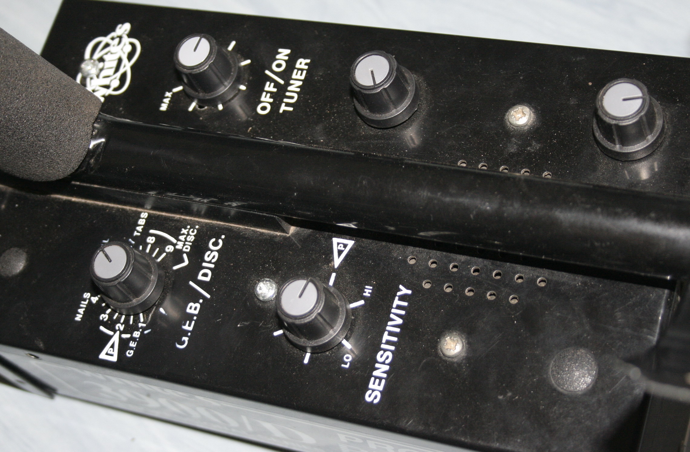

                      • Undergrund 30-35cm, in normal field. Highly mineralized ground, the depth down to about 25cm.

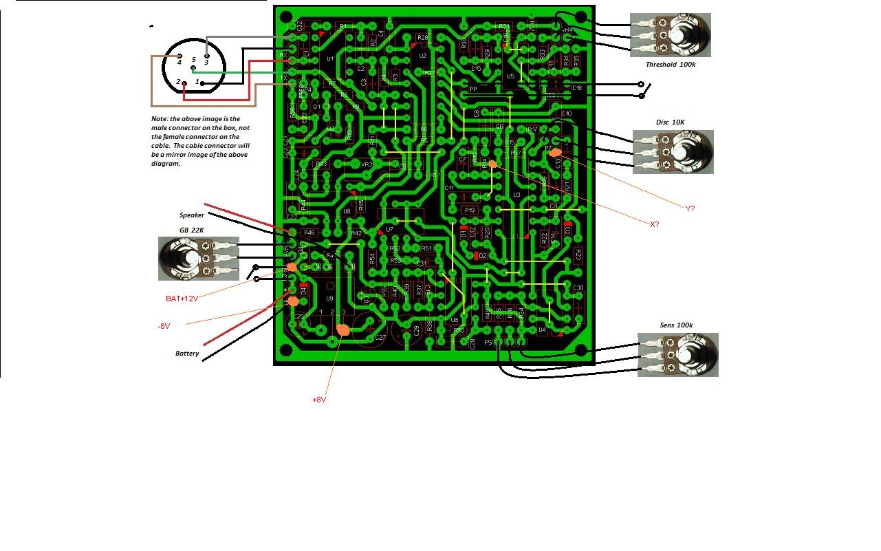

                        • Im going to try the IDX and make a 27DD for it.
                          Let me see if I can get this one going.
                          Are all the pots lined up so you know which way to wire them.
                          I have about 5 questions I dont know the answer to!!
                          Steve
