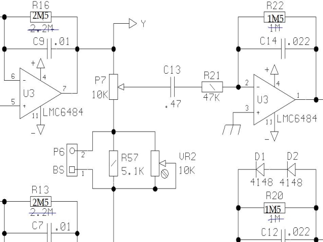

      I tried to increase resistances in filters of Geb and Disc channel:
      I think I get 1.5-2cm extra, and now is more sensitive to small object, everything works ok, he is stable as before.

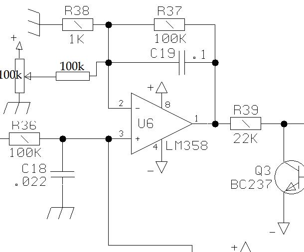

        • My friend who build idx too, has made one more interesting mod. He moves threshold from U5 to U6, like in tesoro schematics. He said that now threshold works better-better for eliminating chattering with no cutting volume in the same time... Something like this:
          He also had a switch to cut off PP channel while using dscr. as You did. What do You think about this?
          • This pot on mine I use as a volume control really.
            In the drawing of your friends work Id imagine the pot will have less range or effect as it eliminated the dc gain of U5.

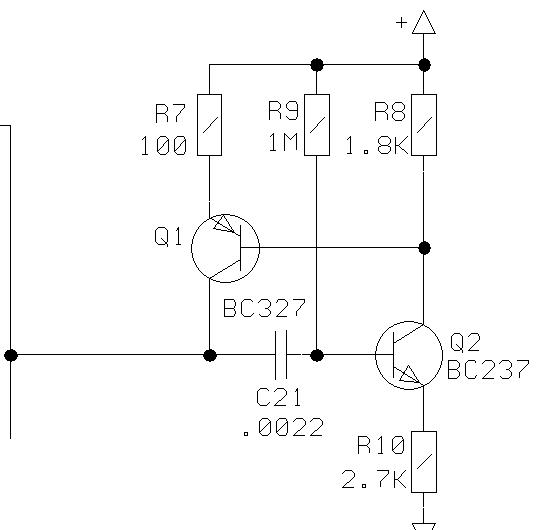

              • Hi Guys,
                I just finished my IDX and it works but for now the detection depth is poor - about 20-25 cm for 1 euro coin.
                The discrimination is good.
                I have several questions:
                1. Is it possible to achieve this working parameters with TX amplitude 1.2-1.5 V? I measured it with a brand new digital oscilloscope.
                2. If I have 1.2V instead 16V amplitude, where I should search the problem?
                3. Where I should measure the frequency of the RX?
                Thank you in advance!
                • You have 1.2-1.5Vpp at Tx or 1.2-1.5V AC ?
                  If You have smaller voltage at Tx, try to focus on this part of circut (generator) :
                  To see what resonat frequency your Rx coil has, You should build simple generator like Collpits for example, it was write about it few pages earlier in this thread.

                    • Originally posted by reiv View Post
                      [ATTACH]25545[/ATTACH]
                      Hi reiv and thanks for the answer! It is 1.2-1.5Vpp. What is the correct value?
                      • About x10 more Check your generator/voltage supply.
                        • Check your scope probe, is it a x10 !
                          S
                            Of course - a stupid amateur mistake Now it is 15 V with the new TX coil 1 ohm. It seems that the resistance of the TX is very important for the TX voltage.
                            • And what was wrong, scope probe ?
                                Yes! By an mistake I quoted your post, but thanks to both of you. I was sure there is something stupid like this, because with 1,2 volts on the TX I would not have a working detector.
