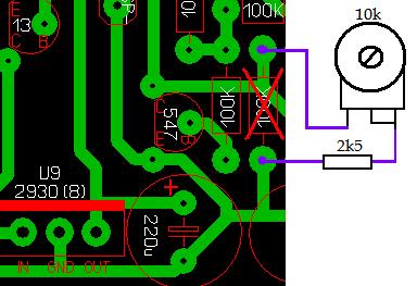

        Nice working volume control to IDX: :good
        reiv I can prove it 2k2 resistance
        • Sure this resistance it`s not critical, just helps to get more linear control of volume. With 2k5 you will get start to hear beeping on "1.5" position of potentiometr (with 1-10 scale) and full of volume at "10". Experiment with this resistance and You will see what is all about
          • anyone know if the coil of a bounty hunter detector, may be used for this detector?
            • Originally posted by reiv View Post
              reiv
              speaker is not worth 0.5 w. 8 omh. volume goes well

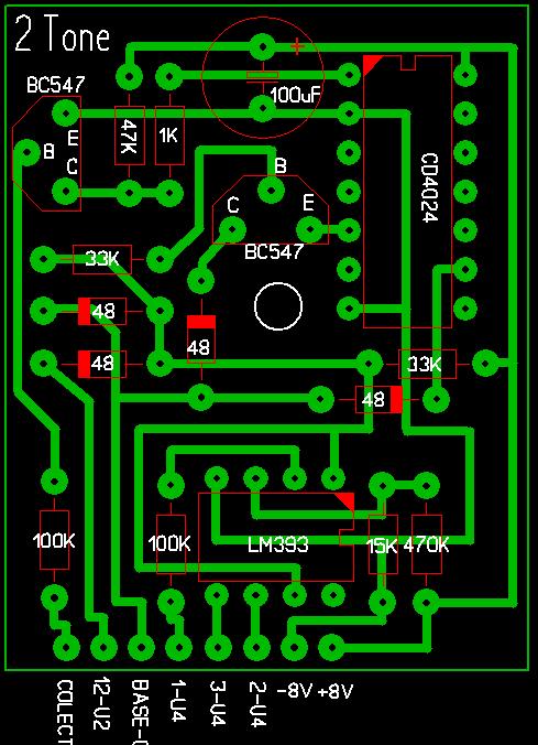

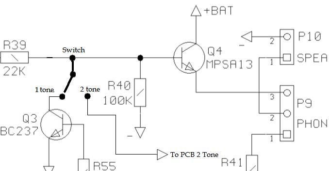

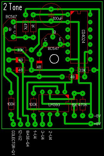

              • I have made a little mod of PCB 2tones: smaller(3.5x4.5cm),all connection at one side, center mounting and no wire connector . I know about wett grass problem but i want to connect it by switch like in "schematic" below, soe at wett grass or any hard land i will use 1tone.
                Cheers
                • Sorry.. I can`t edit previous post, this is correct

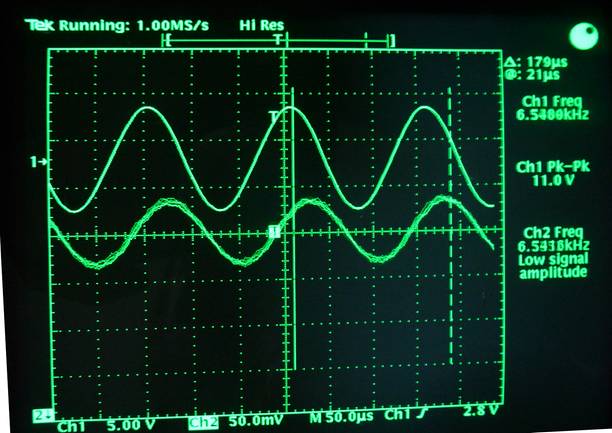

                  • i'am testing idx with scope rx and tx seems its working but no audio at all i have check also 400hz still there
                    till base of bc547 but at his collecctor conected to base of mpsa13 no signal.
                    this what i get ch1 tx coil input and ch2 pin 6 of U1:
                    i have try to follow the signal at pin13 of CD4066 i have clear square wave but pin 1 and 2 almost no signal or very small wave.
                    what i have to test?
                    thanks
                    • hello, U effective Rx seems too high. you should have about 4 mV ac with a multimeter.
                      • Originally posted by ashefr10 View Post
                        Hi Nico
                        u are right too much high rx i get some sound putting something metal in the center of coil , coilis BLUE MAX DEEPSCAN 950 P/N624-0265
                        isnt ok for idx? or i missed some mods?
