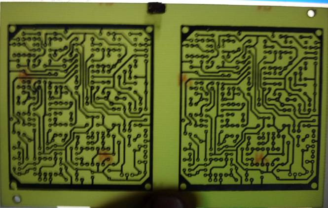

                      Just finish to etch idx pcb ..made 2 boards ..i have printed from WhitesIDX.lay file it was the correct version? i seen some differences with
                      silverdog schematic.

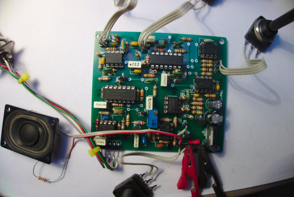

                      • I just finished building the IDX-PRO using the PCB from silverdog's shop. I discovered 2 small bugs on the silkscreen. There are 2 BC547's drawn on the component side which replace the BC237 in the original schematic. Q2, part of the oscillator has E and C swapped but the transistor housing is correct. Q3, just before the last audio stage has the correct E, B and C but the housing has been rotated 180 degrees.
                        Here's my finished build. Next I plan to start on the VDI.
                        • By the way, anyone know how to adjust VR3 (phase)?
                          • Post #178, by the way those type of cappacitors it is not good choice, better will be MKT type.
                            • Thanks, will give it a try. The MKT I have are 7.5 mm pitch and the board needs 5 mm. Guess I will need to drill some extra holes.
                              • IDX PCB is max minimalize, soe in some places I think there will be no space to put 7.5mm caps even You drill another holes, maybe simplest way is to buy 5mm they are not soe expensive.
