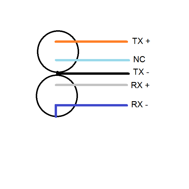

                              • My homemades show lots of noise. One has center tapped RX and no shield, the other
                                Has metal screening as a shield. My original Tesoro brown coil works great and is wired like this;
Name:	Tesoro Wiring.png
                                The 2 shields are connected and used as the TX minus. RX minus is tied to shield in the coil housing.
                                Some say this isn't the best configuration.

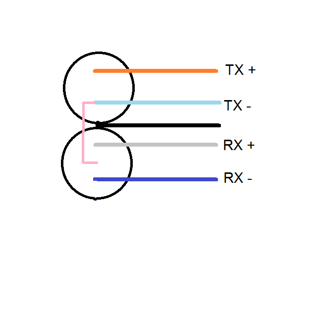

                                My Deep Search is a bit different. The RX is center tapped (center point goes to TX minus) and the
                                shield is totally separate.
Name:	Tesoro DS Wiring.png
                                I have tried different wiring schemes too on my homemades and haven't gotten satisfactory results jet.
