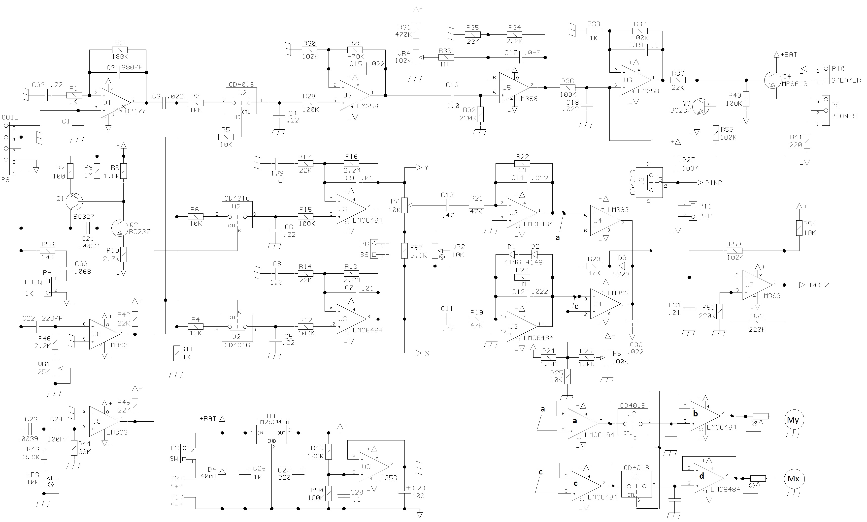

        I have some acreage of land to do.
        Ive been tuning up my IDX and its ok.
        Had a go on the land last night and the soil is red, (lots of natural iron - local Iron stone quarrying) So a challenge.
        If that wasnt enough - the land in littered with iron slag from a local foundry.
        Plus the usual uk farm iron mess plough blades, cast iron plaques, WWII bomb fragments in one area.
        Its fair to say its a challenge.
        My IDX seems to be able to geb reasonably on a rare clear patch. Then you notice the sensitivity go up.
        In this state - normal use - with the disc set to not beep on small iron - - - During one sweep you can get slammed with iron three times and the recovery time in large iron is woeful on the IDX in these conditions.
        Is there a few known fiddles to alleviate this.
        I was thinking that if we have stages saturating hard against the supply rails - a minor improvement may be to have higher rails? 7.5v rather than 4v?
        I run with the PP ch sen at min so Im using the GEB DISC ch's only.
        Yes you can crank the PPP ch sens up but it doesnt disc - useles for me.

        • You can check my non-saturating solution for IGSL. IDX and IGSL share many details in gain stages. If you are interested, I'll send you my LTspice simulation of IGSL gain stages with discrimination, so you can adapt it for IGSL.
          My IGSL mods were mostly with strong signal handling capability on my mind.

              • analog vdi
                I need an easy, low cost VDI -- I need it fast as the land I have is about to be seeded.
                I want to do it with kit I have laying around. The image is what I want to try.
                Any sillies on here which render it useless. The idea is - at the moment you hear a tone - use the comparator output to sample the X and Y channels and sample and hold them..
                • here
                  it is
                  • Wrong spot, try sampling the x and y spots instead. Points a and c are prone to saturation, hence you'll not see the real thing.
