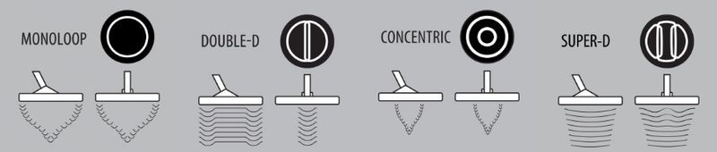

  • I googled a bit, and there is just not enough data for omega coils...
    For now i will make DD, afterwards may try super D or as some call them DOD.
    Did anyone tried DOD on IDX, how does it performs?
    Should be better than DD?

    • I built a few coil for the IDX Including 10" and 12" DD.
      By far the most used coil was a 8" concentric in the fields near me. 12" DD out preformed it on a coin in my lawn. However when searching in fields you would have to turn the discrimination up and you lose all sensitivity to small thin items on edge
      Never got round to building a 10" concentric. Fairly sure that would have made my other coils redundant.
      if I was going to build a coil which I was sure to work 100% then I would follow this https://www.geotech1.com/forums/show...idx+concentric
      of cause in your fields things might be different. For example dry sand without much iron the 12" DD would have been my choice just because of the better coverage

        • Thanks for the tip about concentric, but i got quite nice setup for winding 27 cm DD, so for now i will make this one.
          Latter may try with DOD or concentric.
          Which wire for rx of DD 27 cm is better: 0,15 ; 0,16 or 0,18?
          Have them all three laying around.
